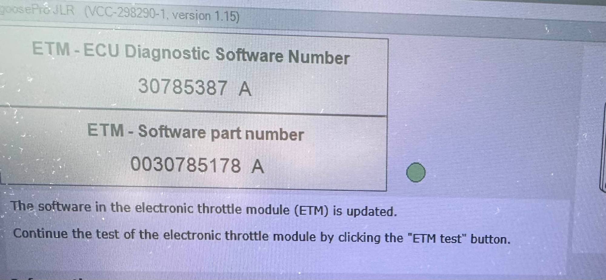

After confirming software compatibility and viewing VC7200 counters, I felt confident that that softwares are compatible and performed an ECM reset. (3minute interval procedure)
At the end of said procedure, I was asked if the ECM-4038 error was still noticeable. Since I was not sure, I closed the window (x)
After the reset, the system requested a 20s idle procedure for code reading.
I am no longer faced with error code ECM-913F, so I believed it was successful. Will have to see.
After restarting vida and requesting a fresh read, the error returned.
I'm probably going to consider cleaning and swapping back to the previous ETM if no other procedures work.

Hello,
I found the ETM test section, and it said the ETM software was up to date and compatible. I performed the ETM test and the result says the sensors max difference is 0.48 degrees. It states that the maximum varience permitted is 13 degrees.
Image 1: ETM Software part number (updated confirmation) Image 2: ETM live readings at no throttle (written below) Image 3: ETM live readings at full throttle (written below) Image 4: ECM-913F Unselected CSC drop down symptom options Image 5: ECM-913F CSC symptom specific info (idling, uneven idle, AE) Image 6: ECM-913F CSC symptom specific info (Driving, hesitates/surges, at steady speed, BV) Image 7: 720A code reference. (no issues) Image 8: ETM test results graph (maximum difference shown 0.48 degrees) Image 9: ECM-913F Potential sources I checked the ETM throttle position sensor, throttle absolute position, intake thrtottle / desired position, and accelerator pedal live data.
*Again I see that ETM-Absolute throttle position begins at 21.18% instead of 0%. *
At no throttle, the readings are:
TP Sensor1: 31.41 degrees
TP Sensor2: 31.73 degrees
Absolute Throttle pos: 21.18%
Intake throttle desired position: 10.4%
Accelerator pedal: 8.19%
at full throttle, the readings are:
TP Sensor1: 94.66 degrees
TP Sensor 2: 94.44 degrees
Absolute Throttle position: 99.94%
intake throttle desired position: 86.82%
accelerator pedal: 68.64%
