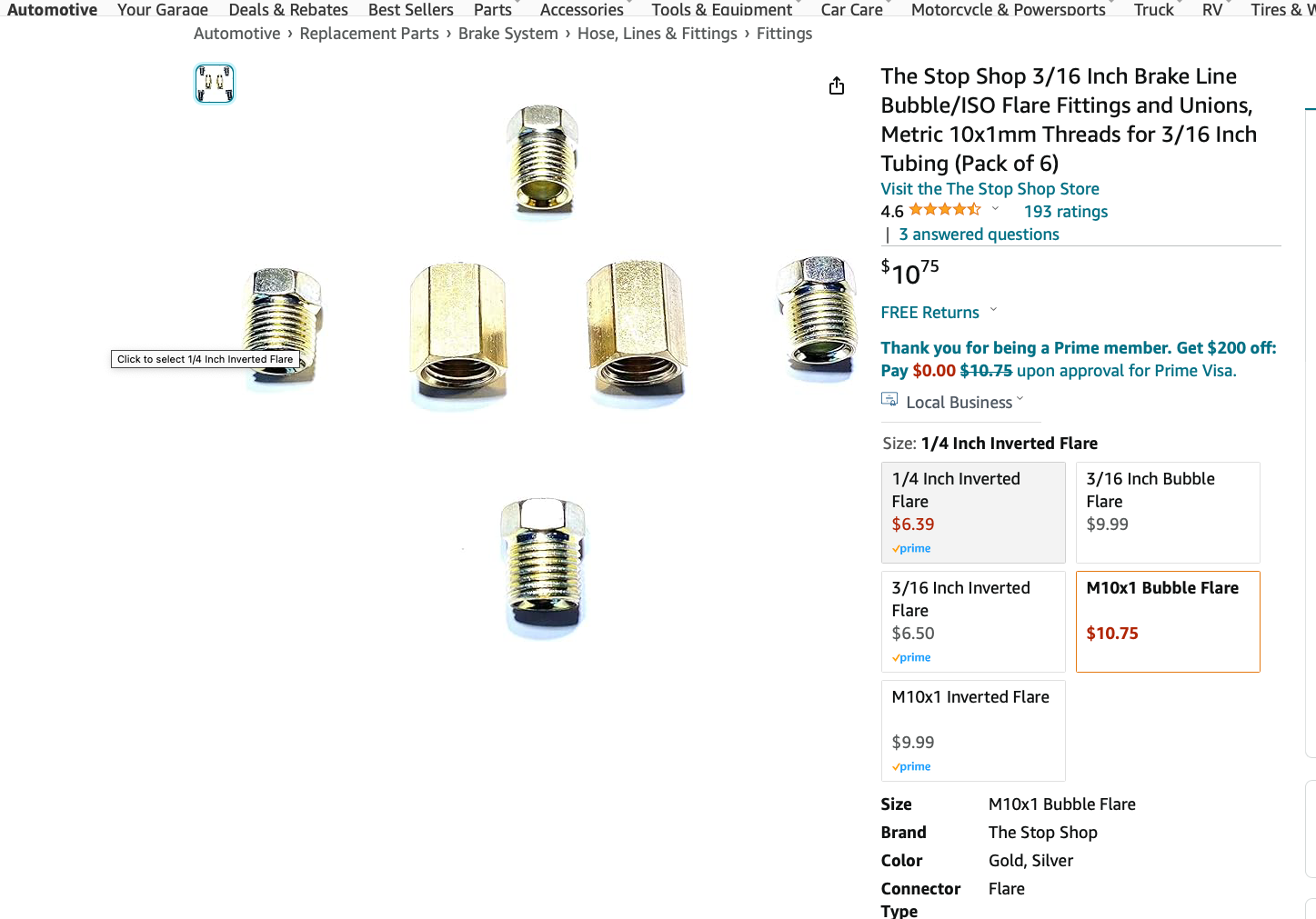

Do you think these would work on the rear caliper brake line on my 97 855 GLT?
https://www.amazon.com/Inverted-Fitting ... 6Z14L?th=1

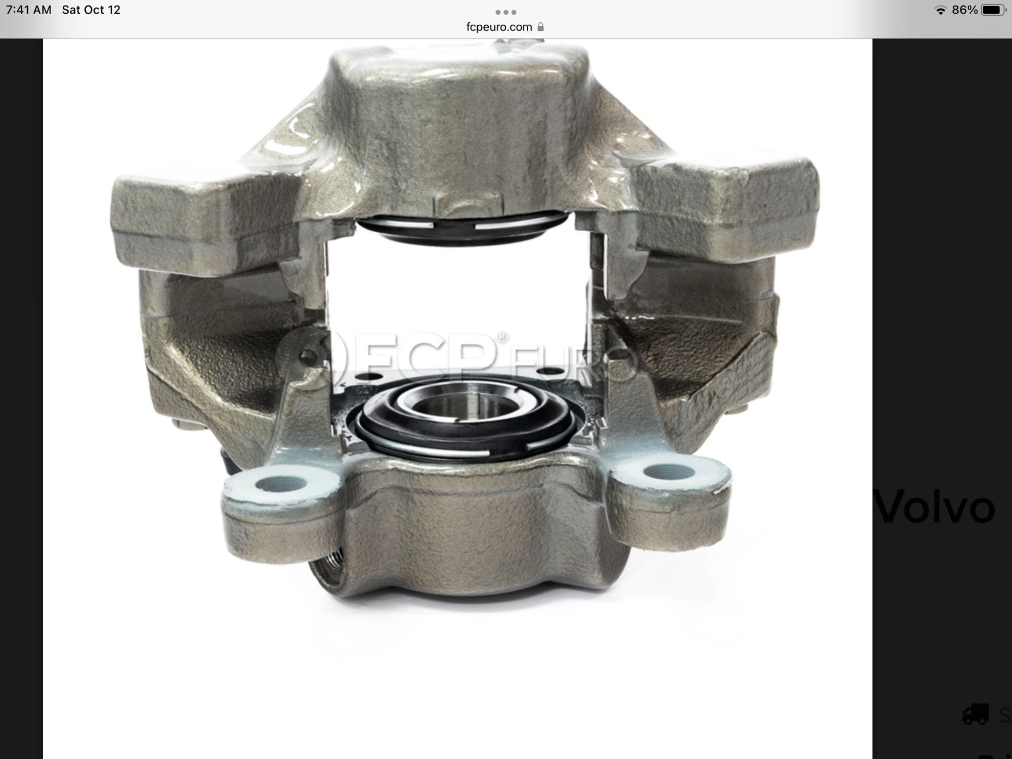

Here’s the Volvo ones, made by ATE, of course
External snap ring it is.
You download the warranty on the NAPA AS A pdf, but I think you are right, it’s a once replacememt warranty.
Since caliper off is 95% of rotor off on the rears, I don’t mind if the rotors get torched on the job. Guess who’s paying fir my rotors, too?
