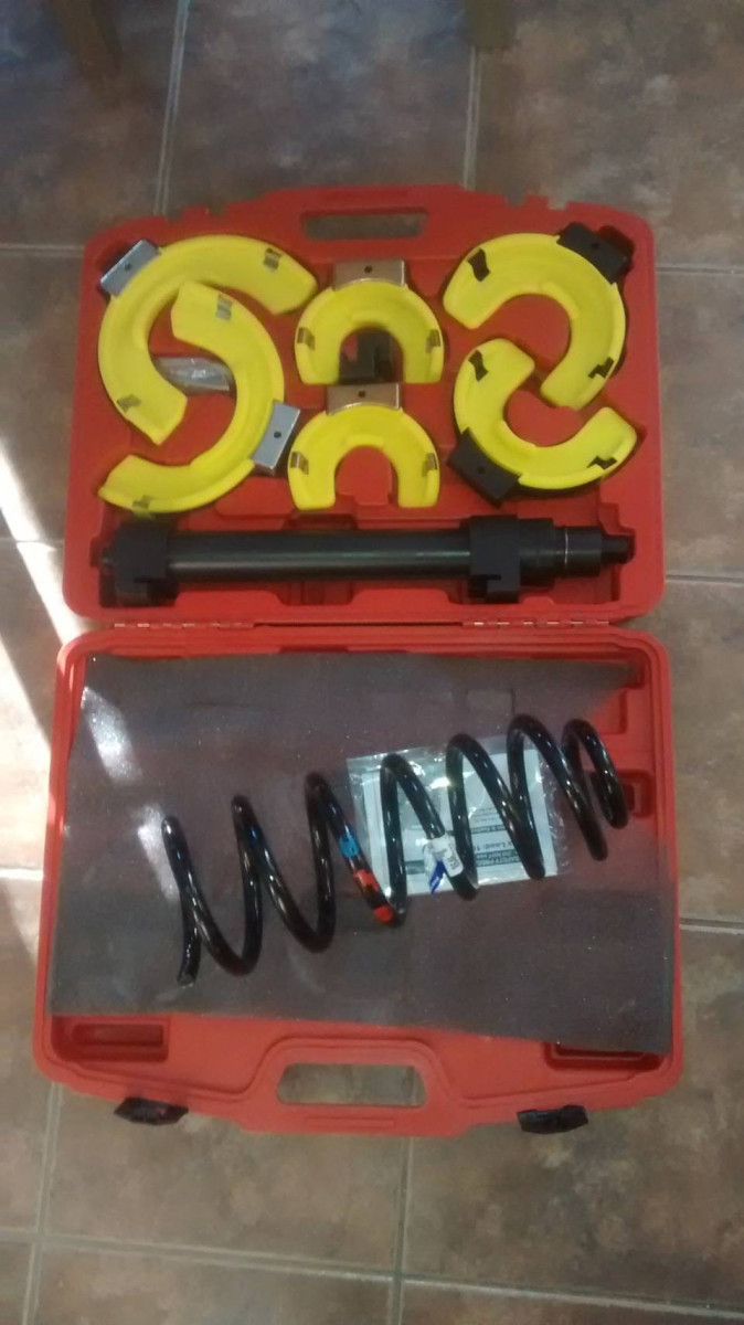

Springs are not a problem with this compressor type. Very secure. Around $100 these days.

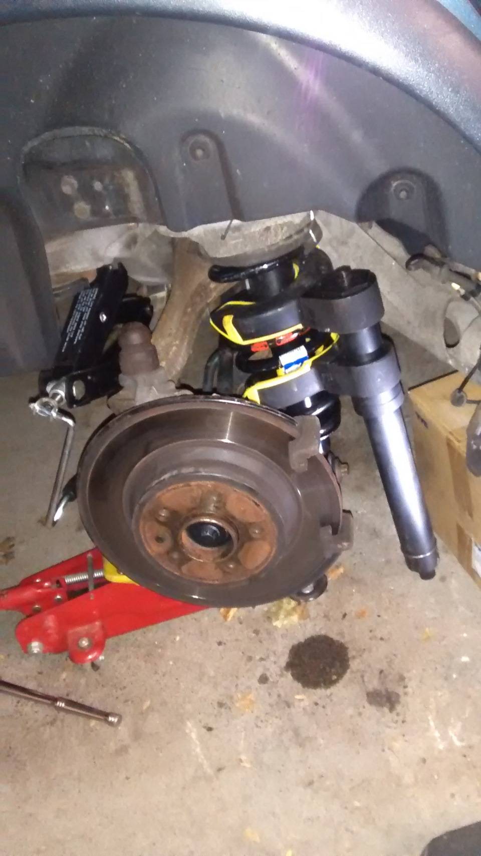

got the strut installed , test drive seems good, i might check it with string after i get my sticker.

I have 3 springs compressor tools, and the good one. The good one is the only one that does not try to kill me. It is so easy to use that I don't hesitate to take things apart just to check my next suspension suspicion. It also works on all types of springs, even HD trucks. Wish I bought it like 15 years ago.

I've never liked spring compressor tools. The version you have vtl is the way to go. But like jonesg says, I use them so infrequently it is hard to justify buying yet another bulky tool to store. My mechanic buddy bought one of Amazon that looks similar. We spent about half an hour modifying it to make it work as the parts did not fit together out the box.

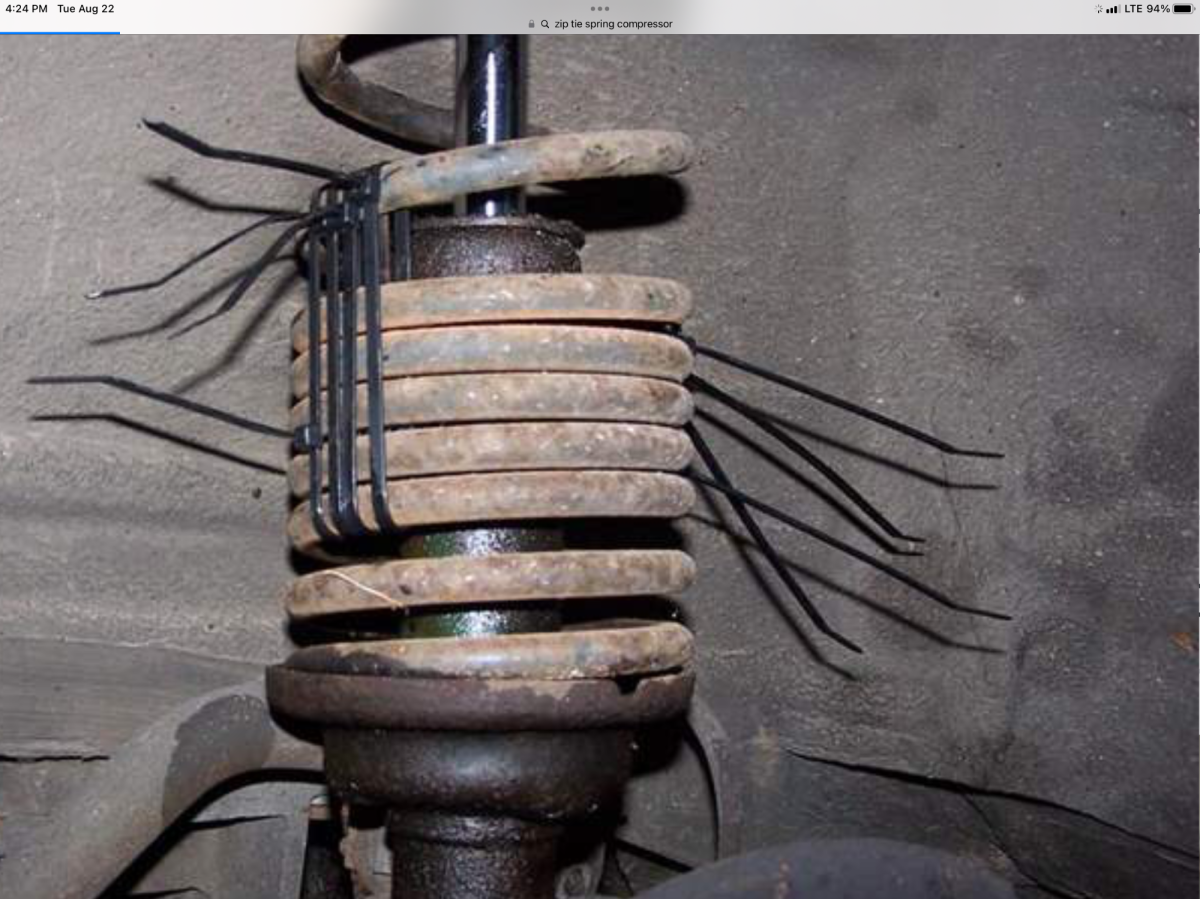

However, I felt a lot more confident using it than the 2 versions I have. I just had to do the 02 XC70 struts recently and without access to the fancy tool went back to the cheap threaded tools. Used all 4 of them as the springs are hard to compress on this car. I did use large re-useable zip-ties to circle the tools to try to prevent them slipping off the spring coils. Worked well. I'd still rather have this tool though.
