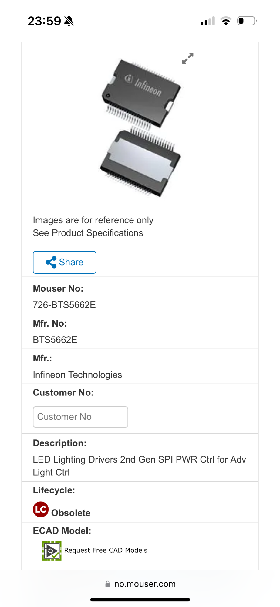

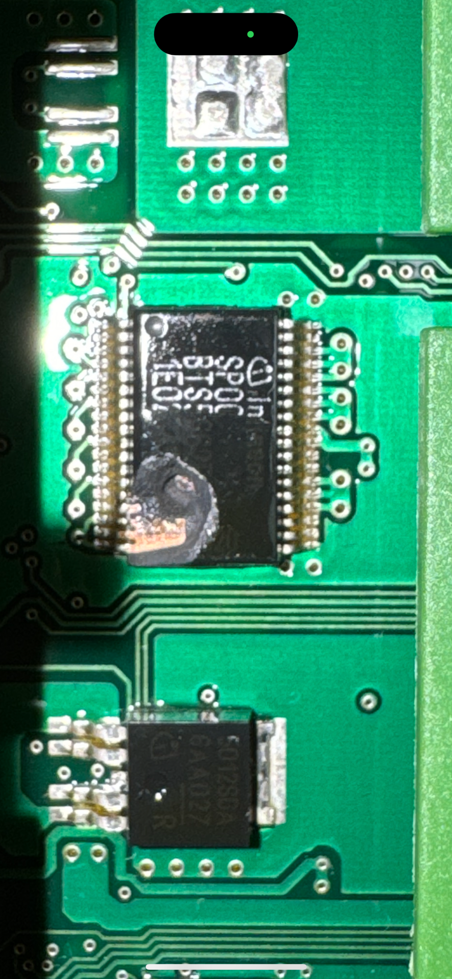

all this issues was fixed and was offcourse still struggeling with not getting my auxilary top break light working and also my break light left/right would not turn of after shuting down the car. After a lot of work i traced the failure down to a broke LED-driver at the CEM module.
Fortantly i had some spare parts and got a repair of the CEM and changed the component on the circuit board.
after the change of the component the car will not give any trail lightning and it seems like my CEM will not reconize the new LED driver mounted.
Please help and thank you for all input.
ataching pictures of the component
