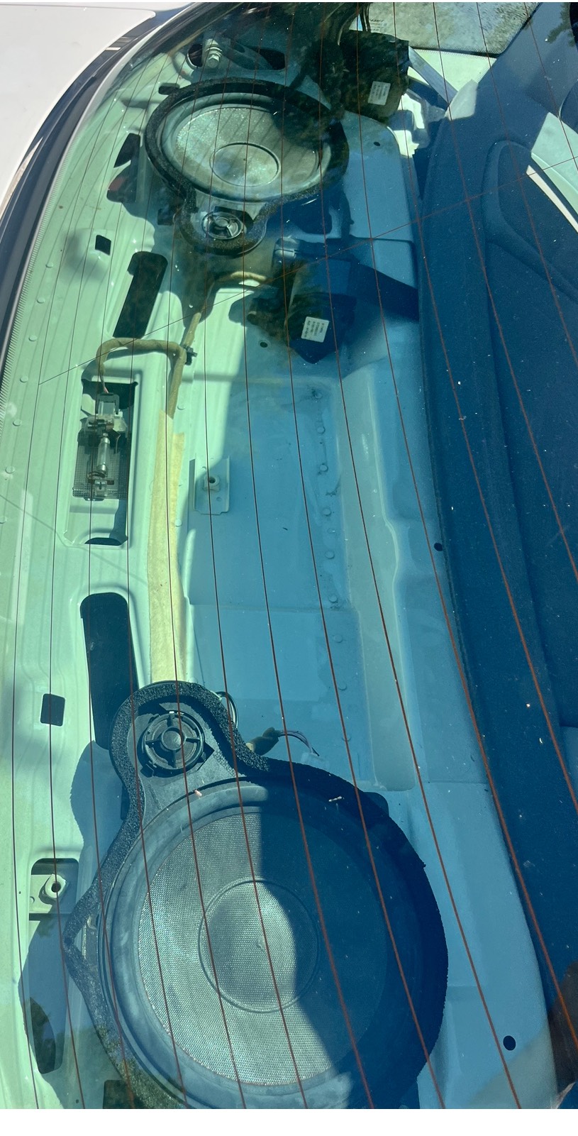

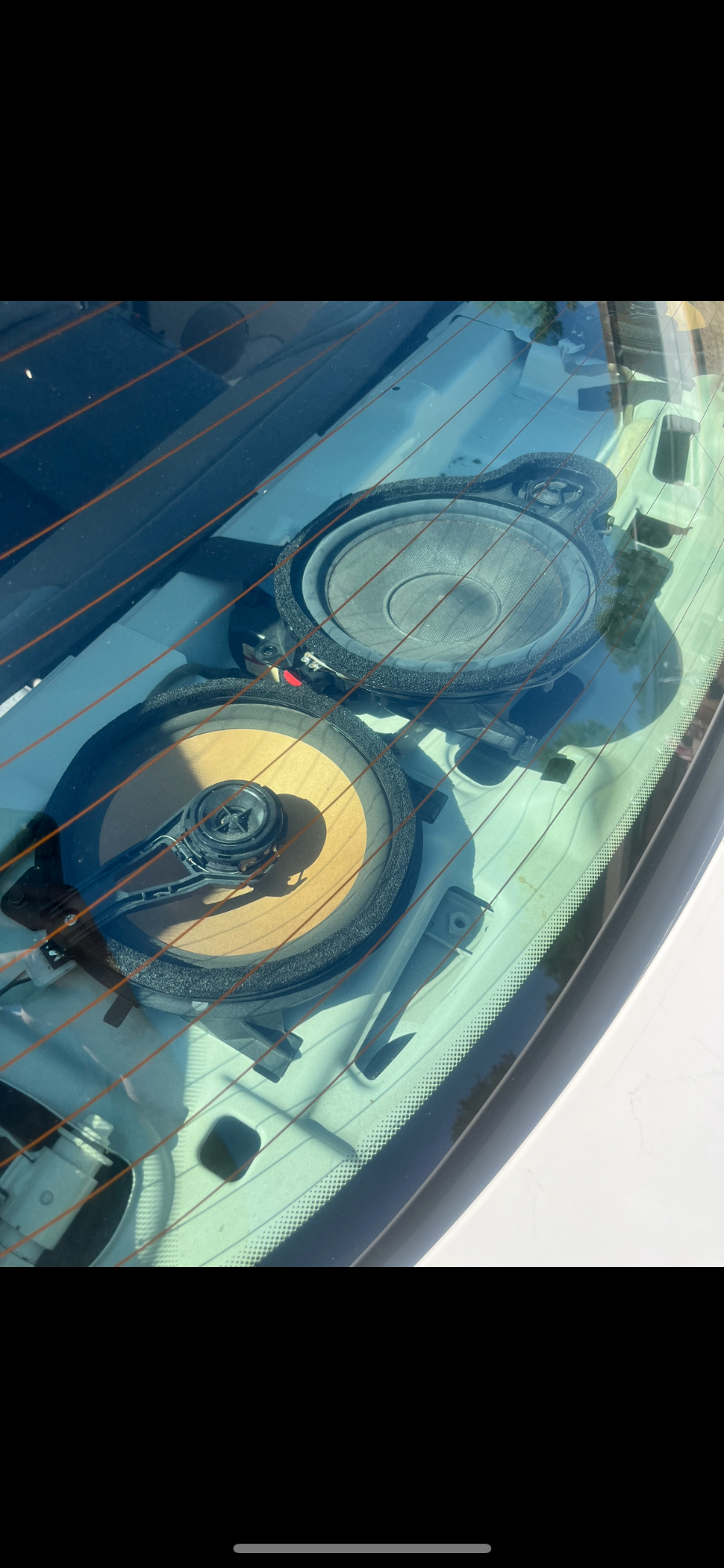

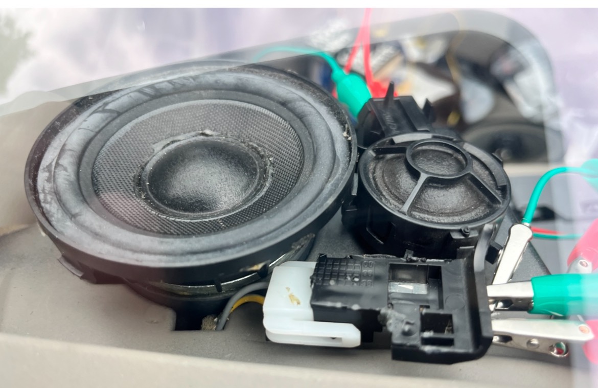

The rears pretty much bolt right up except they have an additional tweeter that gets slightly in the way when putting the rear deck back on so that needs to be modified. Or you can take the 8” out of the front from the above part numbers for the rear deck. I then took those 4”? Speakers and were able to get them into the dash holes. You can take the 1.5” tweeter and wire it in parallel as well
The rear speakers are 6” so those would work in the doors but you I had to cut out the speaker grills as the improved bass was causing some buzzing.
And then the amp is 3533798. There’s a thread or two on how to hook that up but pretty simple if you also pull the wiring harnesses with it.
