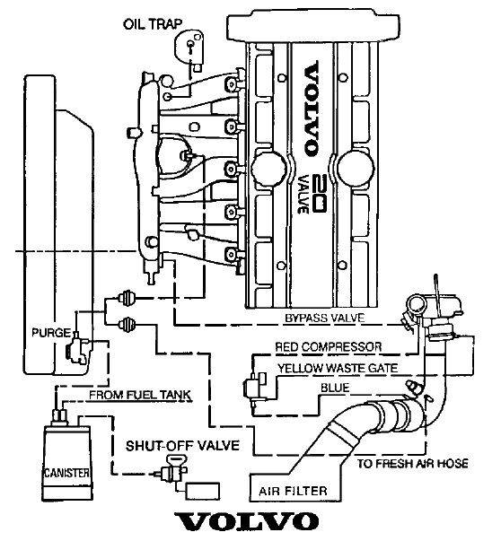

Hamburger wrote: 16 Nov 2024, 09:19 Greetings,
I checked the whole area first with smoke, then compressed air at approx. 1-1.2bar, then soap. No holes to be found.
I chased another thougt, unplugged the knock sensors just to confirm that they don't affect my enginge, no difference withought em high idling my engine.
I'm wondering if you may have an internal air leak into the intake manifold, something you may not see with a smoke test. There's the vacuum hose that goes to the turbo bypass diaphragm, the hose that goes to the evap purge valve, a large hose to brake booster and the small PCV system vacuum hose. To check you could remove the hoses and cap off the manifold connection or use pinch pliers on the hoses while doing you do the rpm testing. For the PCV hose you could just remove the oil filler cap to make sure there's not excessive pressure in the crankcase that may cause more air flow through the small PCV hose. Maybe a long shot but shouldn't be too difficult to check out.
Volvo vaccum hose diagram.jpg (56.6 KiB) Viewed 1010 times
