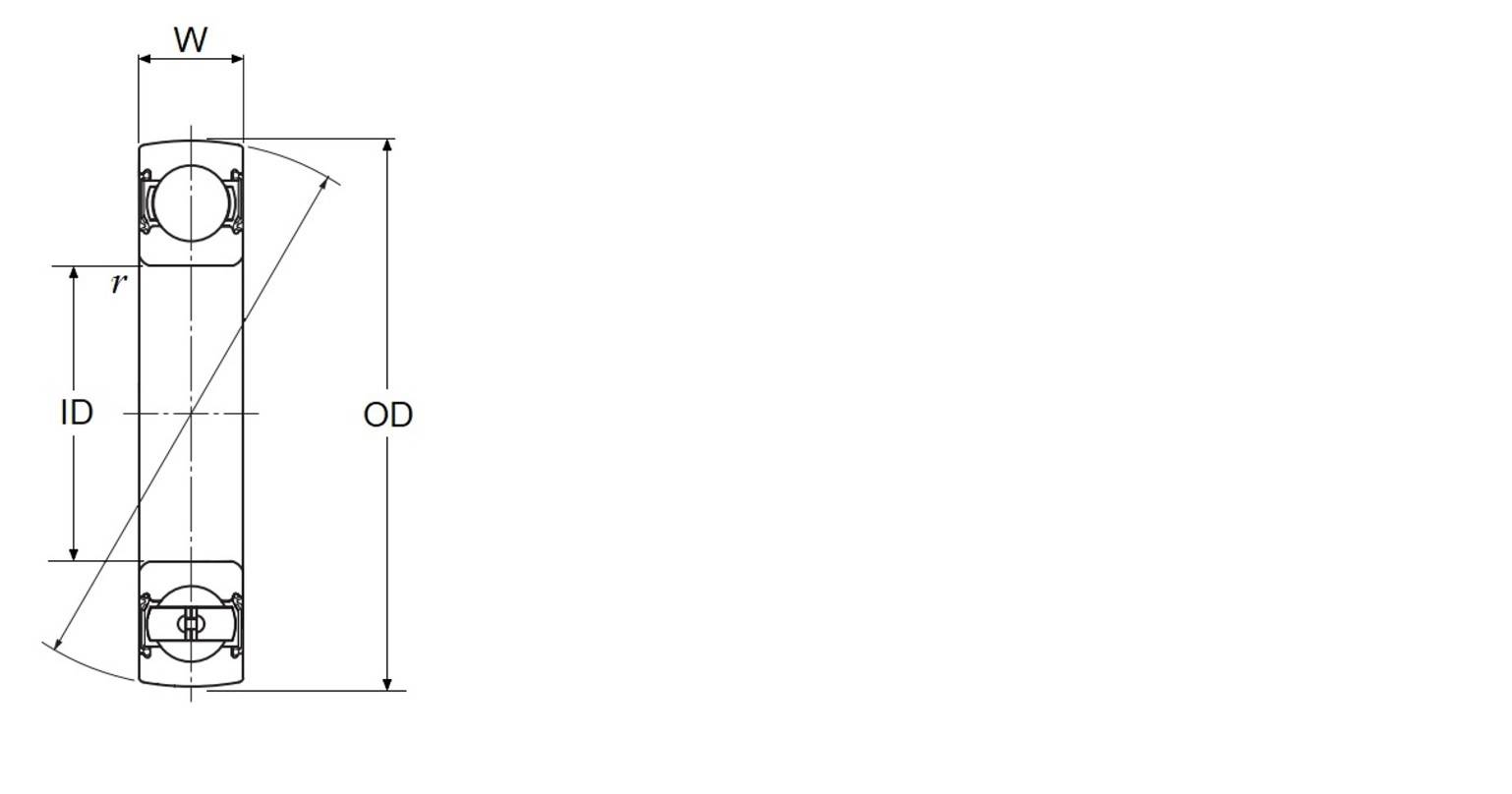

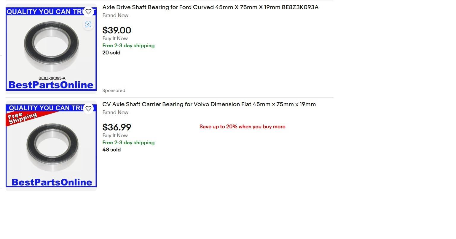

I noticed when looking at these bearings with the 45mm X 75mm X 19mm dimensions there are a couple of different types, curved OD and flat OD. On Ebay the Volvo axle bearing is a flat OD type while the Ford axle bearing with same dimension is a curved OD type, although hard to tell any difference from the photos. I only mention this because when you cross reference the bearing part numbers sometimes the curved type comes up and other times the flat type comes up, based on the photos. I have an old Volvo P2 passenger side axle and it looks like the axle bearing has a flat OD. I don't know if you can use either type but thought I mention the difference.
curved outer race OD shown here

I bought a couple of the Ford versions out of Turkey many years ago for around $10 US with free shipping. I see bearings in the UK for around that price too today.
Anyway, the Ford ones I got did not show they had a curve to them. I did check them that the most important thing was the bearing holder flange has a lip that is high enough the side of the bearing is still held in. There is one running on a V70 I had that has maybe 30-35,000 miles on it since installing and so far running well. I have also fitted the other to my spare V70R axle.
