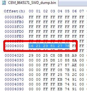

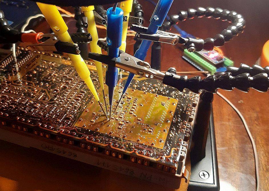

I can confirm that T5Luke's method works. Tested with Arduino Uno and Nano. Both read CEM flash without errors. Because CEM cracker still doesn't crack Brick CEMs so...
I tried it on three brick shape CEMs:
1- CEM 8645171 - 2000MY 07week
2- CEM 8645171 - 2000MY 11week
3- CEM 8688434 - 2002MY 36week
I used 12v from power supply. 12V connected to CEM pins as showed at picture and as an external power to Arduino. Ground from CEM and Arduino connected together.

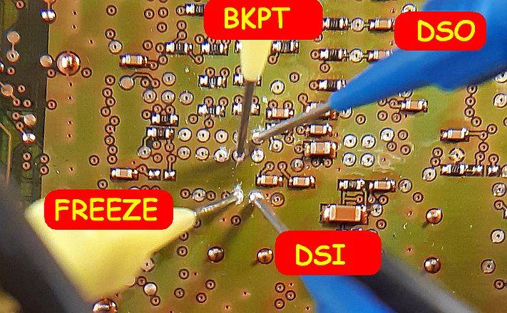

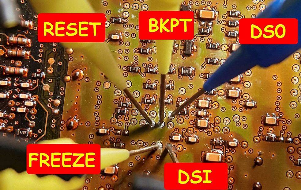

In cases 1 and 2 You have to connect 5 wires. I used a sharp probing needles and scratched delicately connecting points on CEM's pcb
The whole readout takes 6 minutes. After this You can copy the entire readout and using for example HxD program create a new file with .bin extension and paste this readout.
Both CEMs 1 & 2 have PIN at 0x4000 therefore if You are going to use CEMTool , You have to copy this PIN and for CEMTool needs
paste it at 0x6000, otherwise CEMTool will show wrong PIN, because program search PIN at 0x6000.
In case 3 You have to connect only 4 wires (without RESET), otherwise the flash memory won't be read. Maybe it is only at that CEM, but it was read this way.
In this CEM (2002MY 36week) PIN is placed at 0x6000 so there is no need to changing anything

V70user wrote: 20 Nov 2024, 08:59 Both CEMs 1 & 2 have PIN at 0x4000
In my CEM at 0x4000 I have FFFFFFFFFFFF, so I need to copy that in 0x6000?

wxp73 wrote: 20 Nov 2024, 14:06
Brick CEM has pin either at offset 0x4000 or 0x6000. Yours is at 0x6000. Don't forget your dump can be byte swapped or not, depending on how your read it. Plus regular shuffle.
