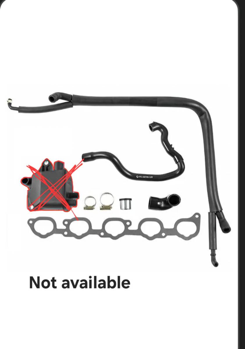

So to troubleshoot the idle problem, can I test the car without the MAF sensor temporarily to see if it resolves the rough idling issue? I’ll also inspect for vacuum leaks and clean the Idle Air Control (IAC) valve as part of the process.
Regarding the PCV system, I currently only have these parts available for replacement (check attached). I’ll provide an update once I’ve had a chance to work on it, which will hopefully be this weekend.
Unfortunately, the car has already lost about 2 liters of oil, so I’ve kept the dipstick slightly out to help relieve the pressure temporarily. Hopefully, this prevents further issues until I can replace the PCV.
Thank you again for all the helpful advice—I’ll let you know how things go after I’ve made these changes!
