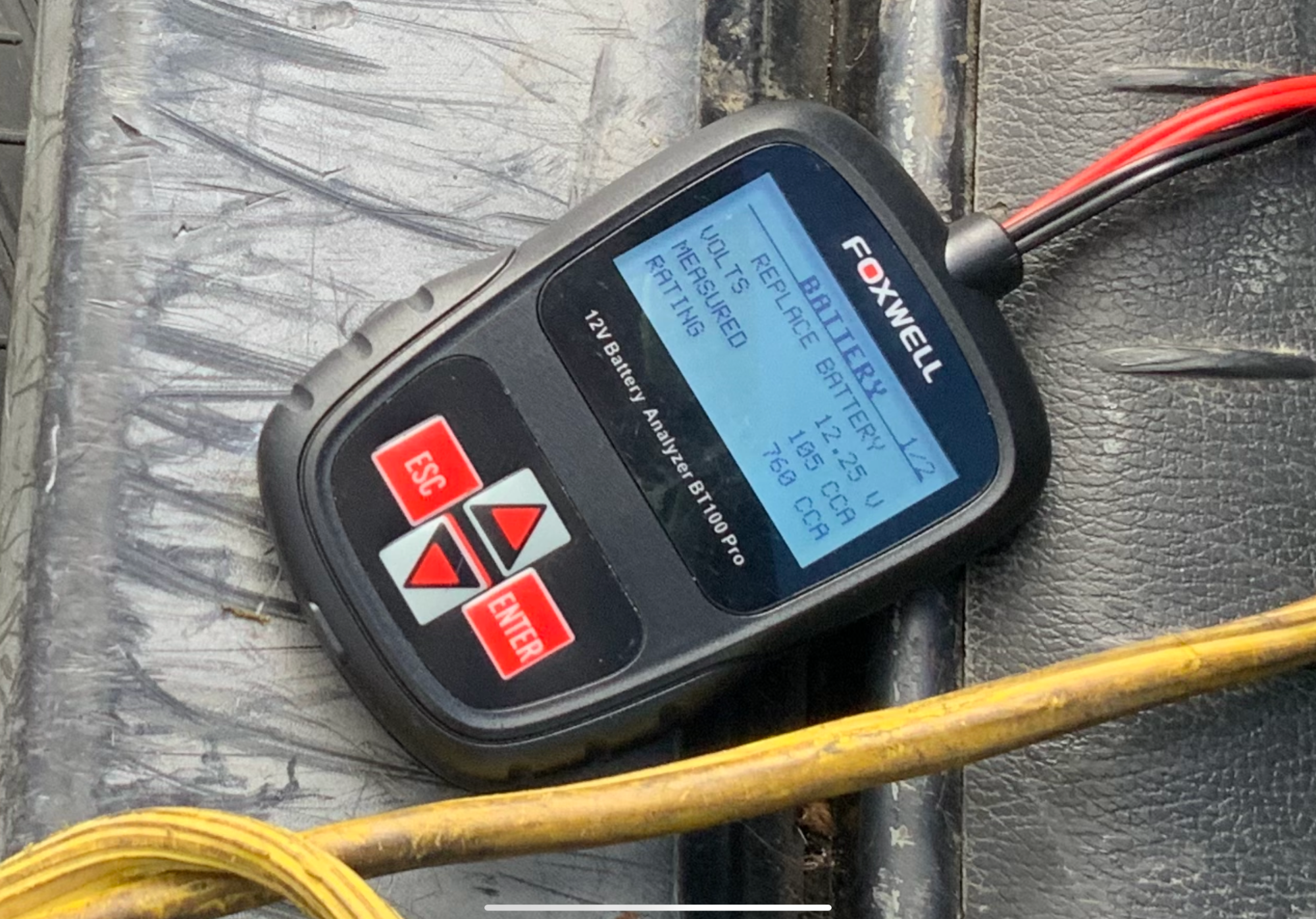

AutoZone tested and charged the battery. Said it’s good.
I took it home and connected it with battery cables. Nothing. I connected my battery tester and the pics are attached.
The setup… Readings while connected… Readings disconnected from car… I also connected a load tester which read over 800 CCA after a 10 second load test, and measured 12.5 volts and holding steady after removing the load. If anyone who knows where the possible fuse might be located, please say. Do I need to remove the floor panels behind the back seats to get to it? I’d greatly appreciate feedback regarding what I might check next. Tks.

No comments on my last post, eh!
The 2.5 year old AGM battery reads good/recharge when not connected to anything. But if I connect something , like either the car or jumper cables and take a reading from the other ends , it reads “replace battery”.
Does anyone know if this is normal?

As for the odd readings from the Foxwell battery analyzer (oddly, also called “BT100”) in the photos above, it seems that the device only reads the battery properly when connected directly to the battery, because it reads “replace battery” (even with a brand new battery) when connected to the +ve terminal under the hood, but who knew.

ABscate advised a voltmeter, I would go better and get an automotive meter, $35 ebay.
Read v at the battery , then read at the terminals in the engine bay, any appreciable drop , as shown on the foxwell, and I would run my own aux temporary wire to see if that clears up any problems.
I'd disconnect the battery and run resistence checks on the 12v feed from the battery to the engine bay.
