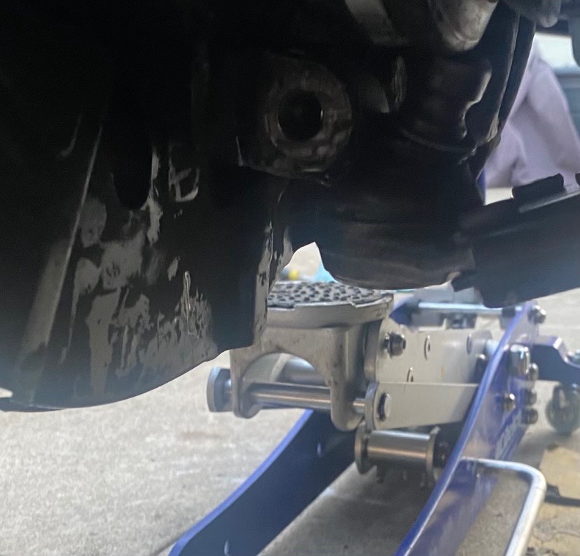

I didn’t have any success getting the ball joint in. I tried it with a couple jacks including a scissor jack and hydrologic, but kept pulling and rolling away. Closest I got it was the photo, eventually I ripped the ball joint rubber as it kept slipping. so now the control arm is broken. Taking it to my mechanic this week. Oh well, thanks for sharing this. Maybe others will have success.
- D73678E2-164F-4D24-BACB-521C3ECD3762.jpeg (127.85 KiB) Viewed 7692 times

Oh no! I’m sorry to hear that happened. It may be too late, at least for this side, but for future reference or the other side, the ball joint should be pretty easy to get in because once you flip the strut back over the control arm to the correct position, all you need to do is pry down the control arm a bit and allow the wheel assembly to rest right so that the socket is right over over the ball joint, then release. The ball joint will enter partially, and you only need to use the jack to get it fully in. I can’t quite tell from the picture, but it from the description it sound to me like the control arm and wheel assembly where not correctly aligned before trying to insert the ball joint. Prying down the control arm with a lever (can use anything, like a long breaker bar or lever) gives you the flexibility to align things. The prying lever should apply force to the thick metal part of the control arm (not at the ball joint). Can get a helper to hold the lever but I didn’t find that was needed.
