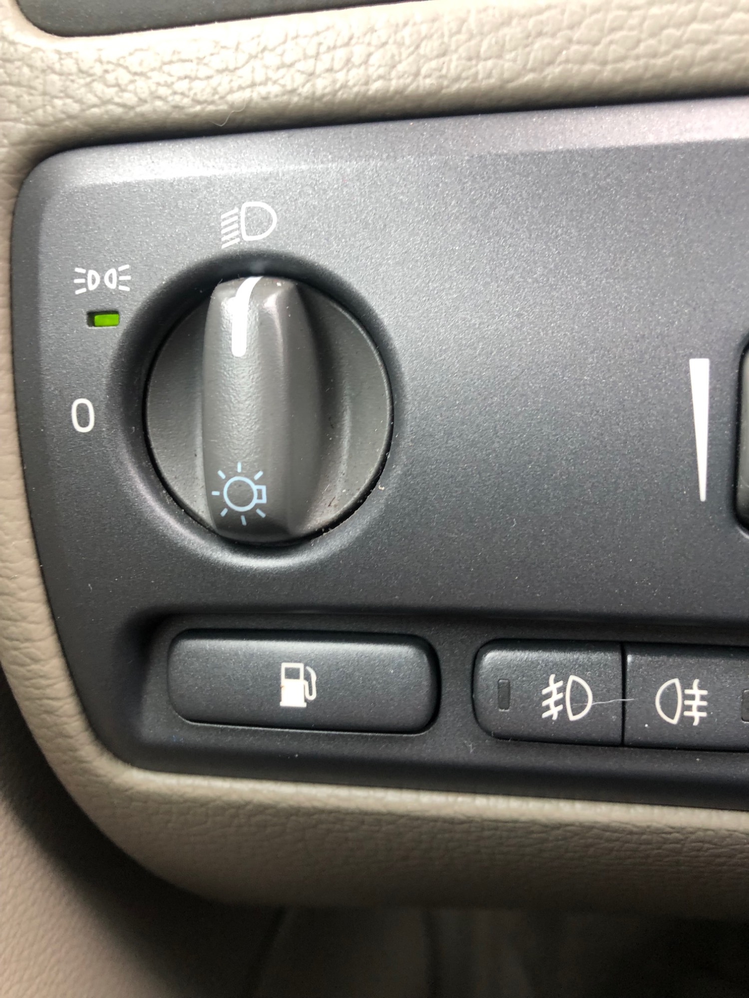

We have had this 2004 XC70 for about a year now (purchased as salvage title and we have been getting it back in shape. My wife loves this car!). Recently the hi beam switch on the column won't stay on hi. If you pull the switch back the hi beams will come on but it won't stay in that position. I have been looking for a replacement switch but no luck so far. Does anyone have a source for this part?

The hi beam staying on is a function of the headlight switch position. If it’s not in the most clockwise position it will only flash the high beams.
