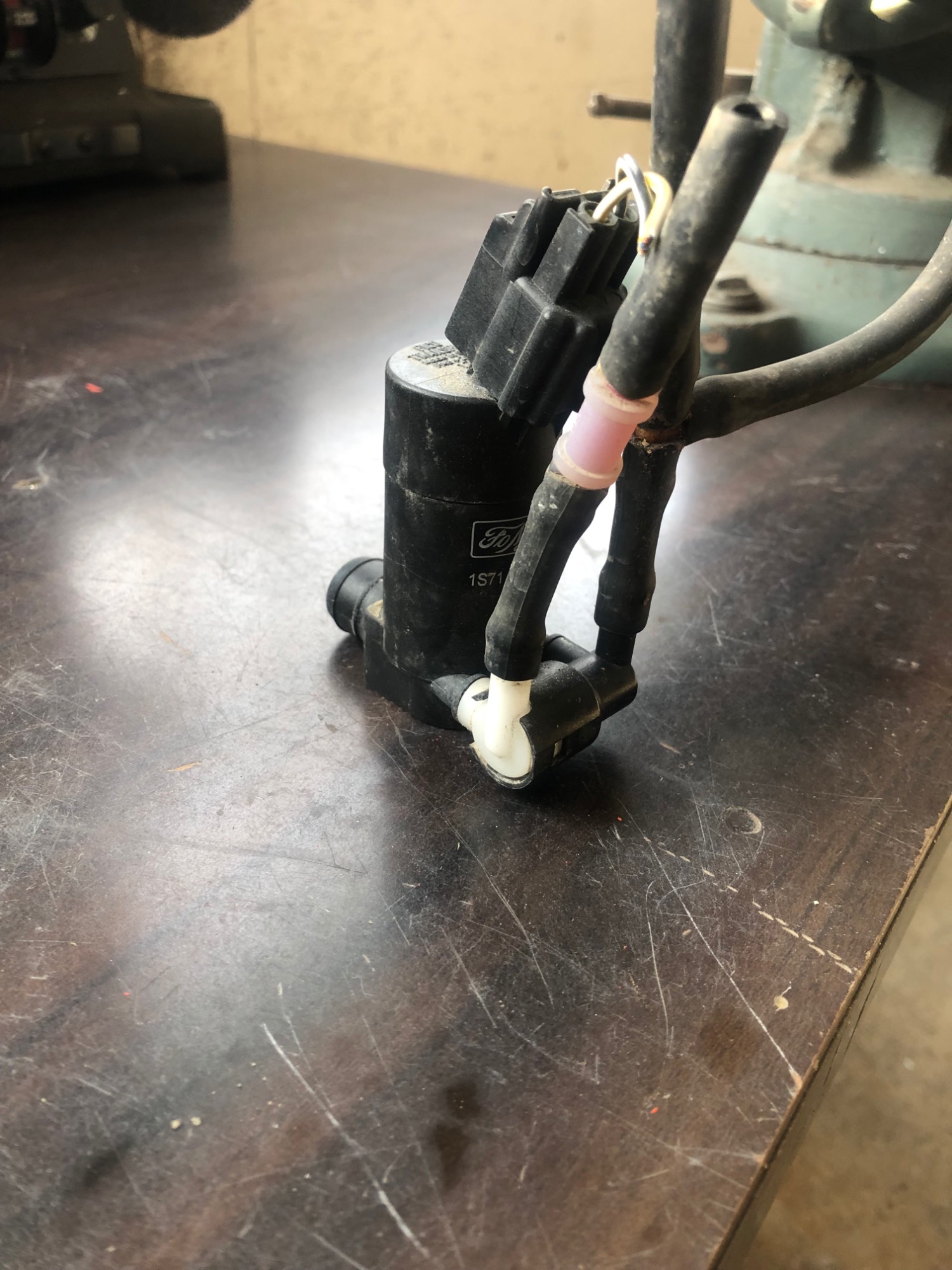

Finally got around to replacing the broken washer pump. Spraying was functional, but noticed that it was spewing water out of the bumper area next to the reservoir. Saw that there was a tear in the rubber tube in a reachable location. Bought a washer line repair kit from Amazon for 6 bucks: https://a.co/d/iz0Hmpj
Cut the torn piece and put an I adapter to a new piece of rubber. While I was at it, I replaced the first T connector from the pump with an I connector, and removed the headlight washers out of the system. Those wipers stopped working anyway and now less wasted fluid!

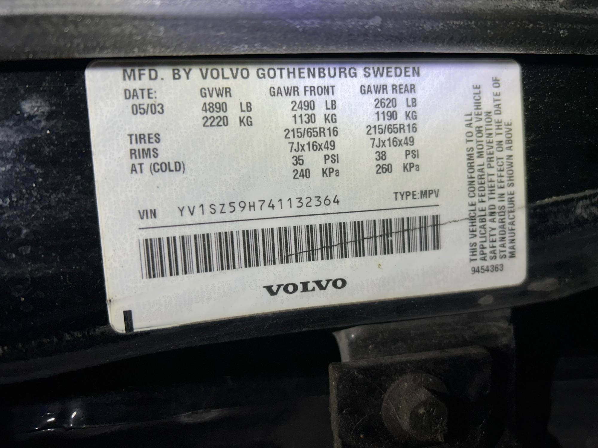

I found a weirdness - assuming my '04 XC70 is a later '04 and has the two-outlet pump (31349228), I checked my build sticker on the rear of the driver's B-pillar post (open your left rear door and look at the post).
My 2004 shows a build date of 05/03 ! Odd.
But per FCP Euro parts descriptions, the later two-outlet pump is for serial numbers 127,149 and up. Mine is 132,XXX, so that's the one apparently.

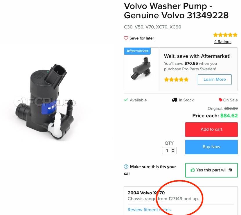

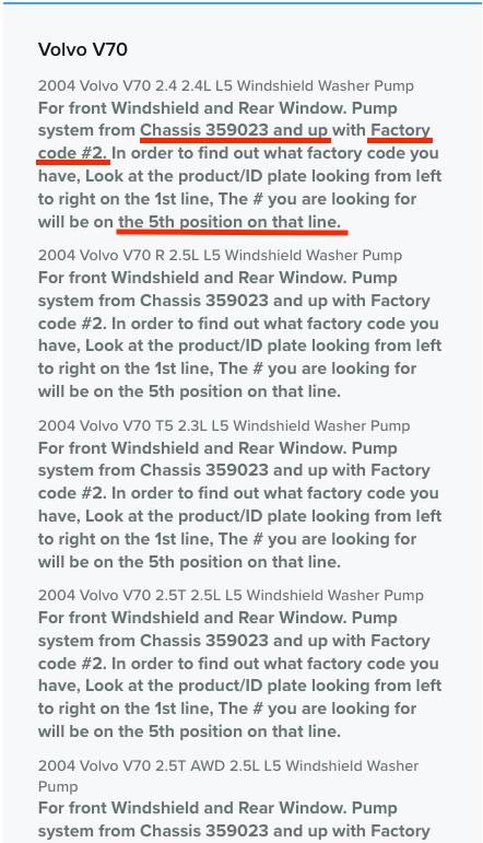

Further unhelpfulness....
This says from 127,149 and up.....
On the same page it says this bit......
Where does chassis 359023 come in? The last six digits of the serial number? Like 127,149? That would make it a year or more after 2004, no?
And here, for "factory code #2," the "product/ID plate 5th position" would be "Z" Or are they talking about the metal VIN plate under the hood and windshield? It would still be Z.

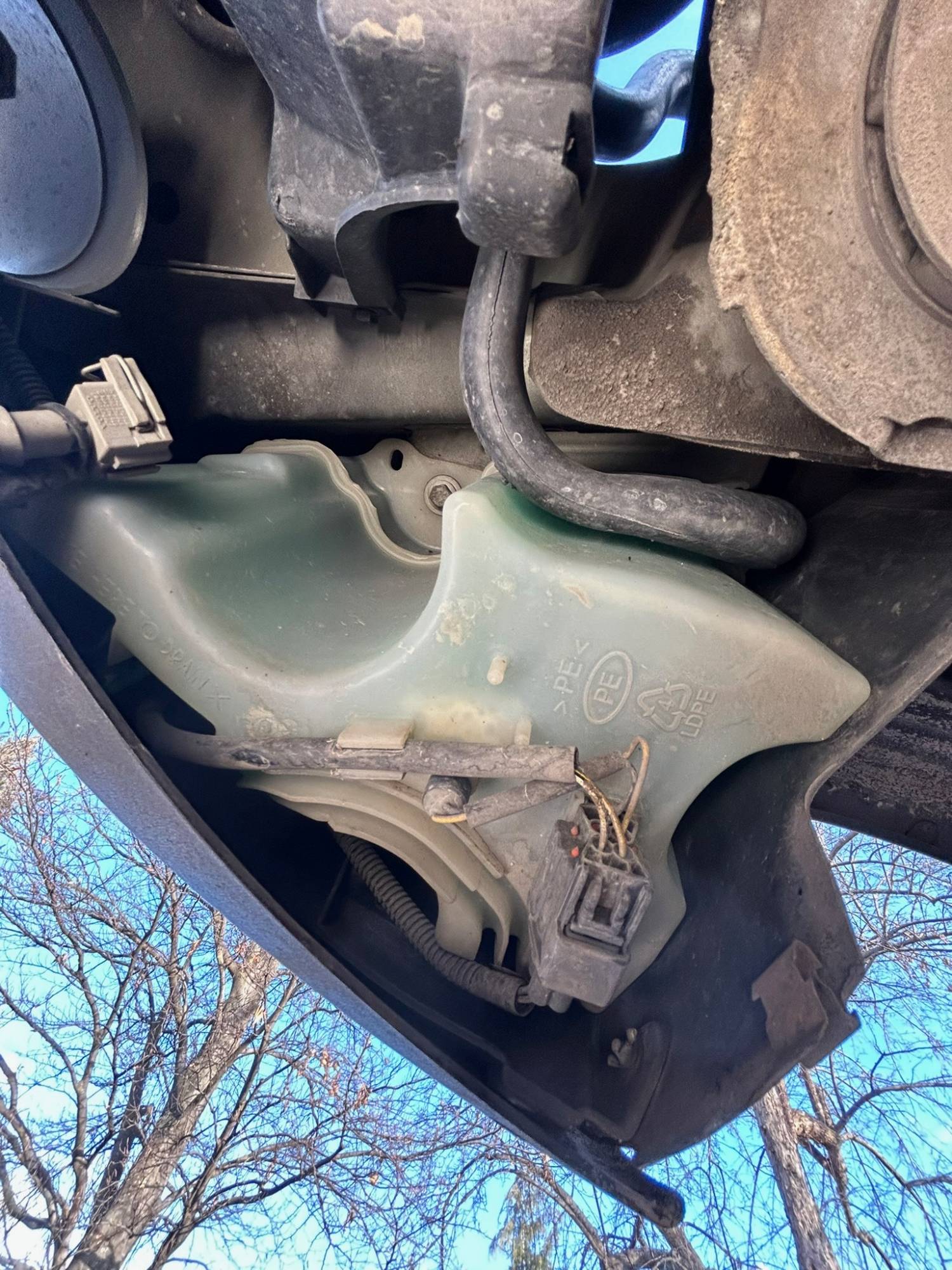

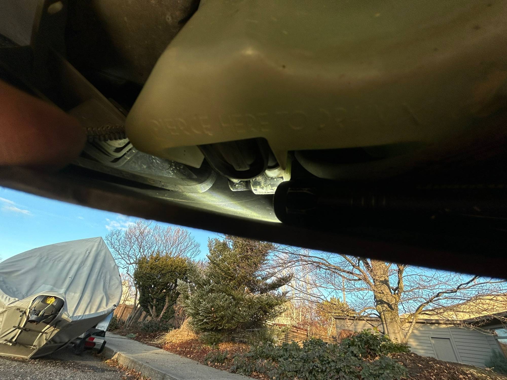

Pulled off the little corner bottom cover with the NACA duct in it....
My tank sits right in the corner of the bumper cover - I think the bumper has to come off the access the pump.
(Loose connector goes to my removed fog light, not the pump)
If I pry out the bumper cover edge, I can just make out a pump with the white and black outlets leading up. It's a tiny thing.
I only see the one pump, not the multiple ones in some applications.
