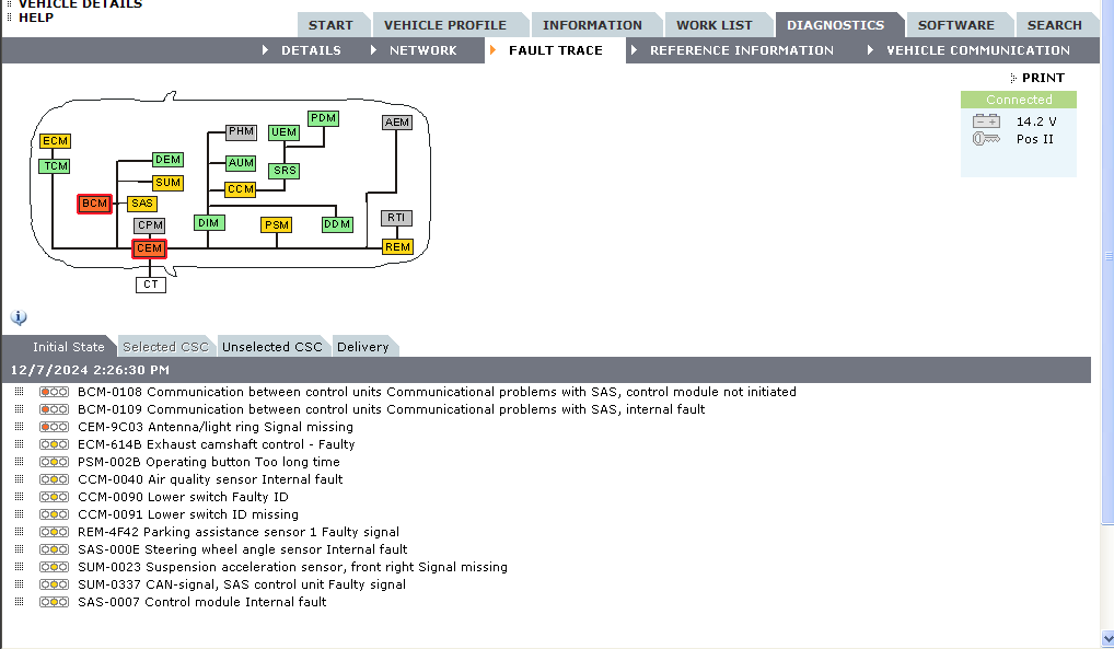

I have an XC70 AWD of 2006, which recently became very unstable when driving over small bumps or uneven surfaces, especially in curves. It feels like it momentarily loses traction with the road, like it's floating or drifting for a brief moment before it regains contact with the ground.
The car passed the inspection last June as Volvo only found a tie rod which needed to be replaced. I replaced it and it passed.
I do have multiple errors at this point, the ABS one has been there for ages, and I know it is due to a faulty clockspring, however, I now see frequency a Four-C off message in the console.
Please see the image below:
I assume many of the other errors are related two main ones: ABS and Four-C.
However I wonder if the Four-C has anything to do with the behavior of my car.
When I mentioned this to Volvo in June, they said that the shocks were fine.

Looking at your codes I don't see ay related to the 4C suspension?
What I do see is SAS related issues (4 of). This thread may be of help:
https://www.volvoforums.org.uk/showthre ... g%20column).
These are to do with issues with the SAS sensor.

True, but it is a fact that the Four-C message indicating that it is off appears on the console very frequently.scot850 wrote: 08 Dec 2024, 02:16 Looking at your codes I don't see ay related to the 4C suspension?
Based on the link you provided, it seems the person had drivability issues as well, although they did not specify the exact type of issues. Do you think the clock spring might be causing that problem?
A new genuine clock spring would be very expensive; however, I wonder if anyone has ever installed an aftermarket version, which is much cheaper. I can change it myself, and I assume I could calibrate it with VIDA.

Maybe a good used one is an option? Depending where in Canada you are, a couple of places you can try other than local junkyards are Chapman Motors on Vancouver Island, or on the East side Erie Vo-Vo in NYC area.
This may be the reason for your steering issues. The other issues can be looked at after sorting this.
