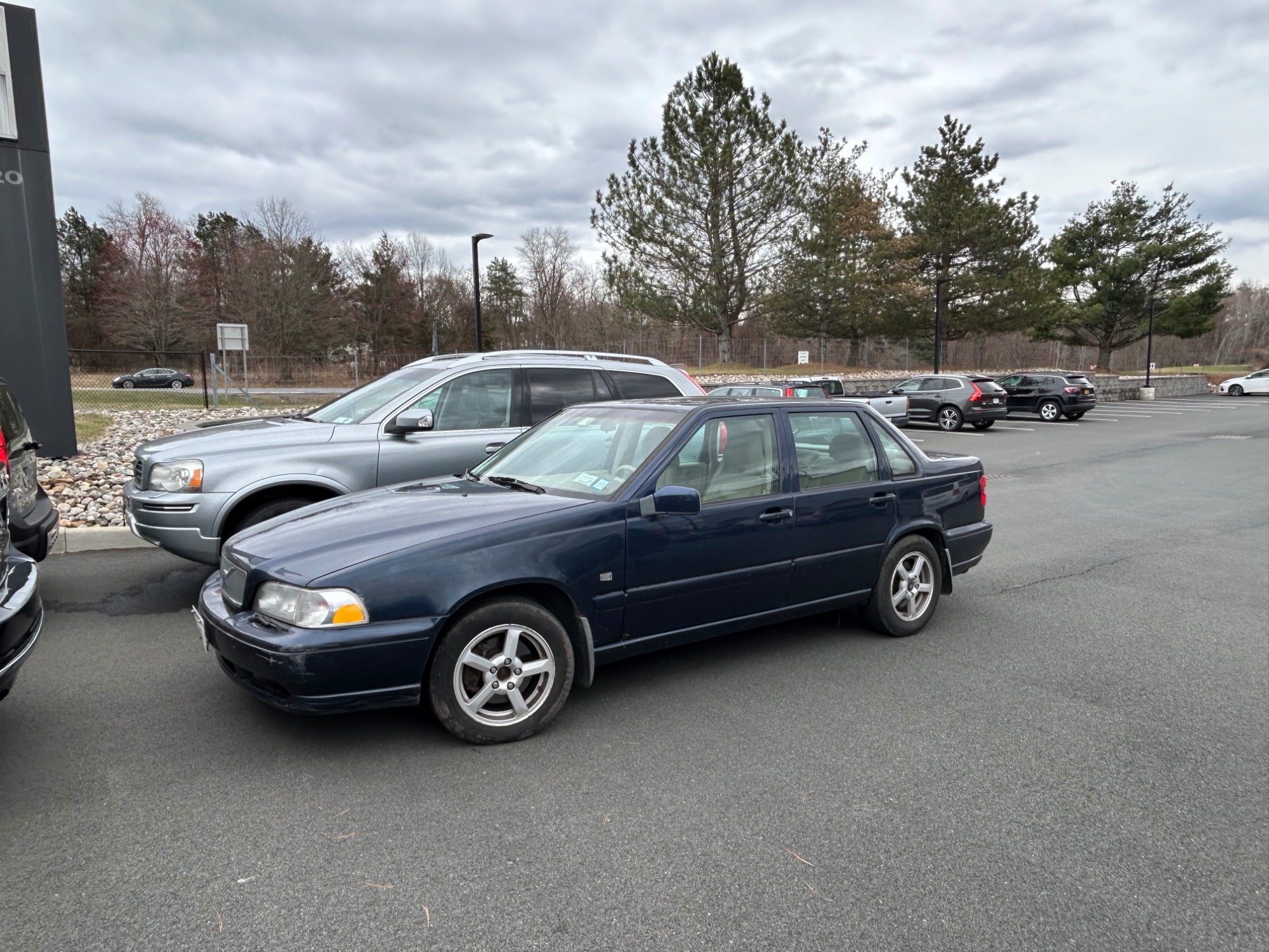

New to me 1999 Sedan in beautiful Nautic Blue

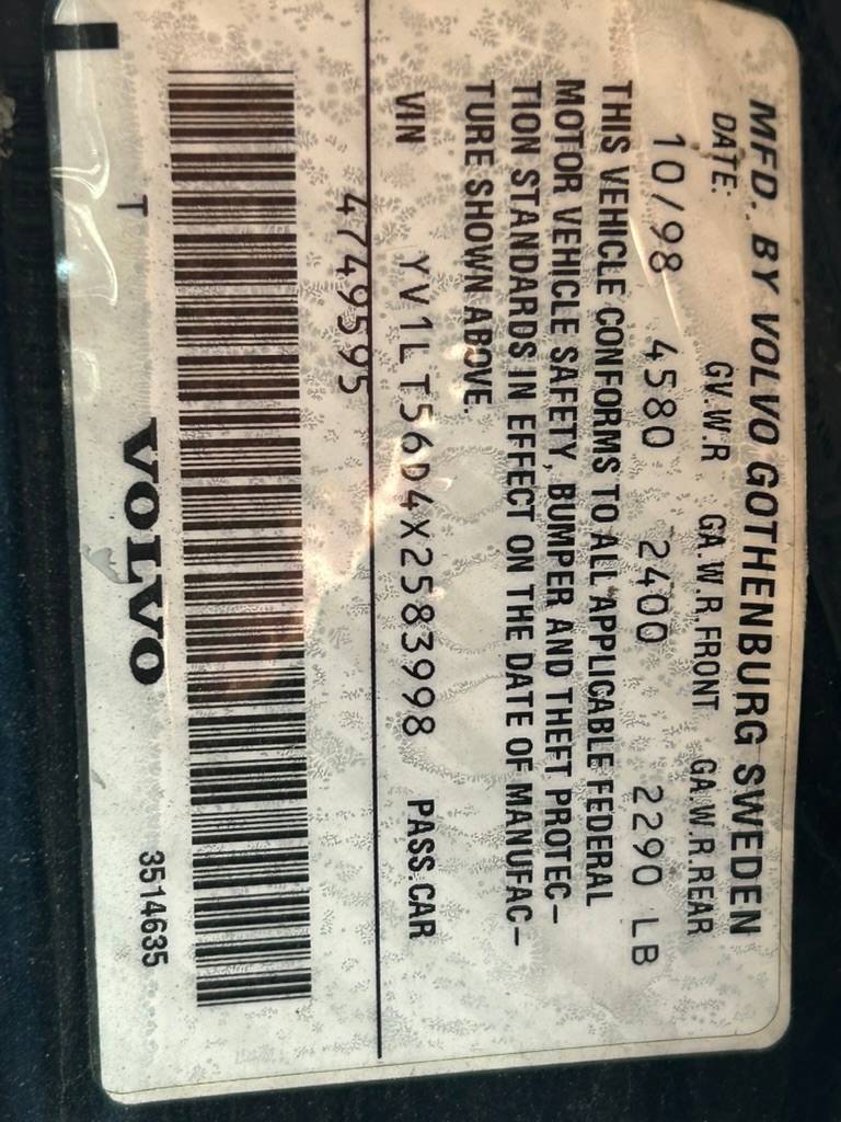

- ID plate code for 1999
