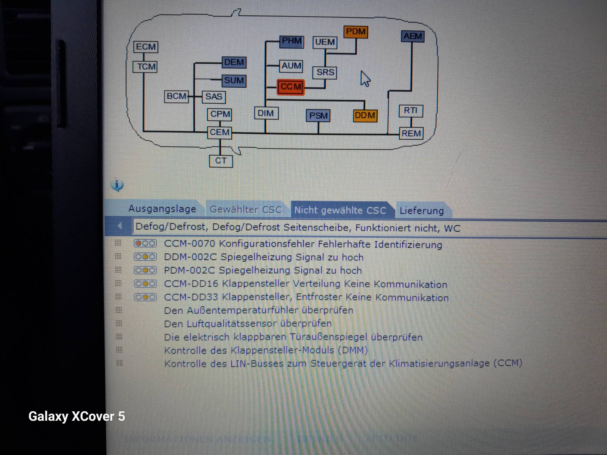

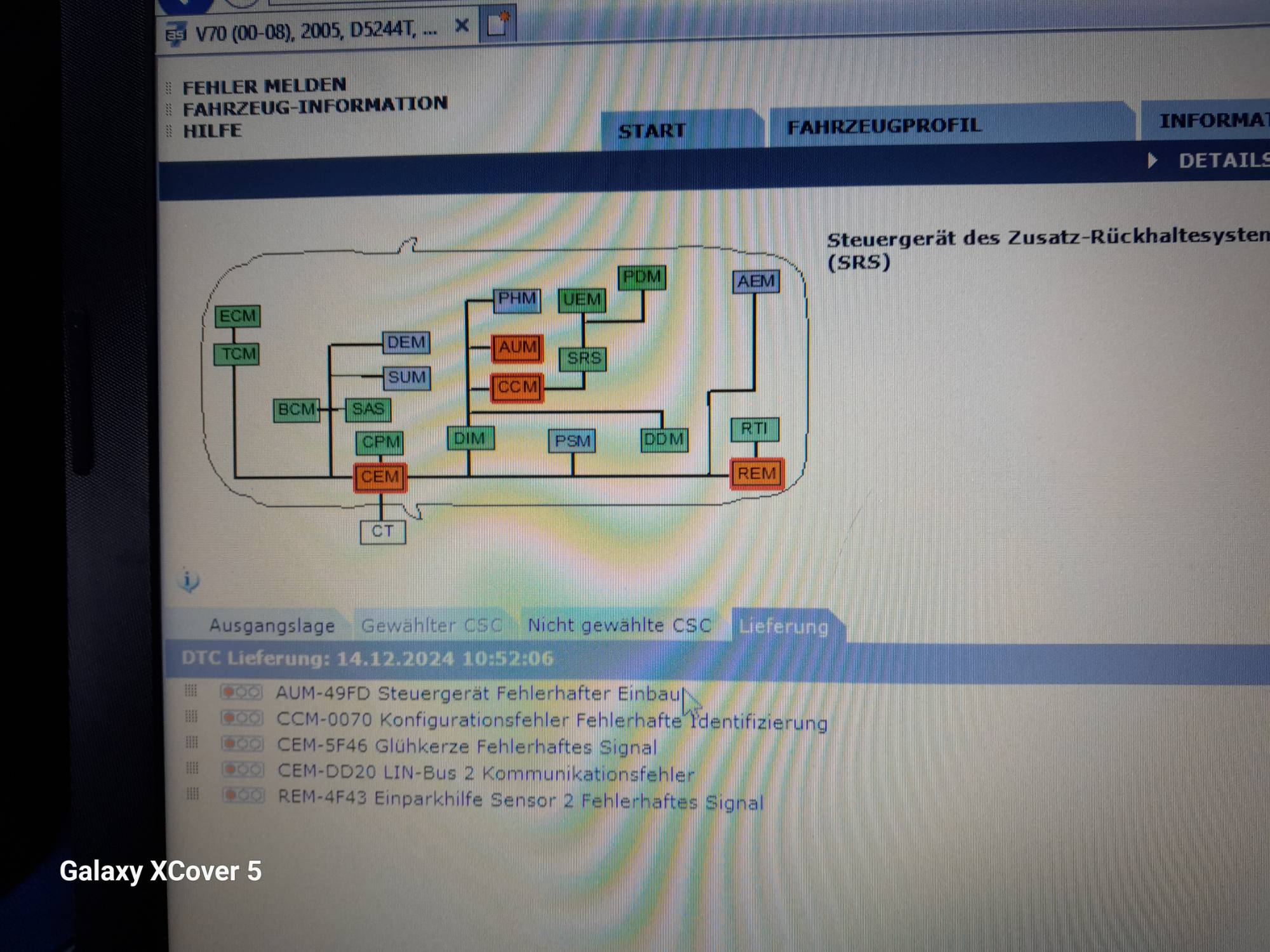

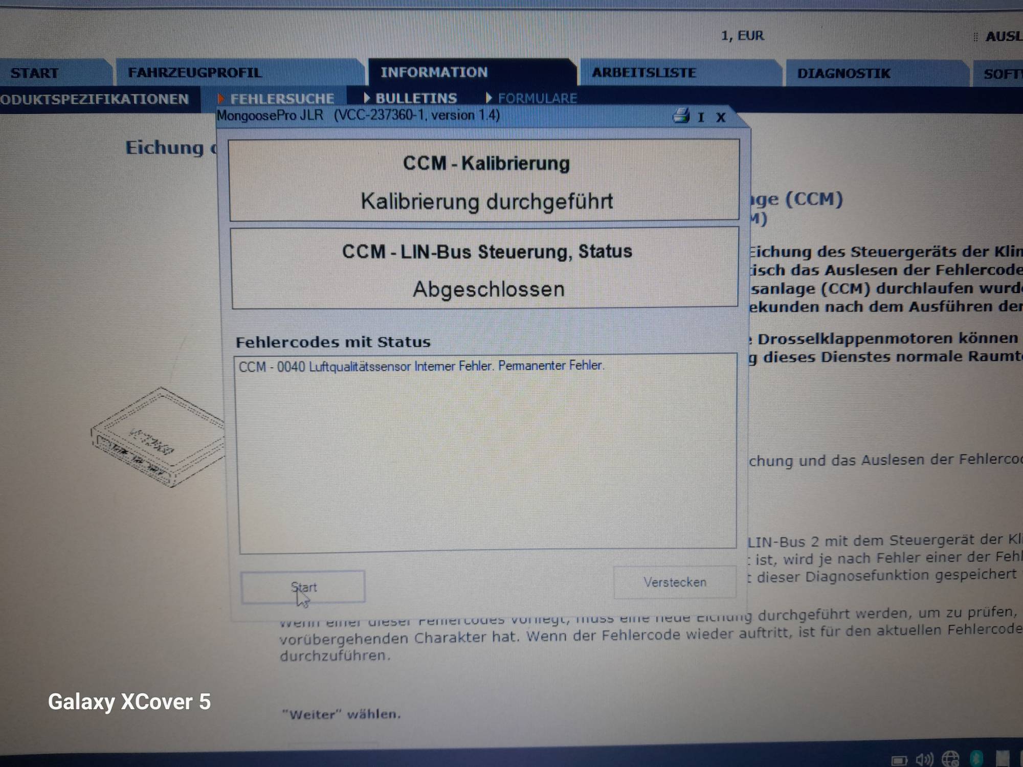

The PDC shows the 2nd sensor as defective (REM-4F43), I will check the contacts there first. Because of the cold air in the passenger compartment, I reinitialized and calibrated the original CCM. All end positions were reset, but the cold air remains, as well as the errors CCM-0070 configuration error incorrect initialization and CCM-0040 air quality sensor is said to be defective. Then CEM-5F46 glow plug faulty signal. That is a job for the summer, remove the auxiliary heating and overhaul/repair it. The CEM-DD20 LIN bus 2 communication error remains for me. Attached are 2 pictures of the error log before/after.
