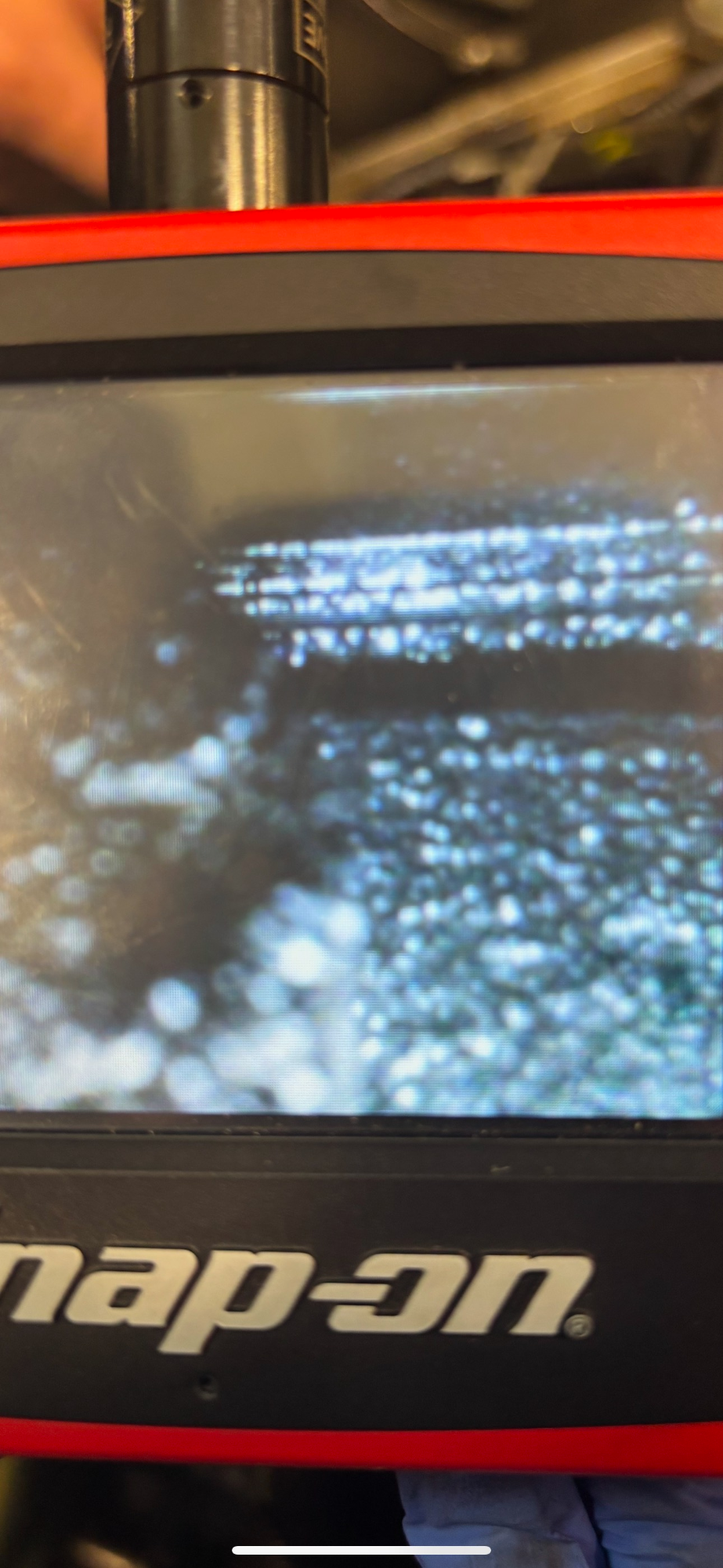

Had the car towed to the dealer to confirm the issue and help to further diagnose the problem. With the use of a borescope, they confirmed a blown valve. See photos. At this point, I need thoughts about whether the valve issue is related to the high engine oil consumption issue (i.e., bad piston ring design). If the two are connected, perhaps I can argue for goodwill to assist with the repair or replacement, given my ownership history. While the car is more than 9 years old, it only has just shy of 92,000 miles on it. My last XC70 (2008) had 255,000 miles when I traded it in and I have driven several of the six Volvos I’ve owned in the last 23 years just short of 200,000 miles. In my experience, most Volvo engines are just getting broken in at this point. I was planning to drive this car a lot longer but am now stuck with having to replace the engine or buy another car. Any/all thoughts are welcome. Thank you.

I'm no expert on these newer engines, but have heard of the oil consumption issues with the 2015/6 engines.
I'm not sure what relationship there is between the failure of a valve and the high consumption of oil. If there are valve stem issues with leaking valves, then possibly oil could be an issue, but again, not sure how the high consumption issue would relate. As I understood it the issue with oil consumption was from badly fitted piston rings where the gaps were too close together. I believe Volvo had a 'kit' to fix that issue with new pistons and rings with install instructions. I may have that slightly wrong but heard via a friend who was a Volvo mechanic.
I cannot really see clearly on the pictures of the valves, but there does look like a lot of gunk in the engine which may be related to the oil consumption.
