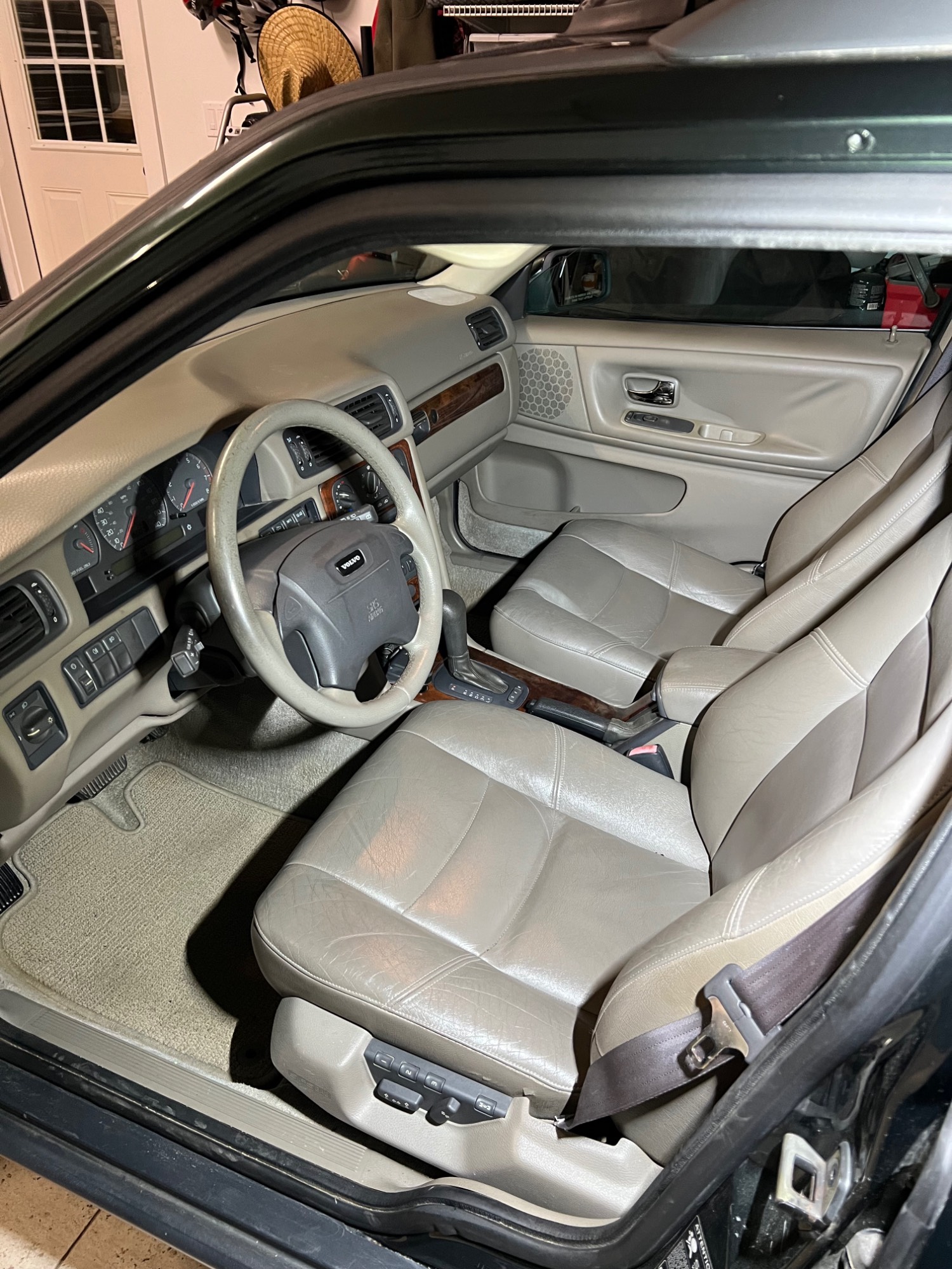

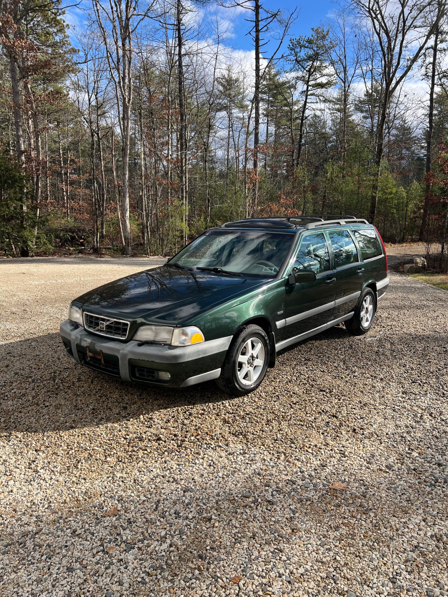

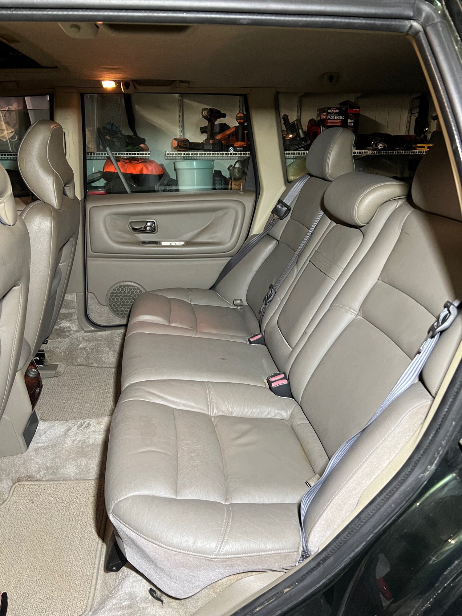

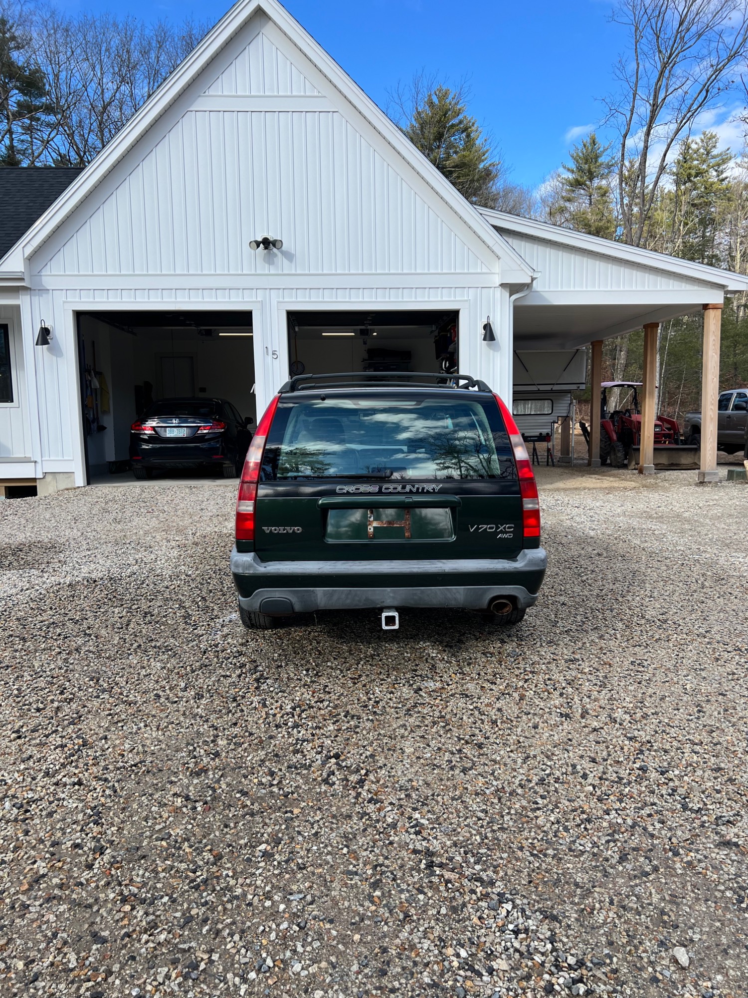

I have been a Volvo guy since 2010 but have been out of the club (and forums) for 10 years. My how time flies. I came across a very cheap wagon recently with no intentions of buying a car and inheriting a new project but here we are! My love for the p80s is even stronger now, and the nostalgia is strong. This car is not a good example of a p80 (you will see shortly), but I justify it by calling it a passion project. The goal is to get it drive able as cheap as possible, do some tasteful upgrades I can recoup later if needed, and have a nostalgic daily driver to split the miles between vehicles. TLDR: at least there are pictures below? Everyone likes pictures.

Wow! While I normally tell potential owners to run far from a P80 AWD, in this case I can see the attraction. The interior is amazing, as is the exterior that I can see too. We owned an identical car bought for a similar amount from an auction with no issues listed. Oh, boy did it have issues!
