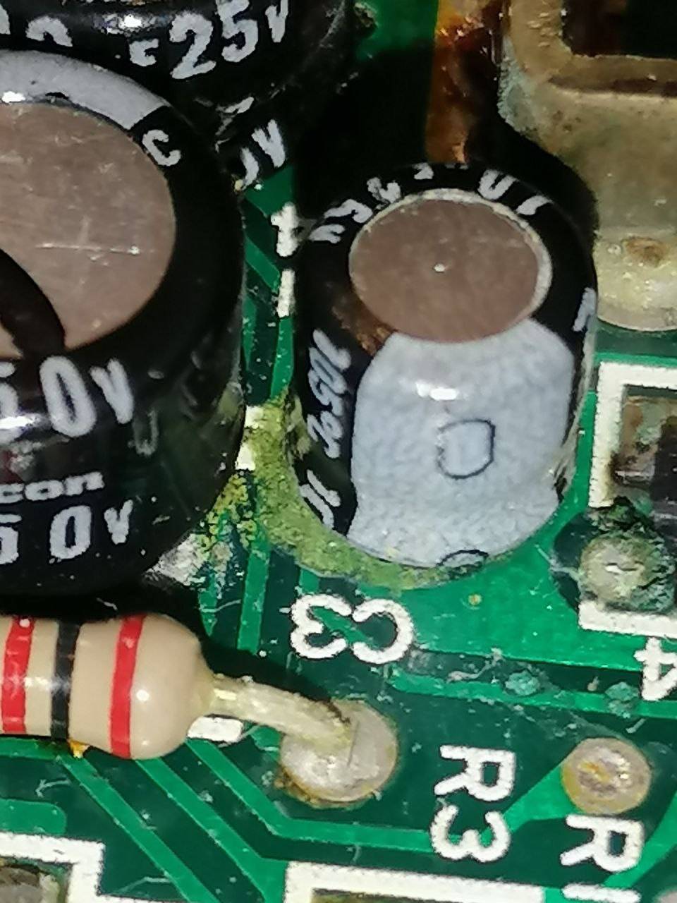

I've tried 2 regulators. One from my car throws 4-1-8 code, and spins blower motor at half of it speed, adjusting speed isn't doing anything. Also, it had a leaked capacitor, but it seems that it didn't damage the board. I've recaped the regulator, no changes.

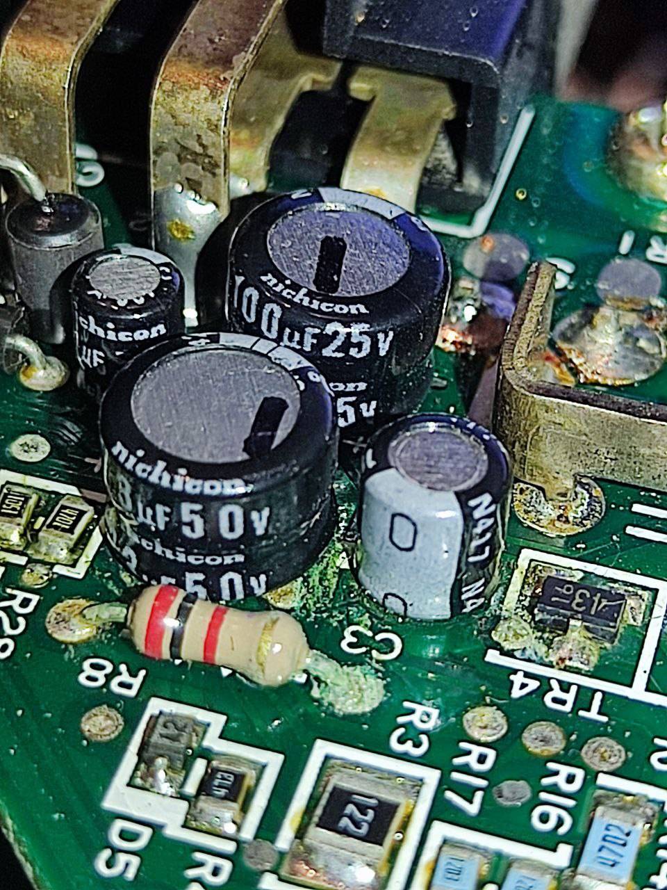

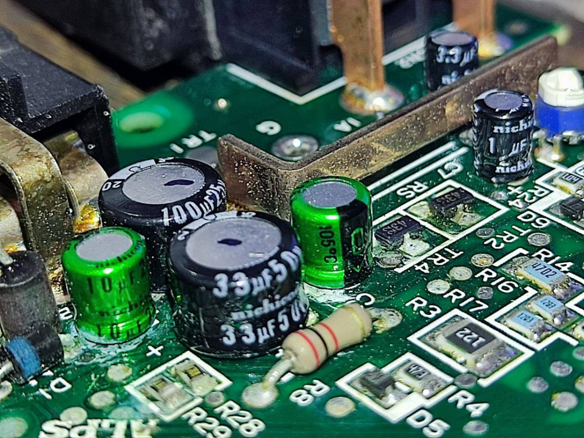

P.S My personal recomendation for every 850 owner with ECC: Check the condition of your regulator, and change 10uf 25v caps with polymer ones(or just new electrolytic japanese ones, but keep in mind - polymer are far superior in any way possible, except for price and size maybe) and change thermal paste on transistor(Arctic MX-4 will do a good job). These are 3 diffrent regulators. Each one of them have same 10uf 25v failed caps, which have leaked on the board and have caused corrosion. 2 out of 3 regulators have failed(No speed adjustment on first one and permanent work of fan on the second one).

100uf caps, not 10uf

nah, look closesly, especially at green ones

Ah, I see. So the green 10uf are the only leaky ones?

Didn't see others leak yet. They aren't always green, I guess it was on very first version of the board. On the next revision, 10uf 25v cap is colored black, and if I'm not mistaken, only one remained on board, other one was replaced with 1uf 50v one. Don't know anything about last revision, didn't saw them yet. S70 Regulator doesn't even have this capacitor
