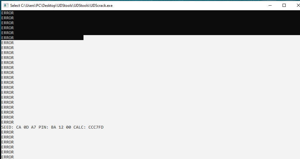

Hello,
2006 V70 CEM - 31394157
Trying to get my CEM pin using T5Luke's UDScrack
Getting bunch of errors, not sure if it's working right
