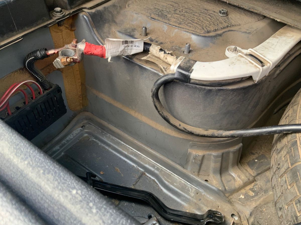

There is a fuse on the cable that connects to positive battery terminal of many v70s.
No, it is NOT documented anywhere in the wiring diagrams.
Look at the battery connections, and follow that red cable, as you never know what kludges have been attempted by prior owners, and you have a v70R, a kludge magnet.

Well that is a new one to me. I know on P3's there is a fusible link that becomes a pain after multiple battery connector removals, but not on the P2. Thanks, now I'll have to go look..............!

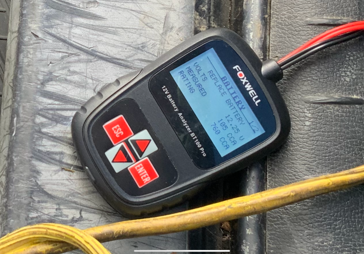

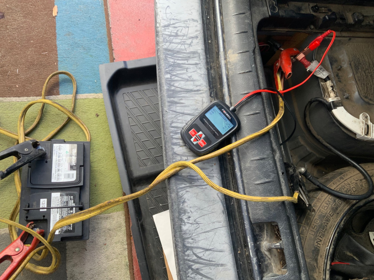

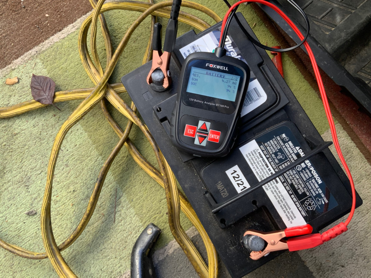

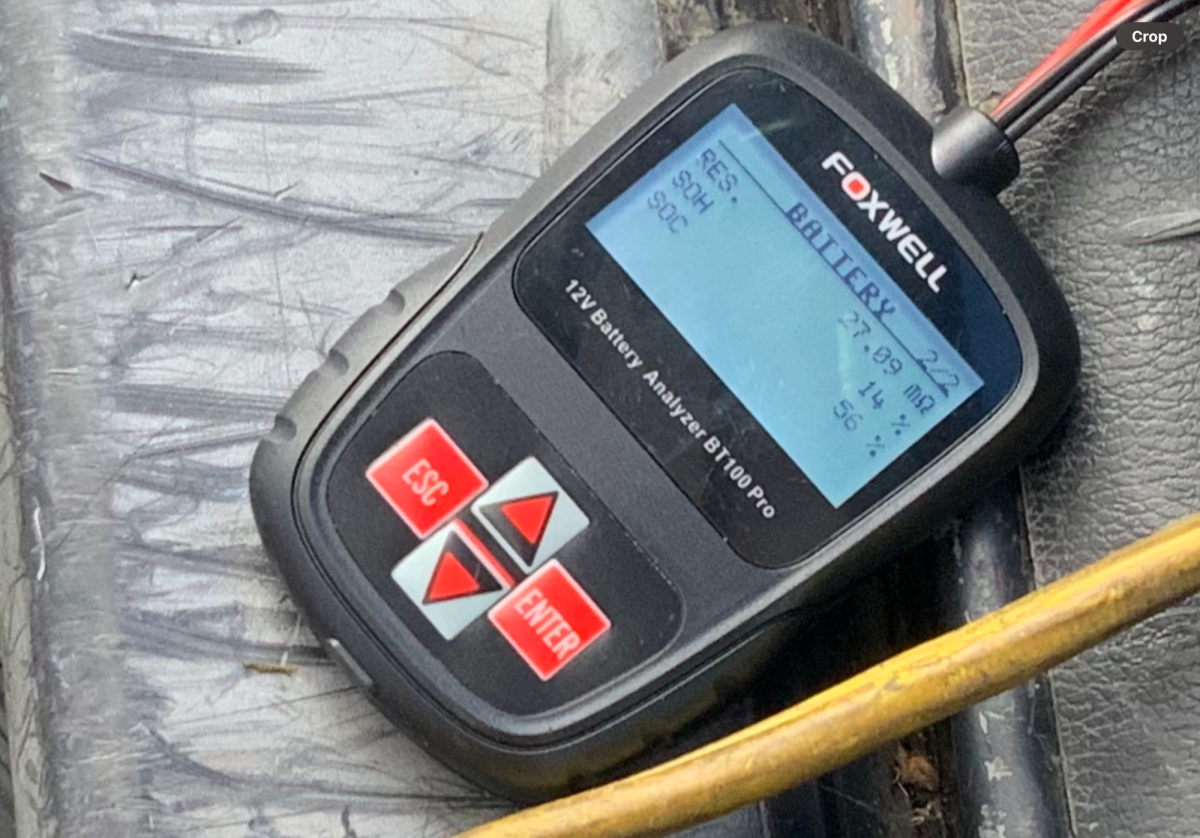

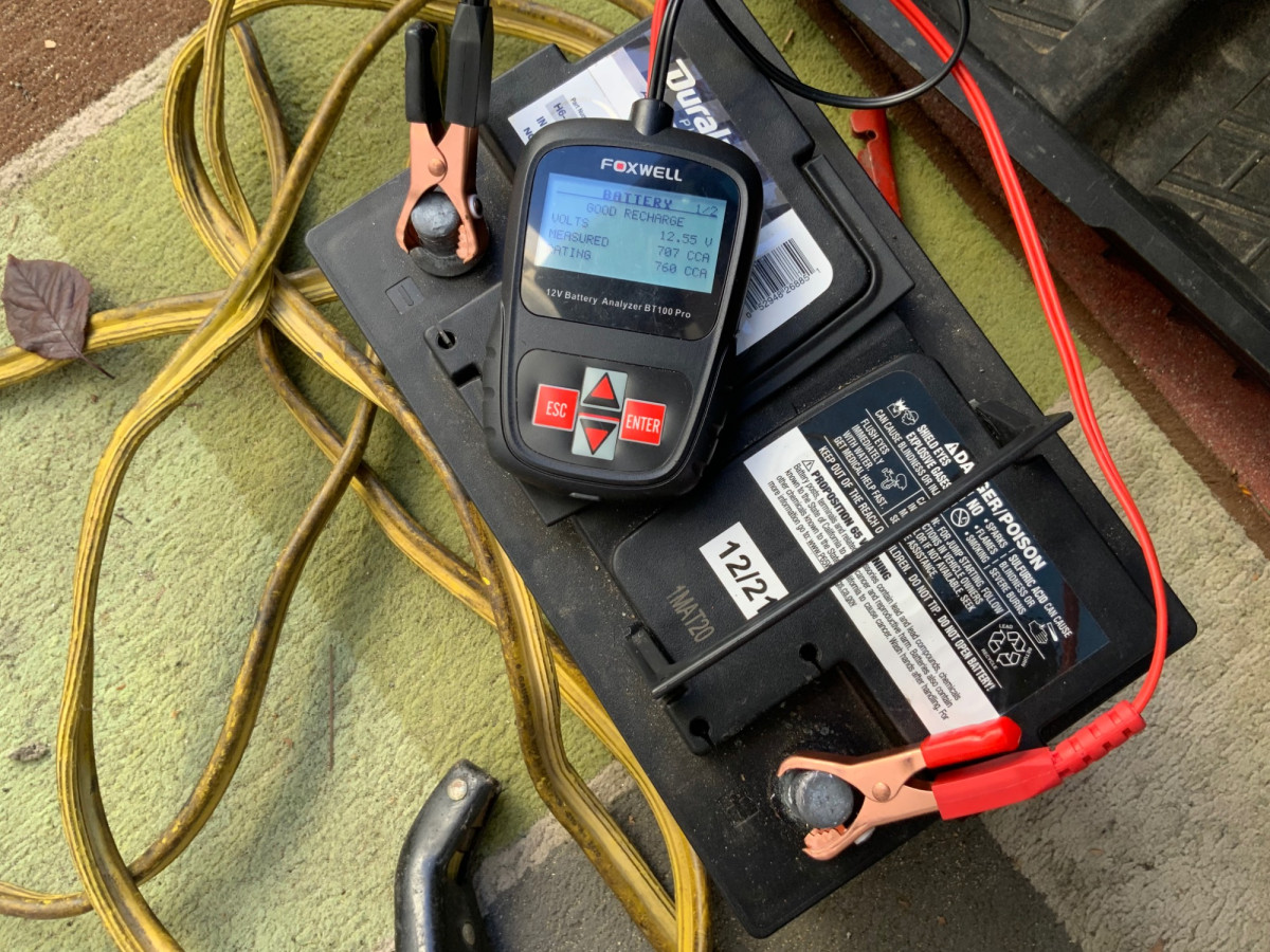

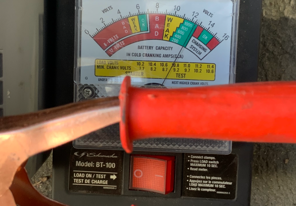

AutoZone tested and charged the battery. Said it’s good.
I took it home and connected it with battery cables. Nothing. I connected my battery tester and the pics are attached.
The setup… Readings while connected… Readings disconnected from car… I also connected a load tester which read over 800 CCA after a 10 second load test, and measured 12.5 volts and holding steady after removing the load. If anyone who knows where the possible fuse might be located, please say. Do I need to remove the floor panels behind the back seats to get to it? I’d greatly appreciate feedback regarding what I might check next. Tks.

No comments on my last post, eh!
The 2.5 year old AGM battery reads good/recharge when not connected to anything. But if I connect something , like either the car or jumper cables and take a reading from the other ends , it reads “replace battery”.
Does anyone know if this is normal?

As for the odd readings from the Foxwell battery analyzer (oddly, also called “BT100”) in the photos above, it seems that the device only reads the battery properly when connected directly to the battery, because it reads “replace battery” (even with a brand new battery) when connected to the +ve terminal under the hood, but who knew.

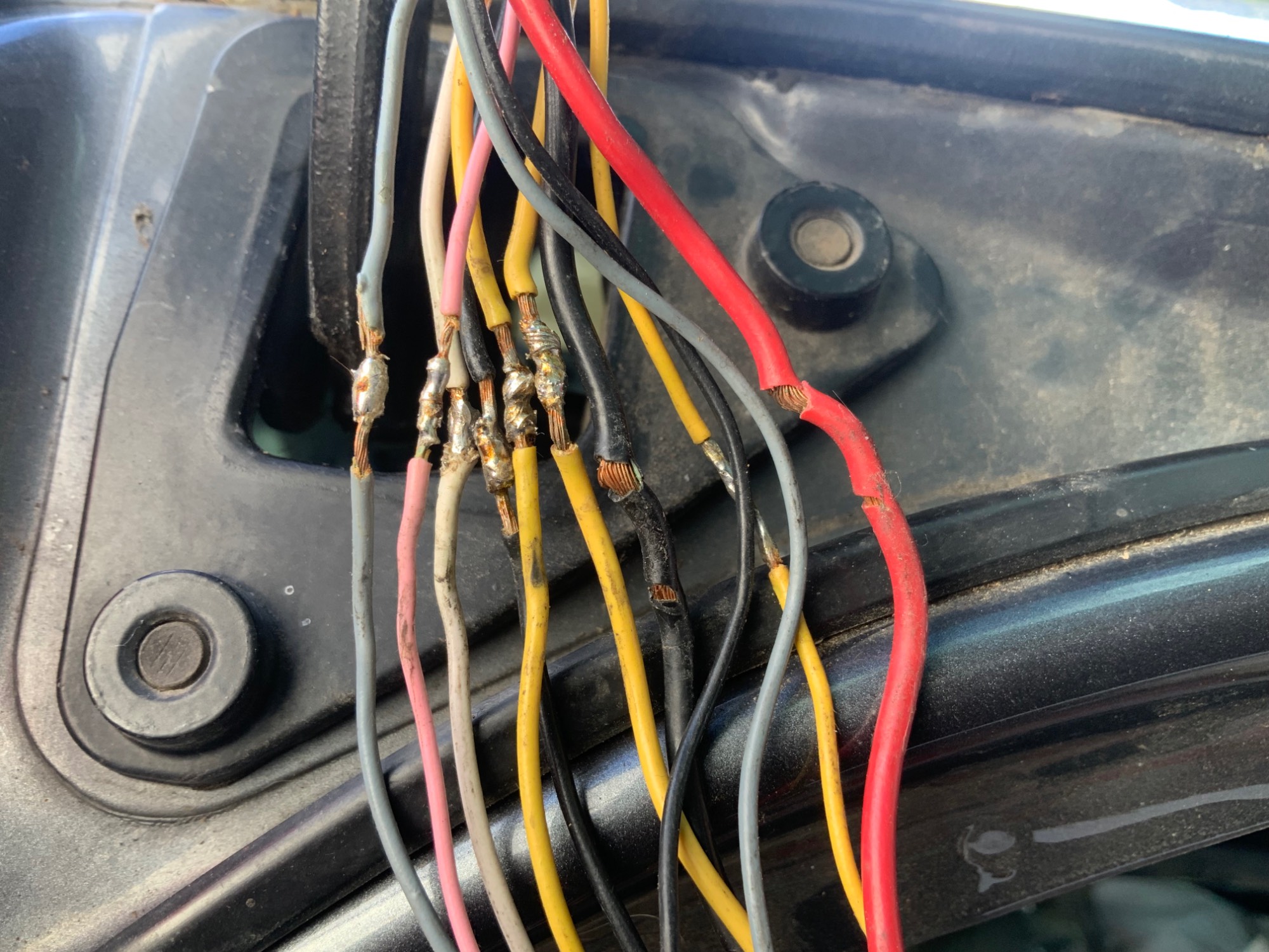

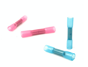

Update. I had made some repairs to the tailgate wiring a few years ago, soldered and electrical taped. The other day I found a previously soldered wire, one of the three yellow wires (hidden behind the thinner black wire in this photo), was no longer solid (when I removed the tape to check the connections), and the connection separated as I removed the tape. I have now decided to replace the wiring harness altogether using part number 8645685, which is on its way.
I did, in the meantime, reconnect the yellow wire. I still had the “tailgate open” message once or twice shortly after doing that, but not for the last few days. I’ve also been locking the doors without setting the alarm, to avoid the light on the dashboard near the windshield from flashing. I haven’t therefore had the alarm lights on the outside of the car flashing, which I think was draining the battery.
I might add a post to the thread about the tailgate wiring when I change the harness, but it does seem that all my “complete electronics shut down” issues were, as suspected early on, battery related. This has been a long and frustrating experience to say the least. I hope some part of this post will save someone much angst. Cheers all.

ABscate advised a voltmeter, I would go better and get an automotive meter, $35 ebay.
Read v at the battery , then read at the terminals in the engine bay, any appreciable drop , as shown on the foxwell, and I would run my own aux temporary wire to see if that clears up any problems.
I'd disconnect the battery and run resistence checks on the 12v feed from the battery to the engine bay.

I'm sorry, this repair looks subparimaV70Rdriver wrote: 10 Jan 2025, 12:44 Update. I had made some repairs to the tailgate wiring a few years ago, soldered and electrical taped. The other day I found a previously soldered wire, one of the three yellow wires (hidden behind the thinner black wire in this photo), was no longer solid (when I removed the tape to check the connections), and the connection separated as I removed the tape. I have now decided to replace the wiring harness altogether using part number 8645685, which is on its way.
