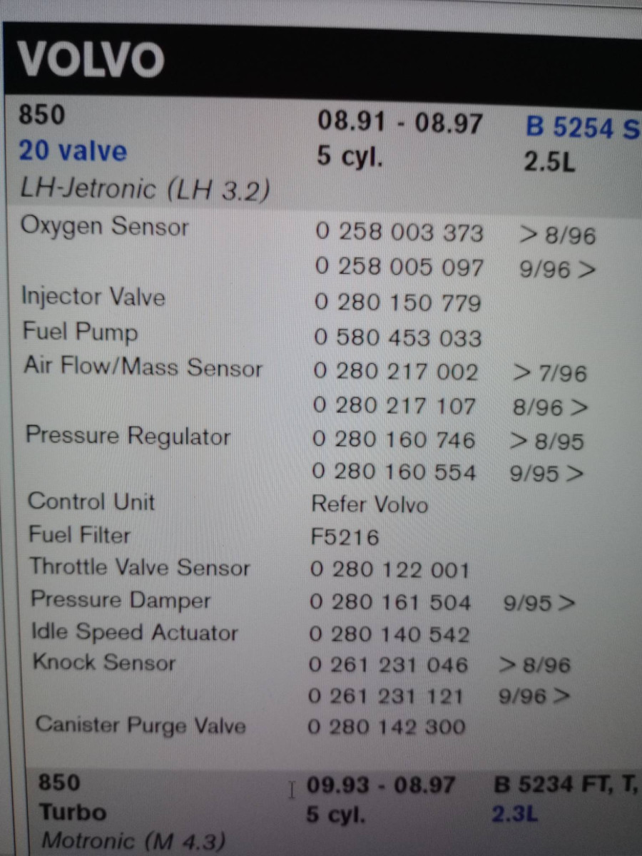

- misha
- Posts: 5437
- Joined: 07 Dec 2008, 16:09
- Location: Serbia
- Has thanked: 155 times
- Been thanked: 432 times
Just came across this when searching something else: I forgot i have this catalogue.MaiconTanK wrote: 27 Sep 2024, 15:54 ...So, my naturally aspirated Volvo 850 2.5 20v with Jetronic injection, how do I find out the correct MAF sensor code? My car no longer has the original sensor, and it got lost in a workshop. Is there a way to find out? Thank you!
