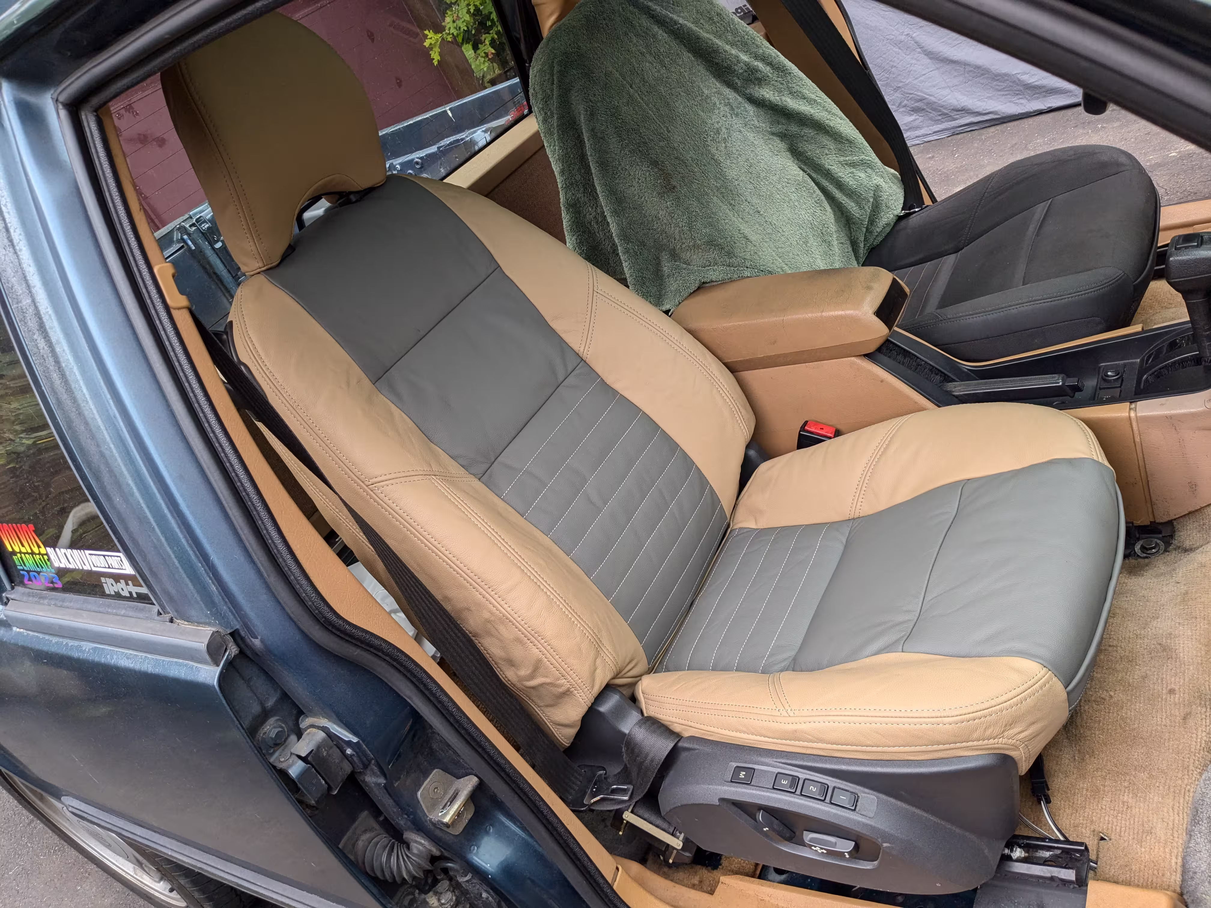

Just to wrap up my install - the finished passenger seat, working & installed with new leather. Since I'm likely to add more gray interior parts over time I went with a beige/grey combo. Still have to heat the leather some more to get the remaining wrinkles out

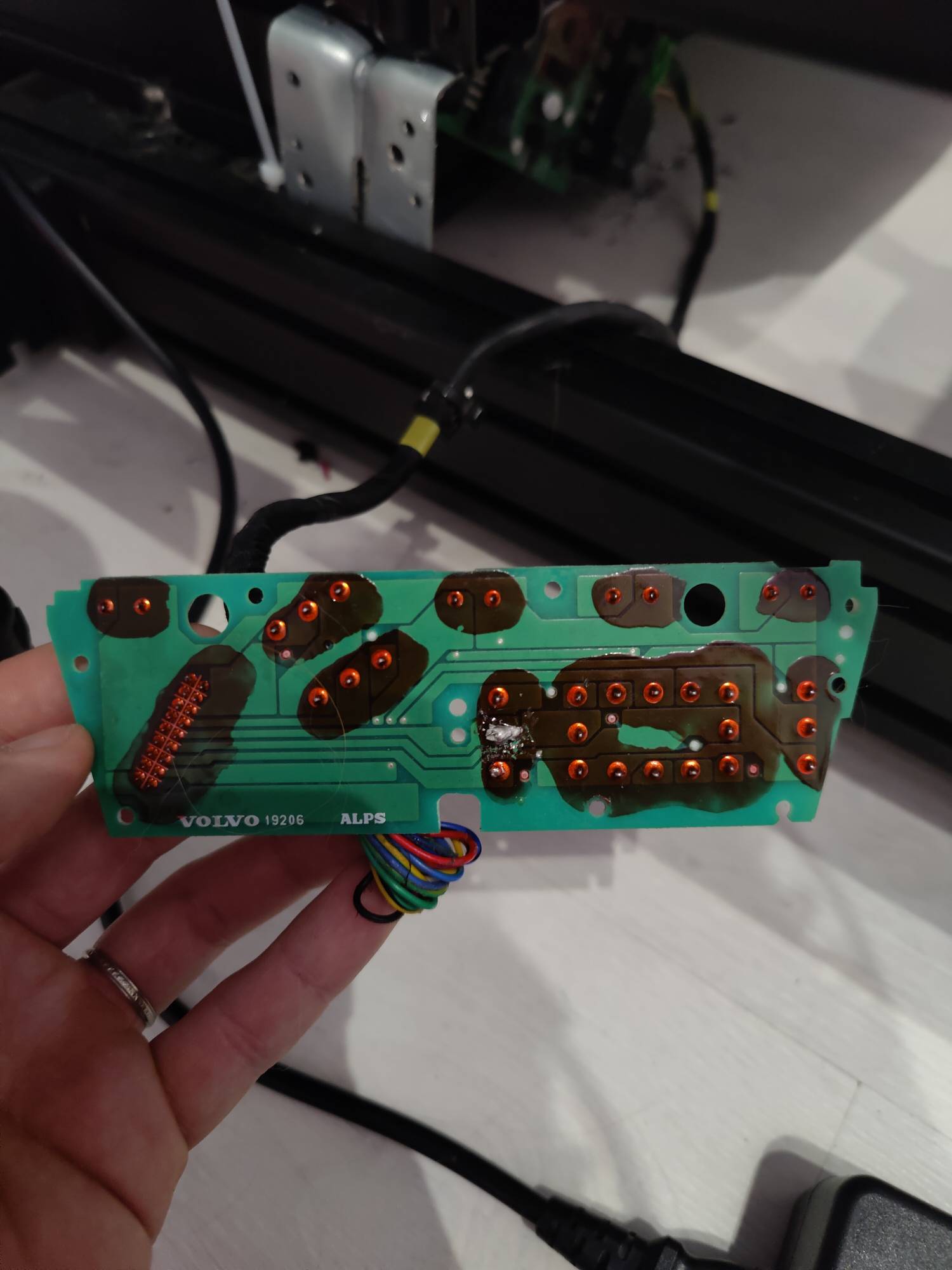

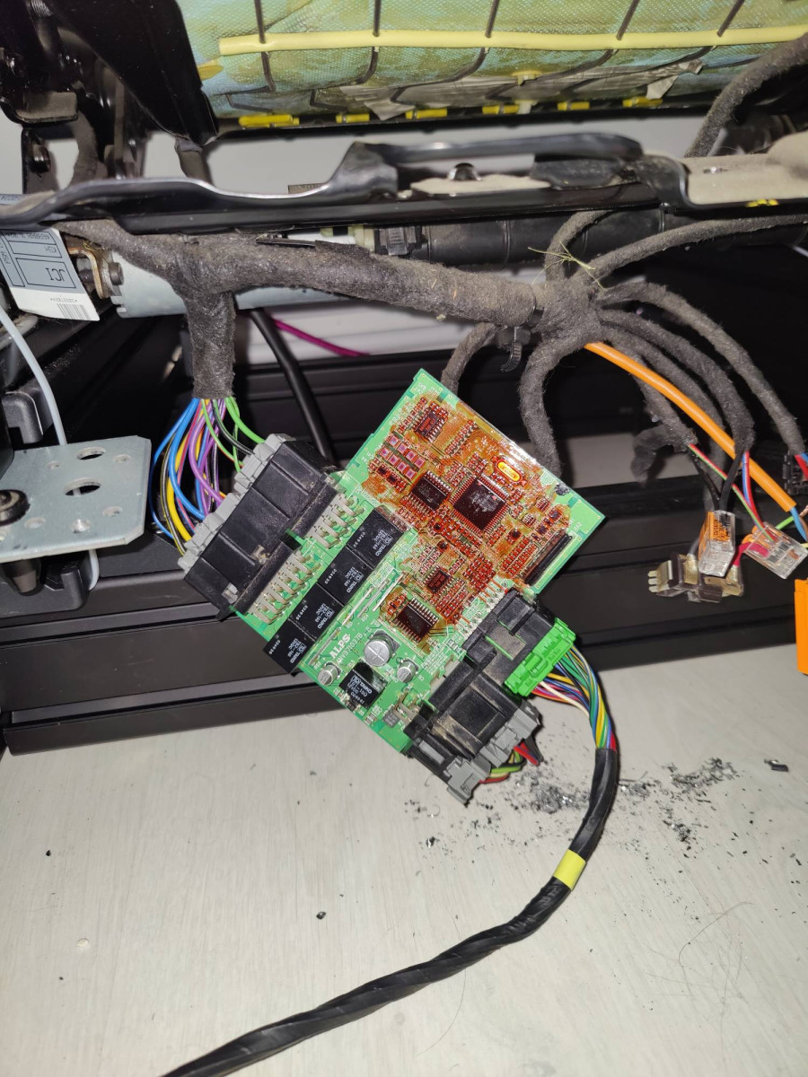

Hi. Thank you very much for this topic, it helped me a little to understand the situation. However, I still have a problem getting my seats to work, as my board is a little different to Mr lookforjoe's board. Could someone please advise what I can do here, as when I tried to do as lookforjoe did, the seat still did not work. The motors are working when connected directly from the battery.

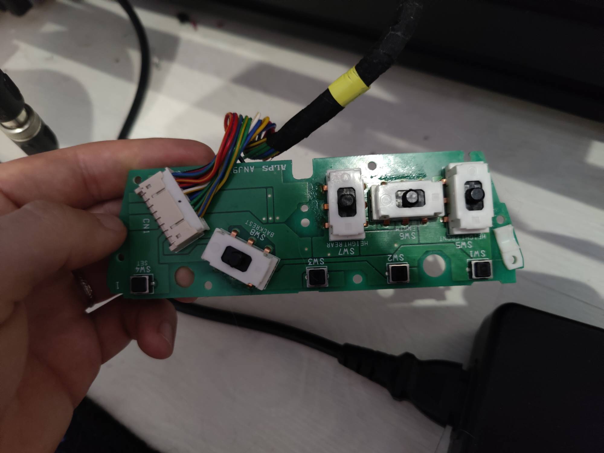

It was cool to actually see someone else having the same idea with me. I also bought Volvos power seat from junkyard and i have tried to copy this thread and use it on my racing simulator but it didn't work for me. After taking a closer look, it seems i have different switch module. Is there any possibilities to perhaps give me a helping hand with this?
