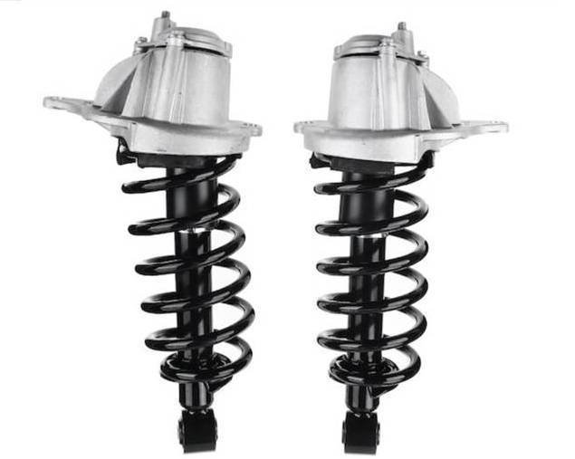

I've attached a picture just so we're all clear on what I'm looking for.

Removing the struts from rear is doable with some cursing. Long pry bar or heavy duty ratcheting strap help to get enough clearance to remove them from the car. I would stay away from those assembled quick struts since they don't last and your ride quality will change. Fcp euro has individual shocks and springs for sale. The easiest way would be to buy shocks/springs and bring them to a decent shop so they can swap them in into your old top "housings" from old units. Probably will cost you 1 hour of labor for both.

No, these are for the front, I need a complete setup like this but for the rearscot850 wrote: ↑17 Jan 2025, 15:52 Is tis what you are looking for?

After doing some more searching, I'm convinced that nobody makes/sells a complete "Quick Strut" set for the rear of the S60 models so I'm just going to buy all of the individual parts, assemble them as a complete unit, and install them (as a complete unit).
I already have the shocks, so all I need now are new springs and new top housings, and any other associated hardware. Hell, I might even be able to reuse the top housings if they're still in good shape
This way I can remove the old units without having to take them apart or compress springs and all the other insanity while everything is still within that tight space back there.

That is how Volvo does it with a wide tie down strap.
With the age of your car, depending on the mileage you might want to consider replacing the upper mount/seat as the bush will degrade it's rubber over this time. I have a set of P1 rear shocks to do on a V50 AWD and the owner decided to spring for a new seat after he pulled a used one and it was badly worn when we checked it.
