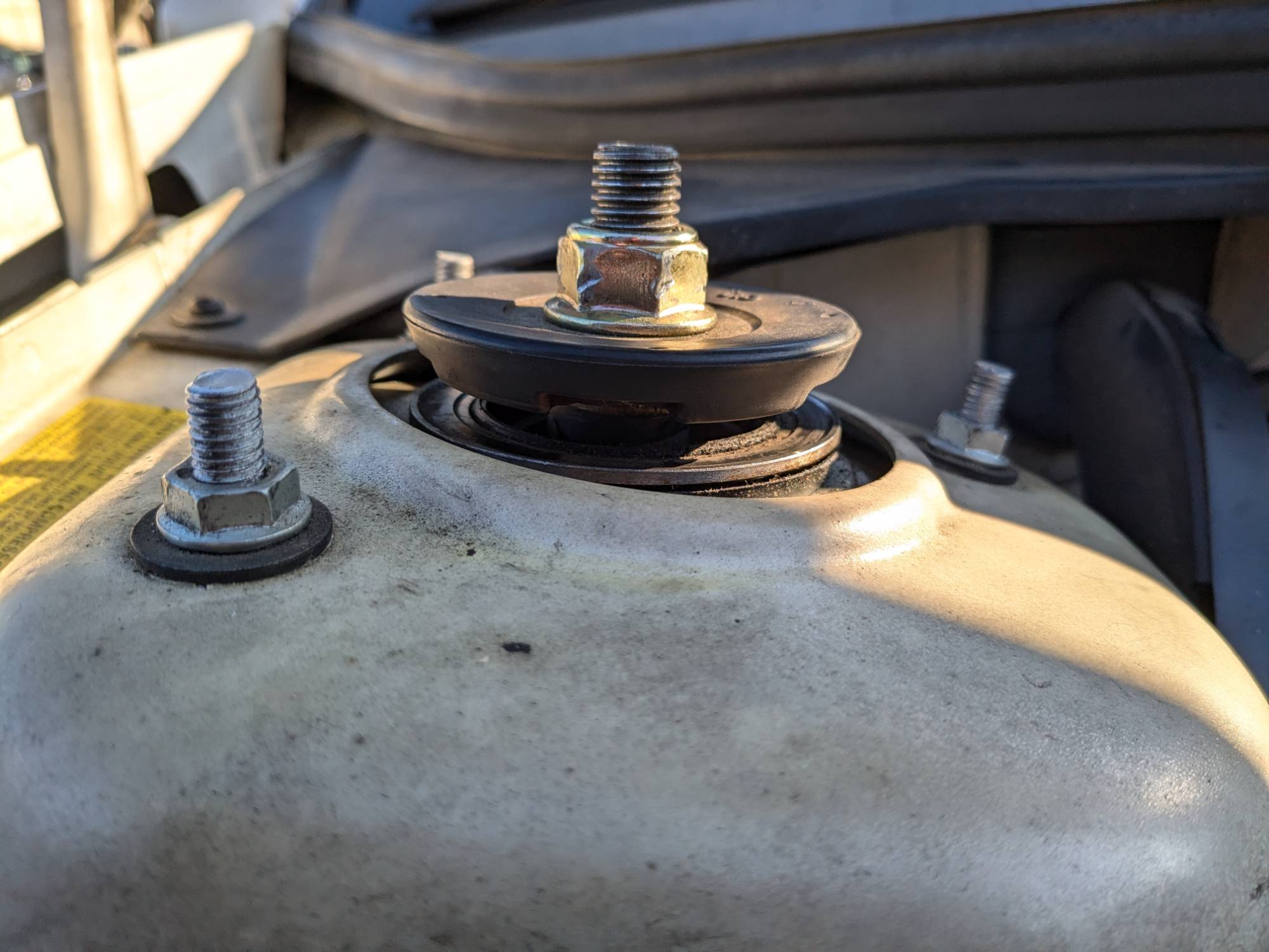

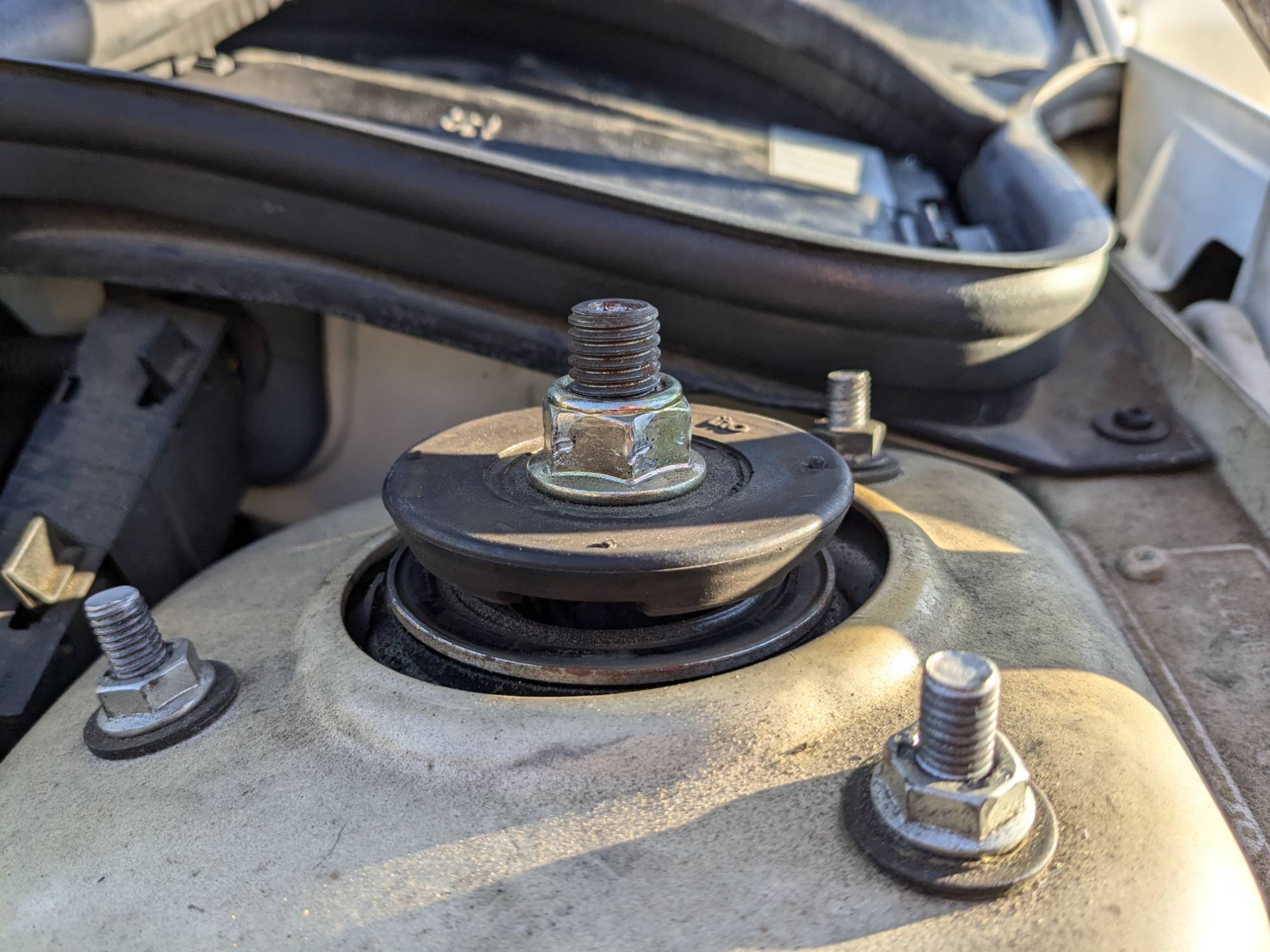

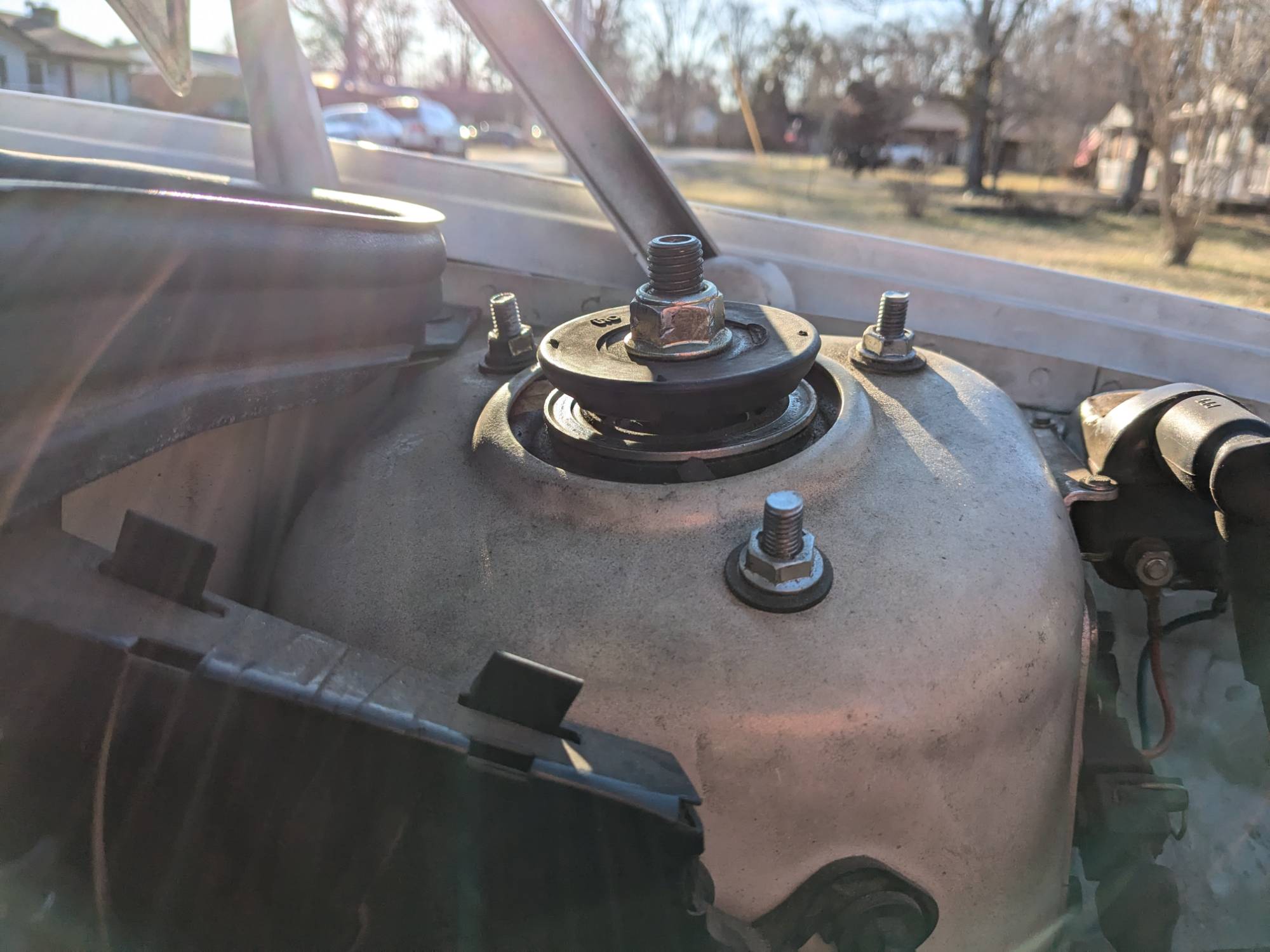

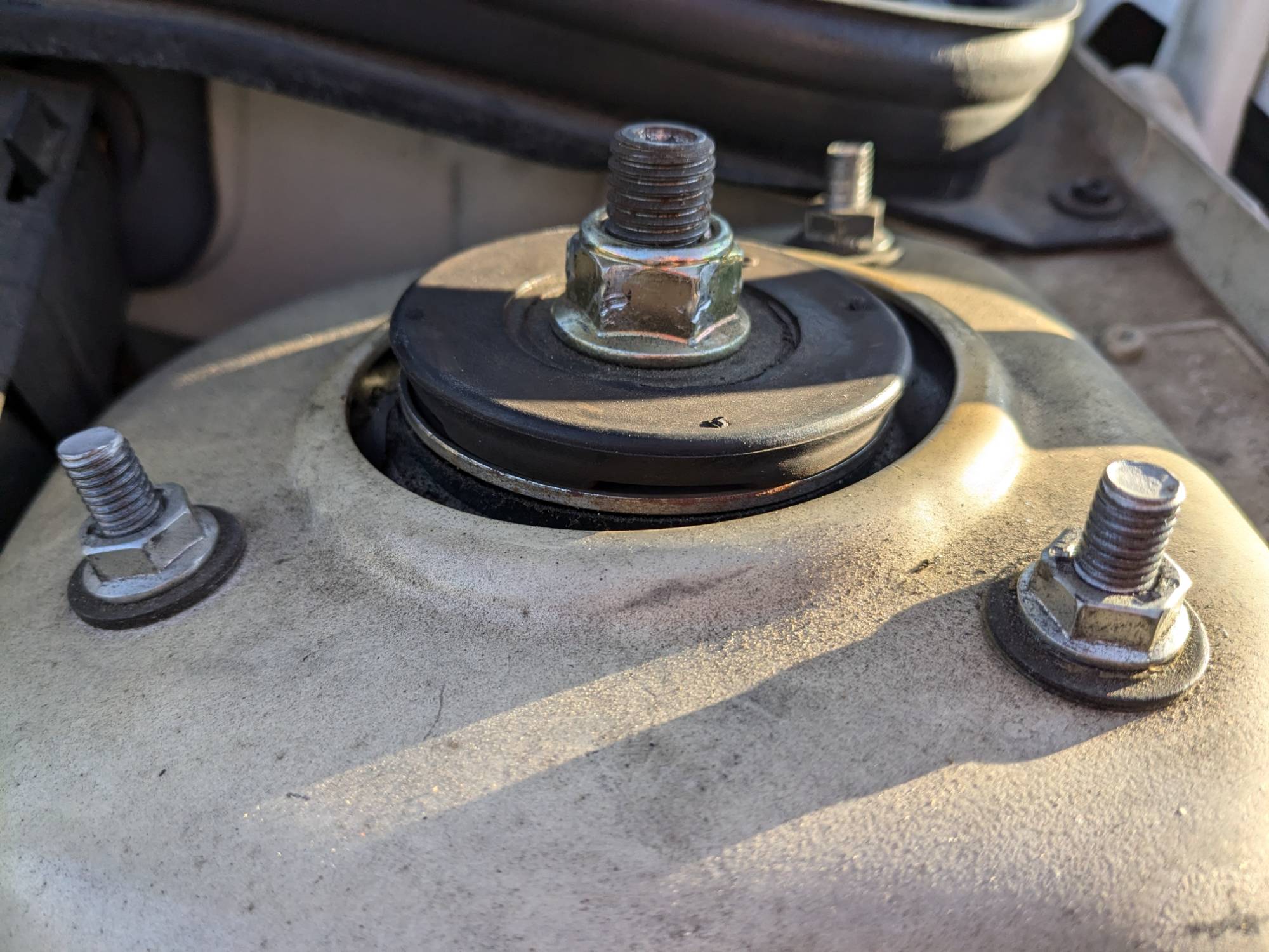

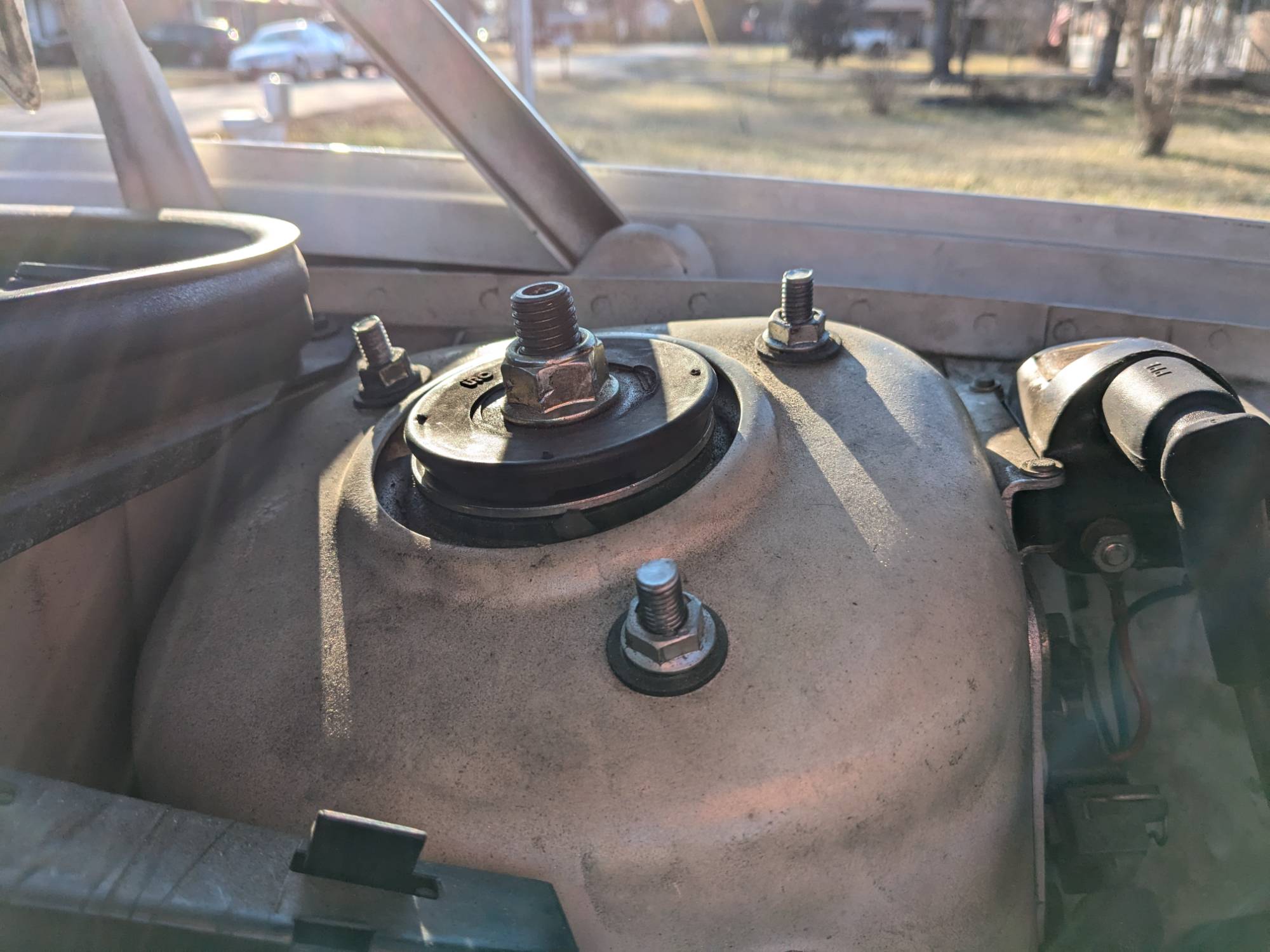

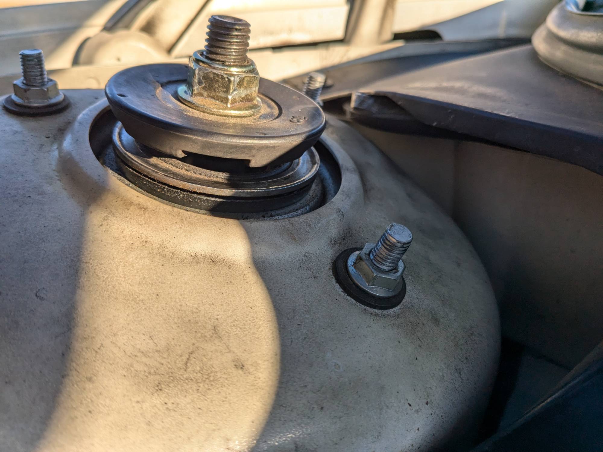

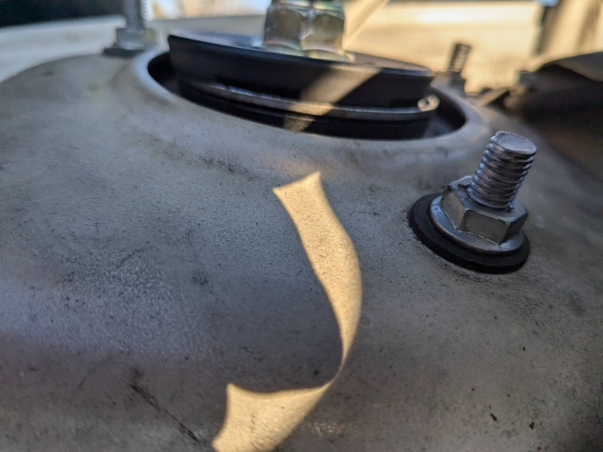

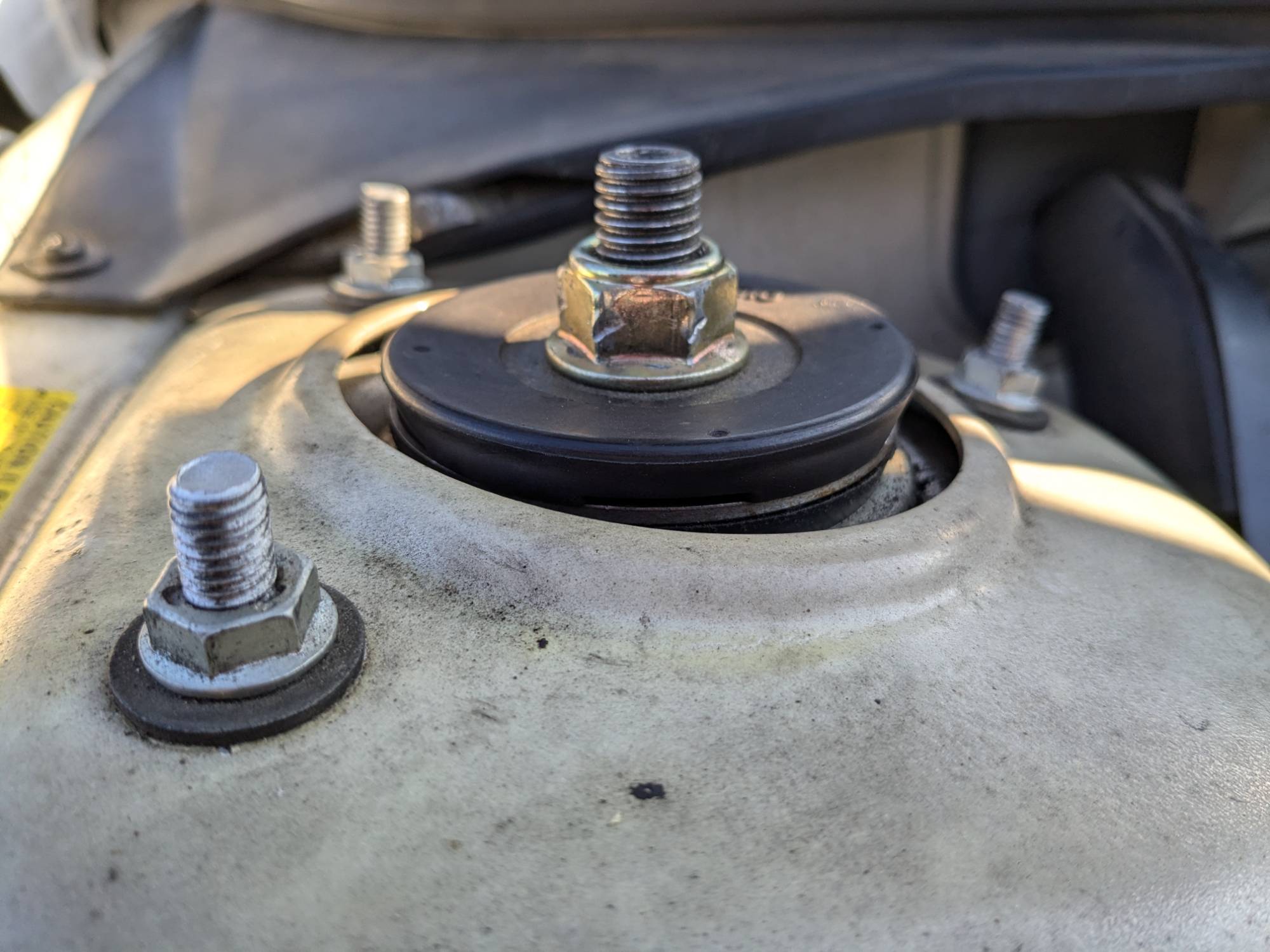

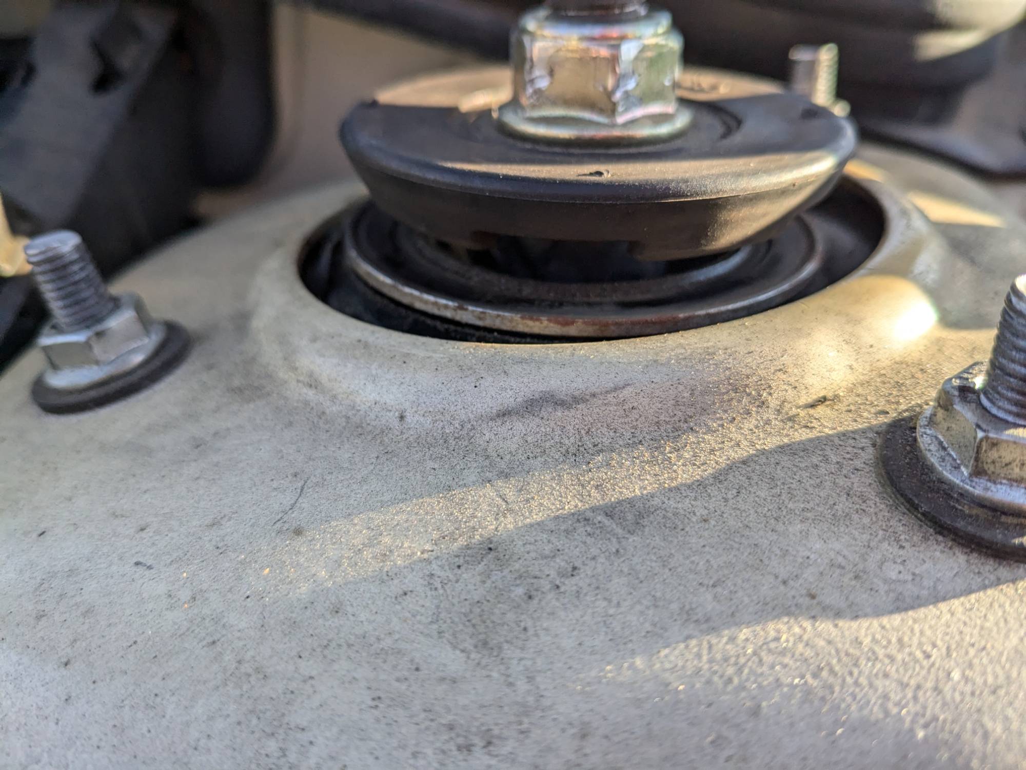

I recently got a 1997 850 T5 sedan. The previous owner said that all it needs is a new PCV valve and upper strut bushings. I've completed the PCV valve and moved onto the struts, however I'm not really sure what needs to be done without replacing the whole strut assembly.
The issue:
While driving over rough road it feels like the strut caps are hitting against the bearing or something. At rest the the caps are raised about half an inch than when the car is jacked up. I've attached pictures of the before and after pics of the strut caps below. It also looks like the struts are slightly off centered and I am able to turn the bolt by hand. I jacked the car up to take the wheels off and raise the strut a little to see how freely it moves but with the front end on jack stands and the wheel off, I couldn't compress the strut without lifting the car off the jacks. (I jacked the strut by putting the jack on the end of the control arm as close to the break disk as I could.

Yup. The top rubber spring seats look like they are separating. The only way to replace them is to remove the struts and replace the spring seats. Go with SACHS, Lemforder or OE Volvo parts for the spring seats.
