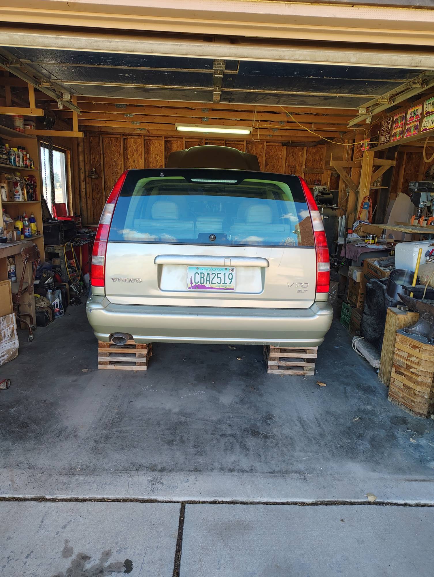

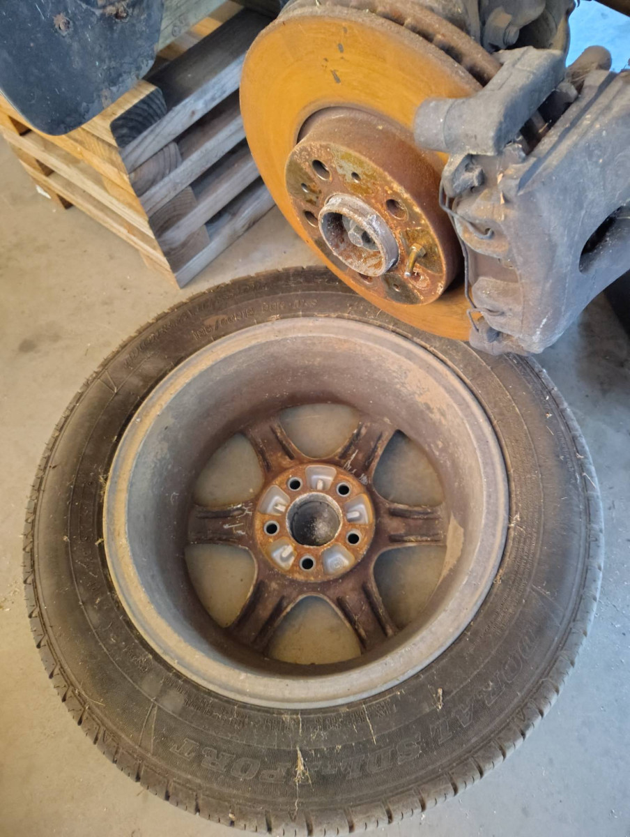

Well I got it up on the wheel cribs in preparation for the oil pan removal.
The wheel was actually rusted on ( no small feat here in AZ ) and I had to use a crow bar to pry it off.
Engine compartment is cleaning up nicely. Need lots of wire loom....

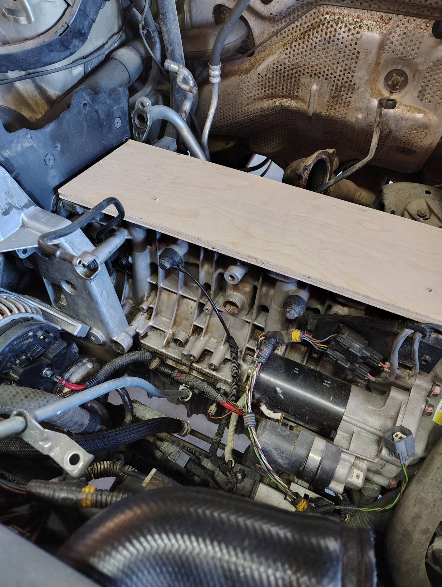

Be sure to find High Temp wire loom, so it will last longer.

That loom covering is a standard fair I have found. I have spent many hours recovering the looms on old Volvos with crusty wiring covers.
I am amazed at the engine bay pictures. Have you done a lot of cleaning there before the photo? It looks cleaner than any engine bay and front of the engine I have seen. Project is moving along great it looks like!

Love that billet plywood head.
Note: on the wiring loom. Mine is in decent shape, but every time I look at a P2 at the auction it's barely there.

Yeah I wanted to make sure no critters made a nest in one of the cylinders while I had it outside.
The engine looked like it had never been cleaned, so I hit it with repeated sprays of hot water w/ dish detergent and let that soak. Putty knife and wire brush. Then followed that up with some throttle body cleaner.
I have found high temp wire loom online, but in 100ft lengths. Since I want 3 different sizes of loom, I'd end up with 300ft of the stuff ! Just a little bit more than I think I need.

I got some off Amazon in shorter lengths. Not as good value as the longer lengths but like you, I did not want a bunch left over.
I don't know if this is available on Amazon in the US, and if the link will work when posted.
https://www.amazon.ca/dp/B092ZB365R?ref ... title&th=1
I found it on Amazon.com:
https://www.amazon.com/ZhiYo-13ft-1-13f ... F0aWM&th=1
