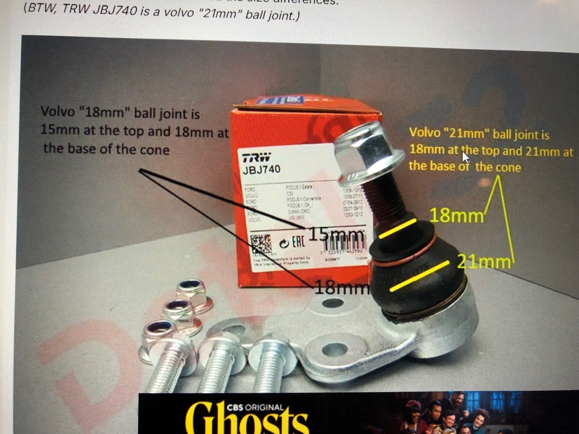

Answering my own question.
Volvo ball joints of the V50 come in only two sizes small and large.
Small means “18mm” for aftermarket makers. That’s 15mm size on the top of the LBJ boot and 18mm at the bottom of boot.
VOLVO calls their larger size “18mm”. But they really mean 18mm at top size and 21mm diameter on the bottom of the boot.
Weird but I cribbed this from SwedeSpeed forum.
So this generic (small) size is what I’m gonna chase for a replacement boot.
