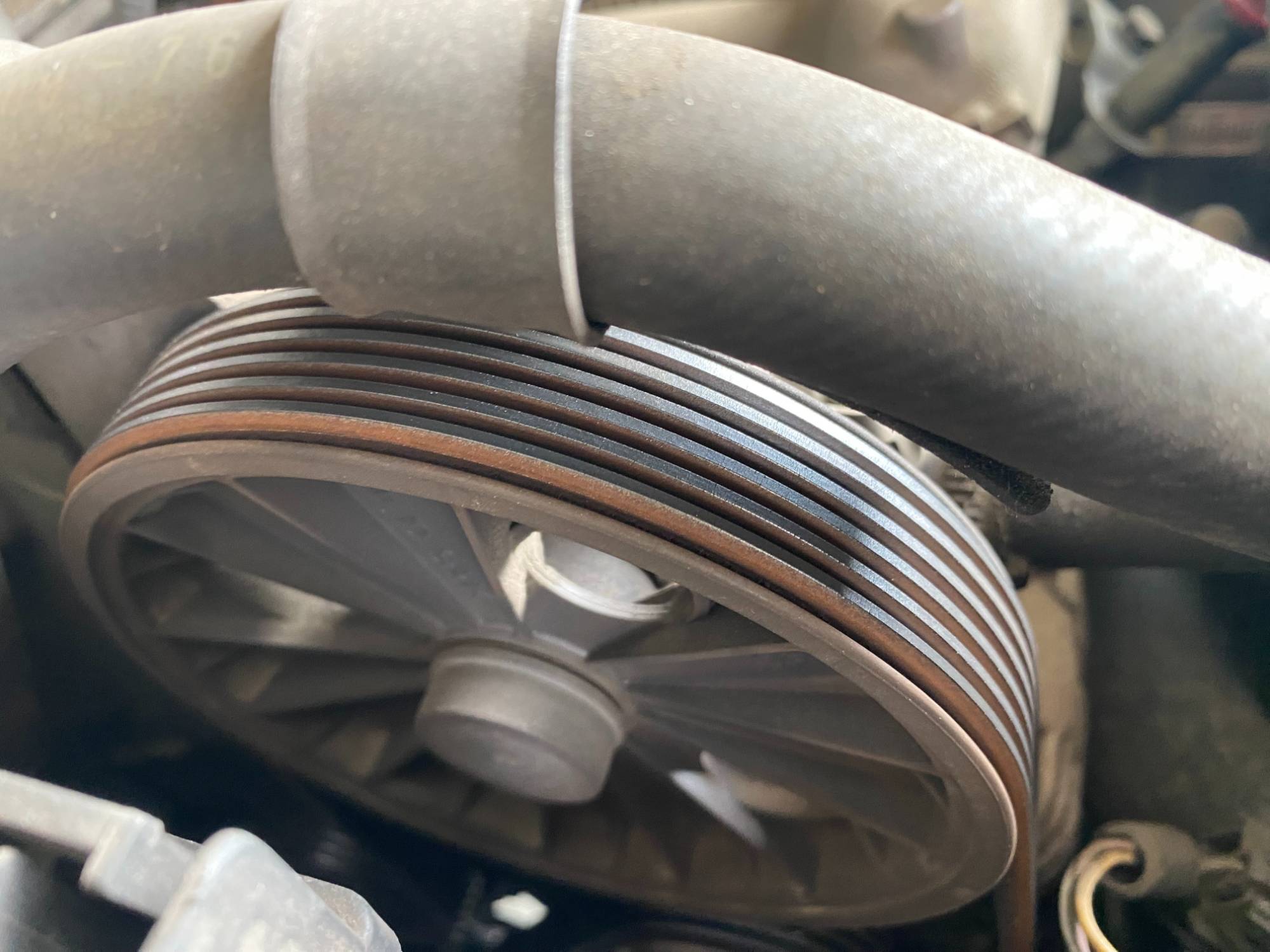

Belts looked OK to me. Feel free to tell me what I don't know yet.

The timing belt looks ok, but it's the tensioner that fails. Check your records for age if possible.
