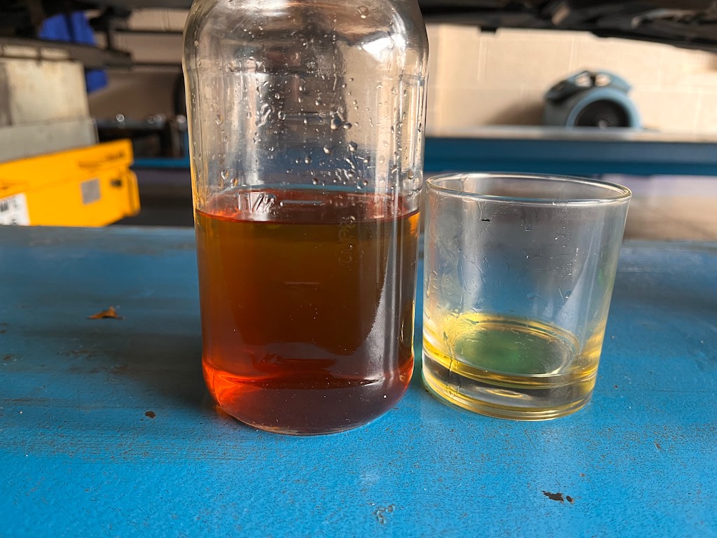

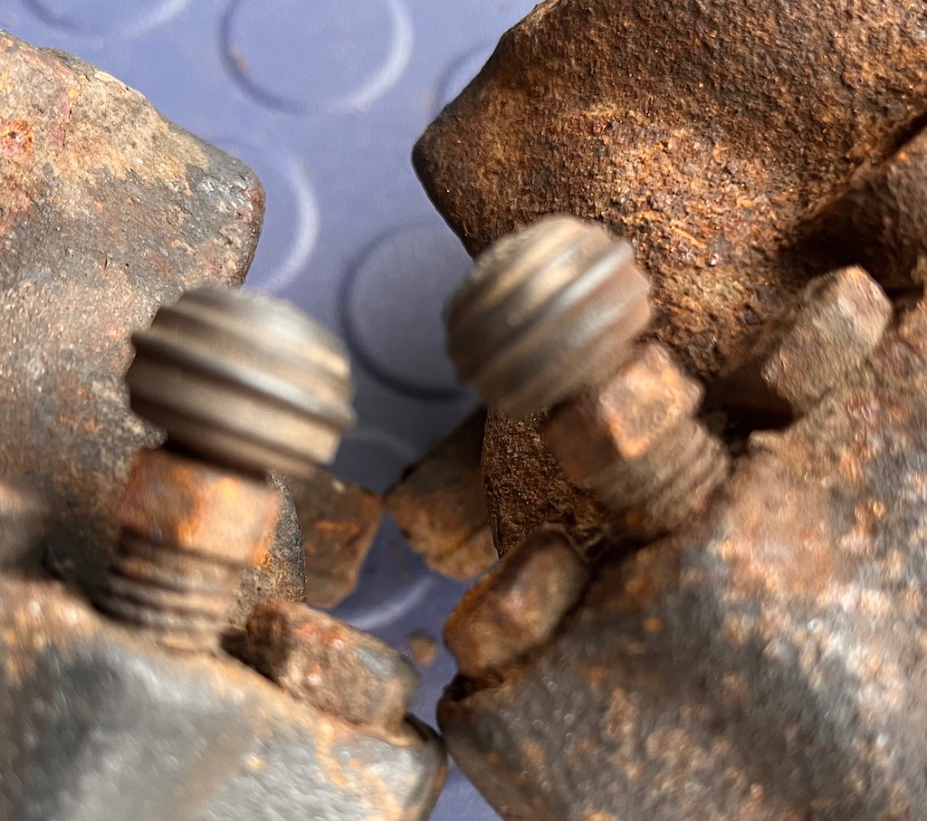

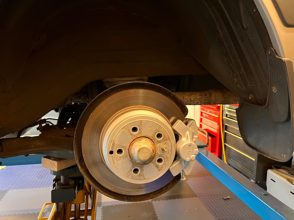

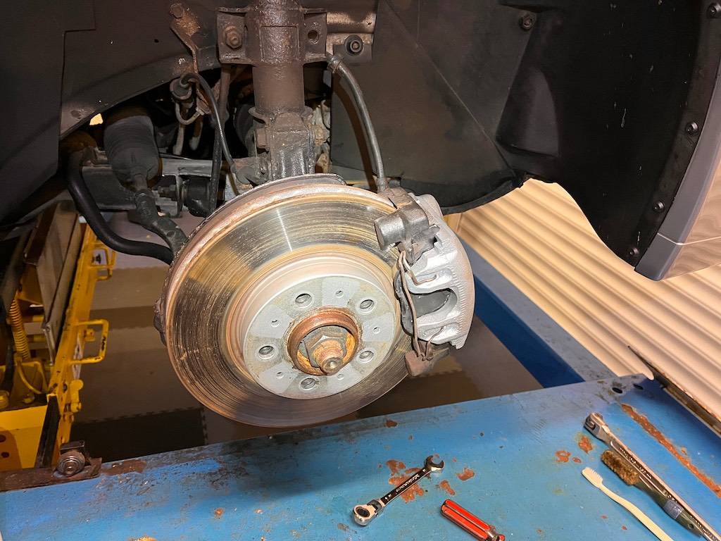

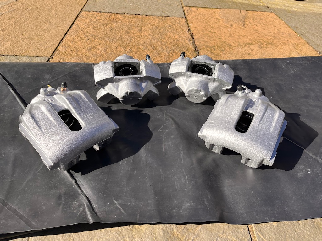

Changed all 4 brake calipers, the ones on the car are 28+ years old and starting to stick a little and I really needed to change the brake fluid.
I ordered the calipers on Wednesday evening and they arrived Friday. They are coated in the usual shiny plated silver crap that never lasts, so today I gave them a coat of high temperature silver paint. I've never flushed the brake fluid on Val and as far as I can see on the service records it was last flushed in 2008 so well overdue. The reason I never flushed the brake fluid which is very dark and probably full of moisture is I didn't want to contend with seized bleed nipples which have a tendency snap.

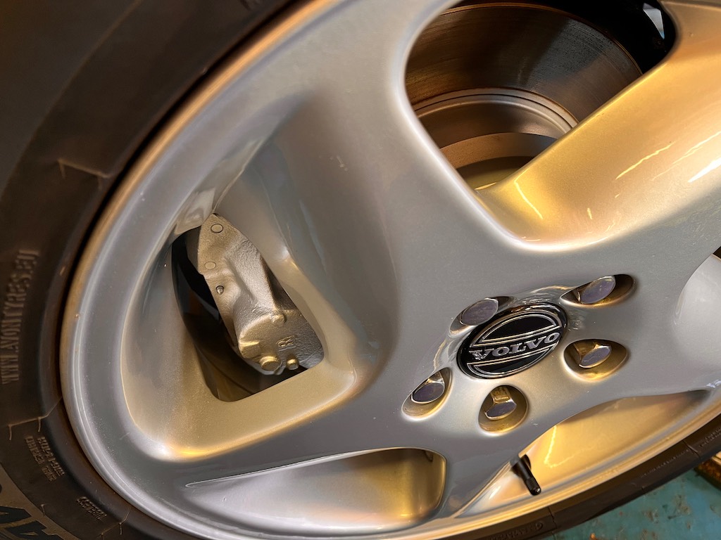

Once the paint dried I swapped out all 4 calipers and gave my Columba wheels a clean before refitting them. Brakes are all bled with DOT4+ as per specifications.

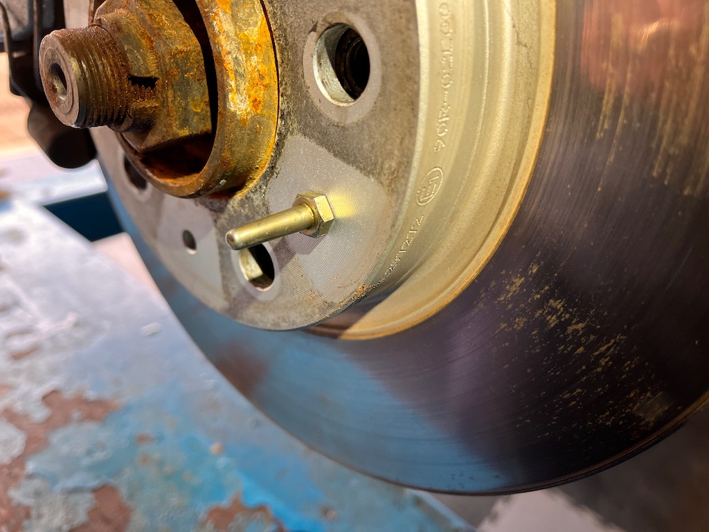

While I was in at the front discs I fitted the factory locating pins that were supplied with the car. These have been sitting in the boot since before I purchased the car, I had fitted the rear pins 5 years ago when I changed the discs but forgot to do and never got round to fitting the front ones.

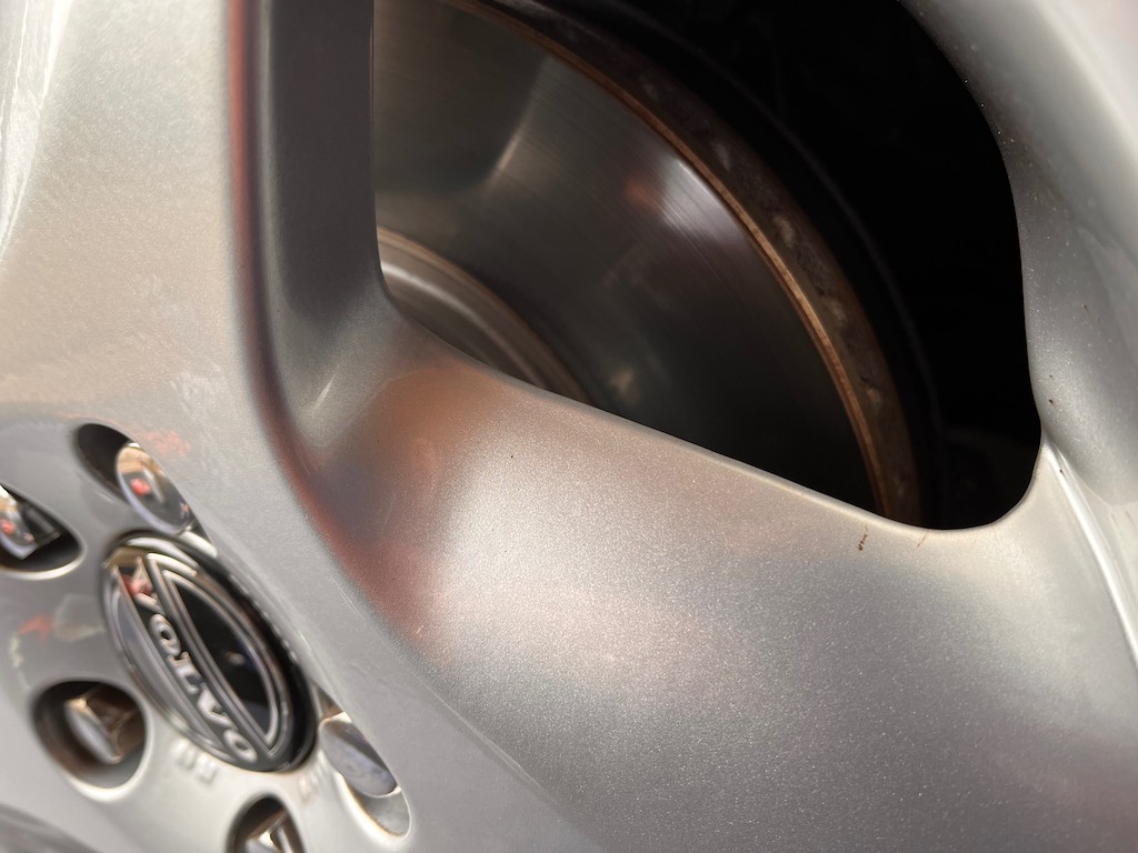

A short drive round the block cleaned up the discs
Brake fluid is now clean and moisture free (I hope)
Before and after (2008-2025)

Shiny! Nice and shiny. Luvverly!
I'd say that brake fluid is long overdue. Whilst not as long overdue, I have 3 cars to flush their brakes and cooling systems this year, Great!
I throw away those pins as I don't use P80 wheels on my P80 and replace with regular M6 10mm headed bolts. I have a bunch of those pins somewhere never to be used!

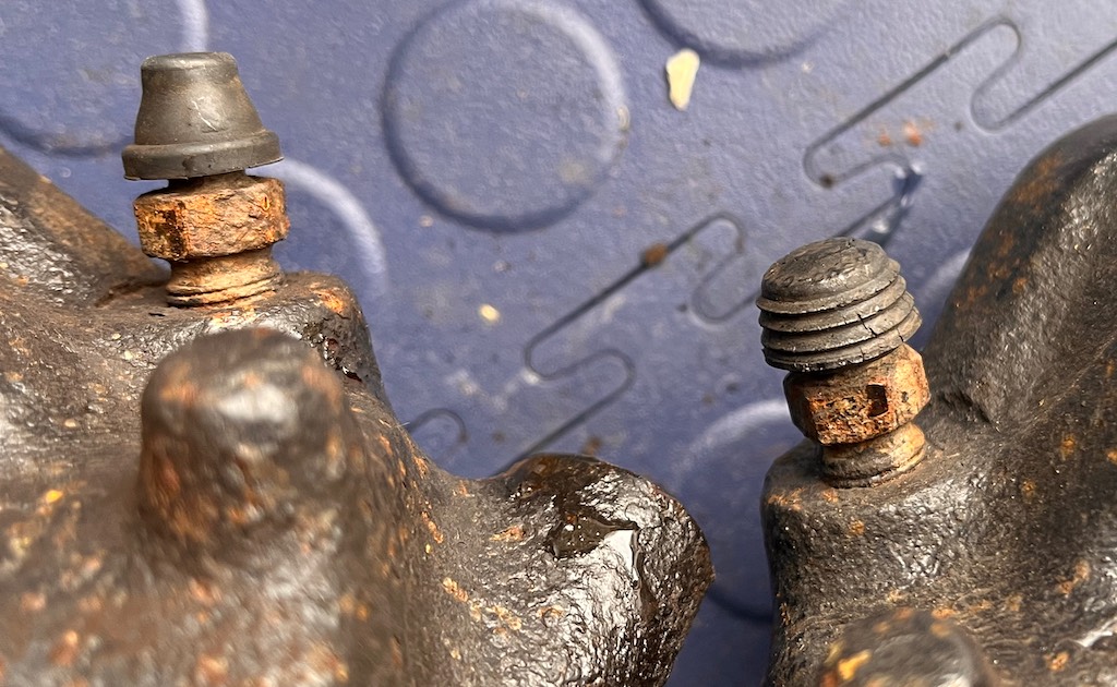

The brake fluid was nasty scot850 and it's been on my mind since changing the V70 fluid last year. I decided to try and get the bleed nipples loosened on the old calipers and to my astonishment every one of them came out with a bit of gentle persuasion and no heat required. That really did shock me!!!

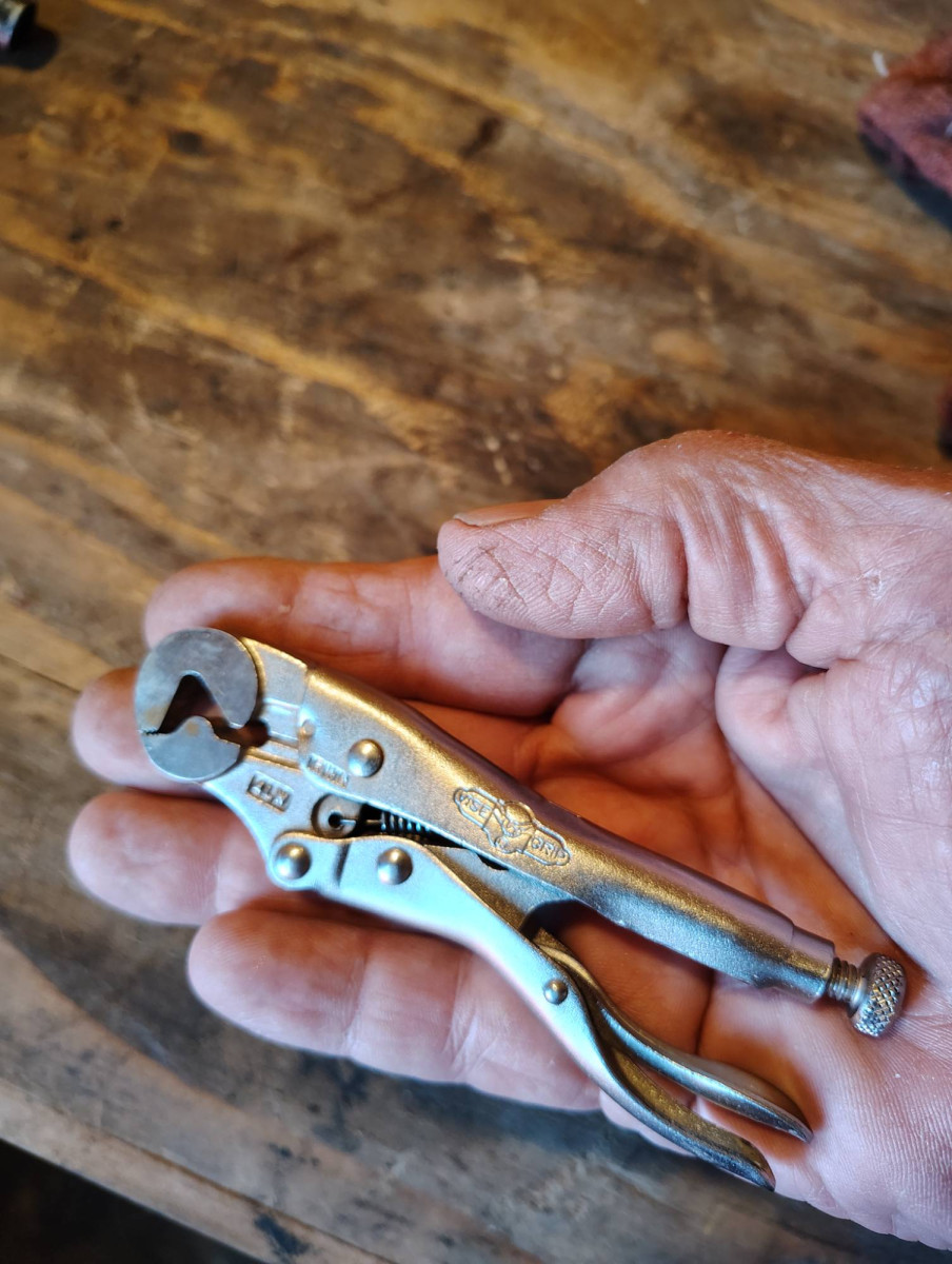

I won't approach a brake bleed nipple without these in hand.
