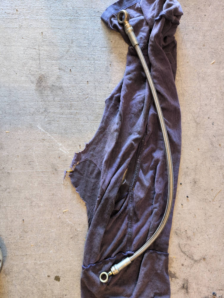

06 V70R automatic (IPD 3rd Stage) (I bought it after the upgrades)
Can someone please help me with a part number for this Oil Line from Top of Turbo to passenger side backside of block. Banjo bolts on both sides. Turbo side is 14mm. Block side is 19mm. Line is a bit flexible & metal mesh, I am guessing a special (non original part)...
Thank you,
Nathan
Turbo oil line? Part #

Hm. I looked at a couple of sites and one shows it correctly like yours with 2 banjo bolt ends, but the part is not listed which usually means it is NLA:
https://parts.volvocars.ca/a/Volvo_2006 ... 73013.html
However, Tasca show a part for an 06 V70R, but it only have a banjo connector on one end? I think that is because it is actually #15 in the first link.
https://www.tascaparts.com/oem-parts/vo ... wtbDUtZ2Fz
Other sites show the part NLA. Problem is it does not help with a part number to search from.
I'll do some more hunting and see if my old copy of Vida can scare up a part number.

There are places that can easily make that part up, they'll re-use the ends, search hydraulic hose repairs.
O'Reiley auto parts offers free crimping if you buy the parts from them.
https://www.google.com/search?q=hydraul ... e&ie=UTF-8

I looked up my older version of Vida to see if the part number would show to help with trying to track one down. Unfortunately, even on there is is listed as NLA. I think jonesg has the only realistic way forward. Hydraulic shop.
Good Luck!
