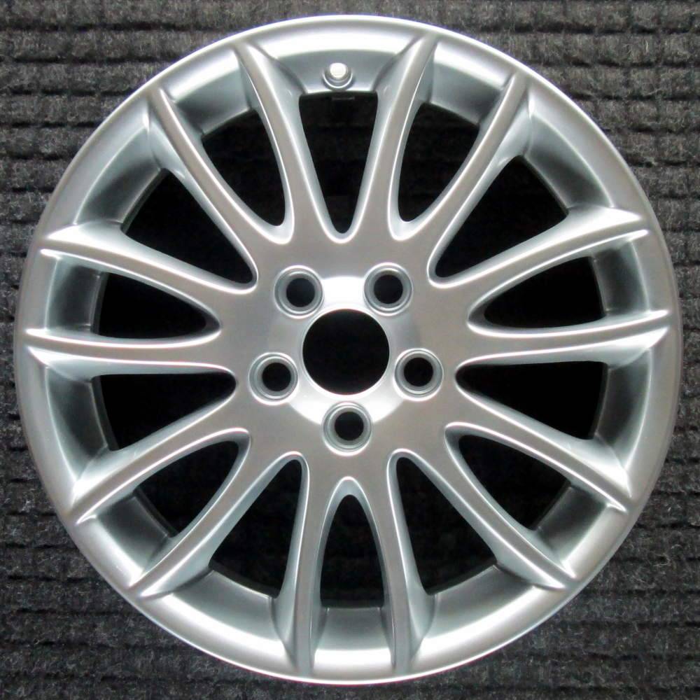

Thanks Eric. Sorry you had trouble matching it. Can you post a photo(s) of your work when you're done?
For reference: https://www.volvodealeraccessories.com/ ... 00995.html
