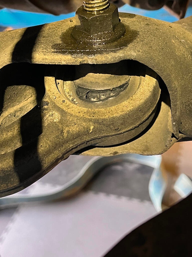

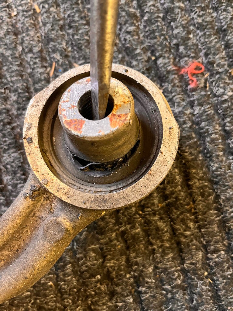

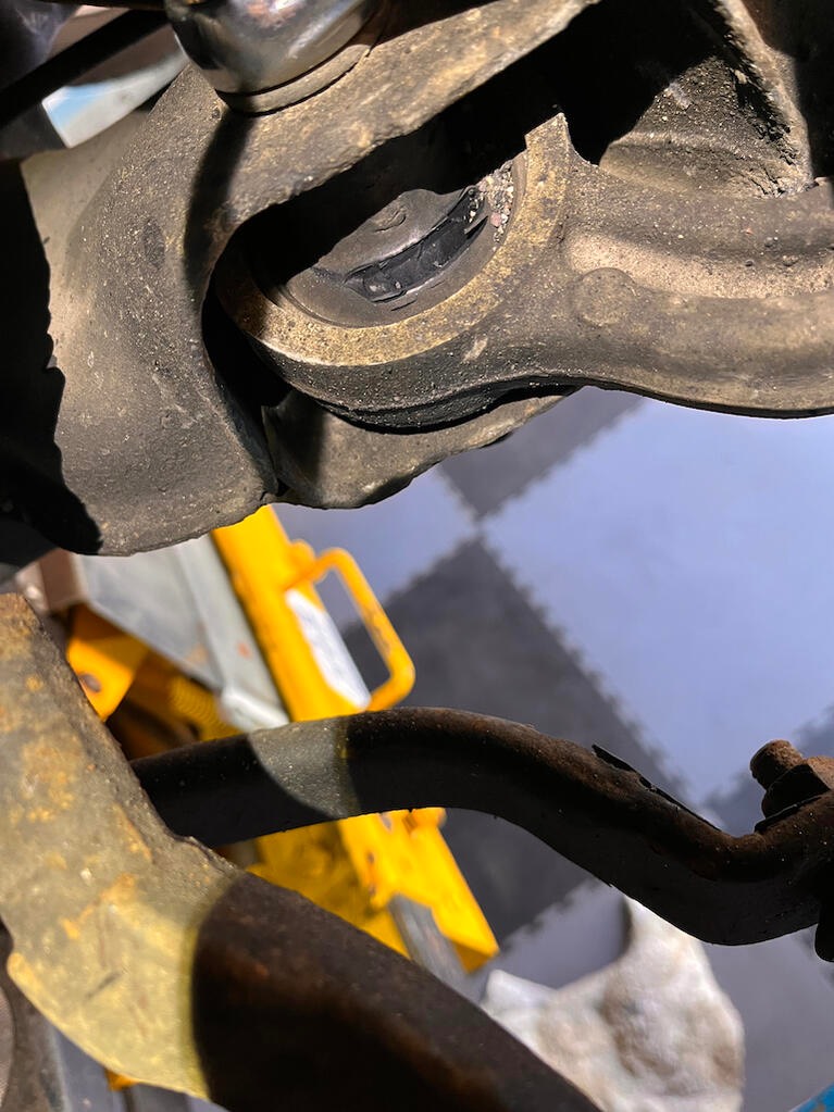

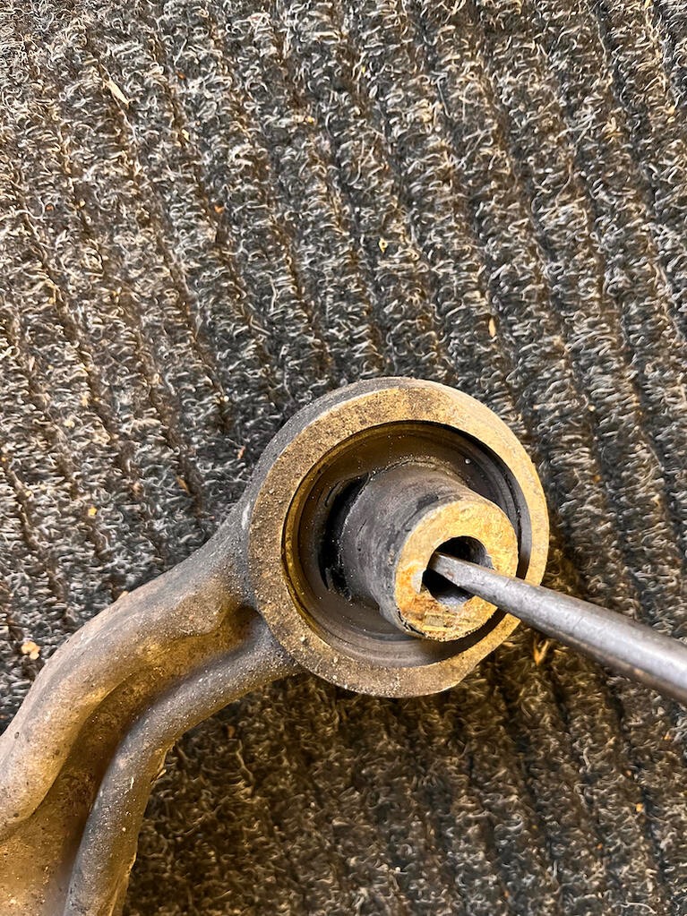

Changed the control arms on Kära today. The original rubber bushes were starting to crack and split so best do them before it's an MOT fail

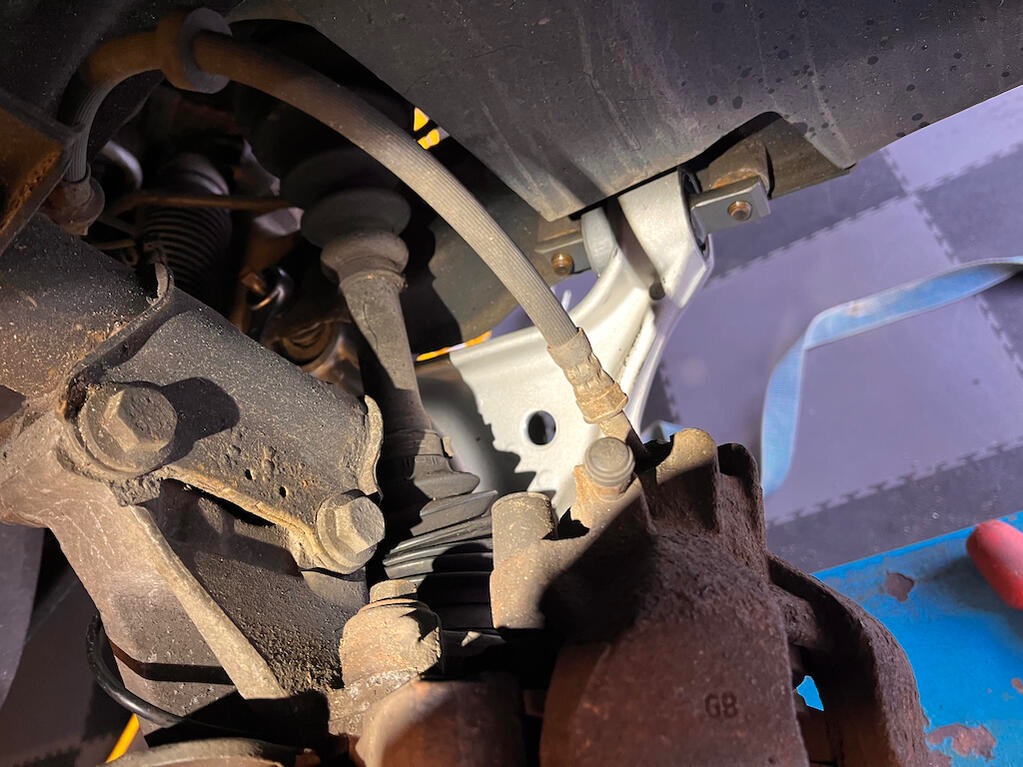

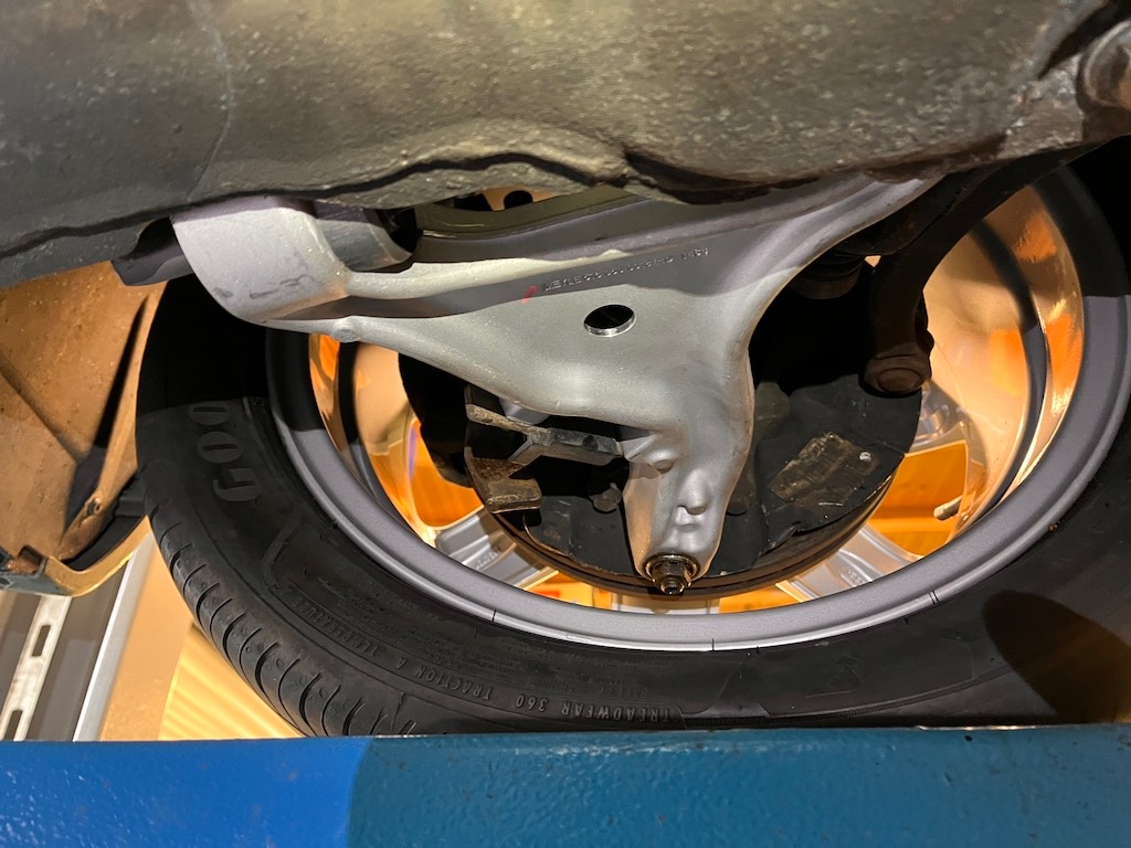

New arms fitted

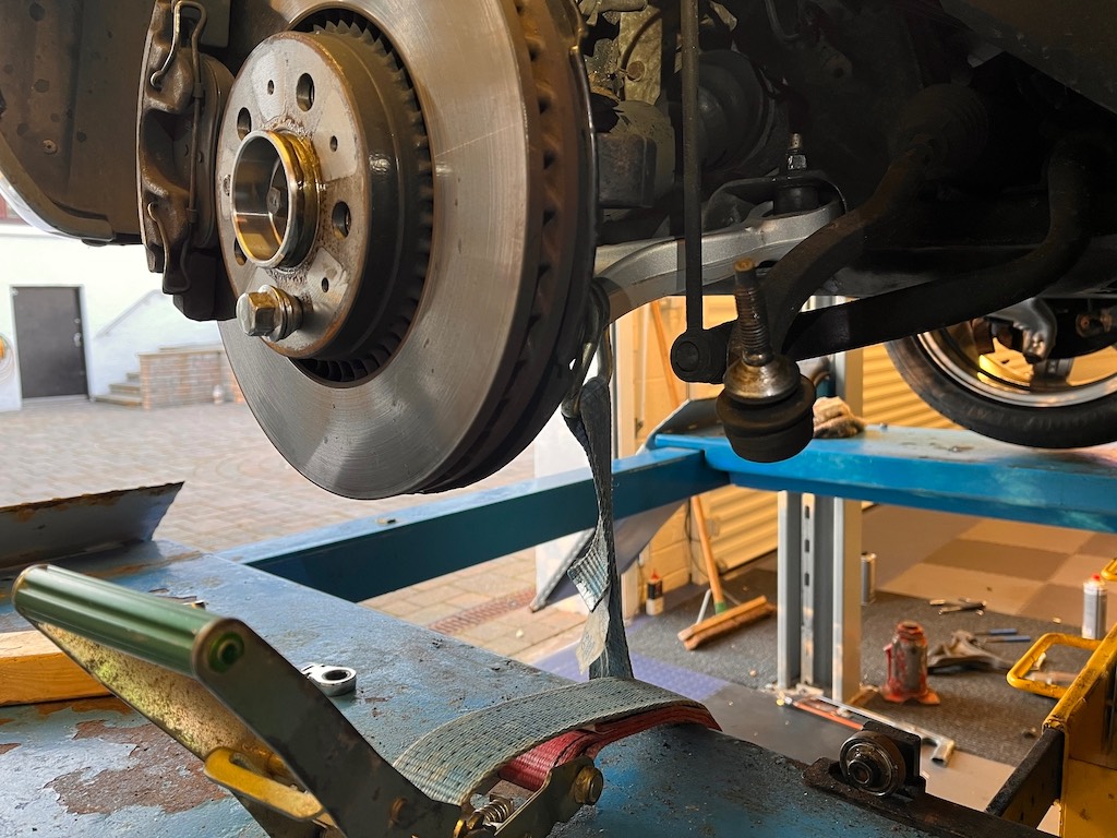

I used a ratchet strap round the ramp bed to pull the arm down to allow the balljoint to slip into place
All buttoned up again

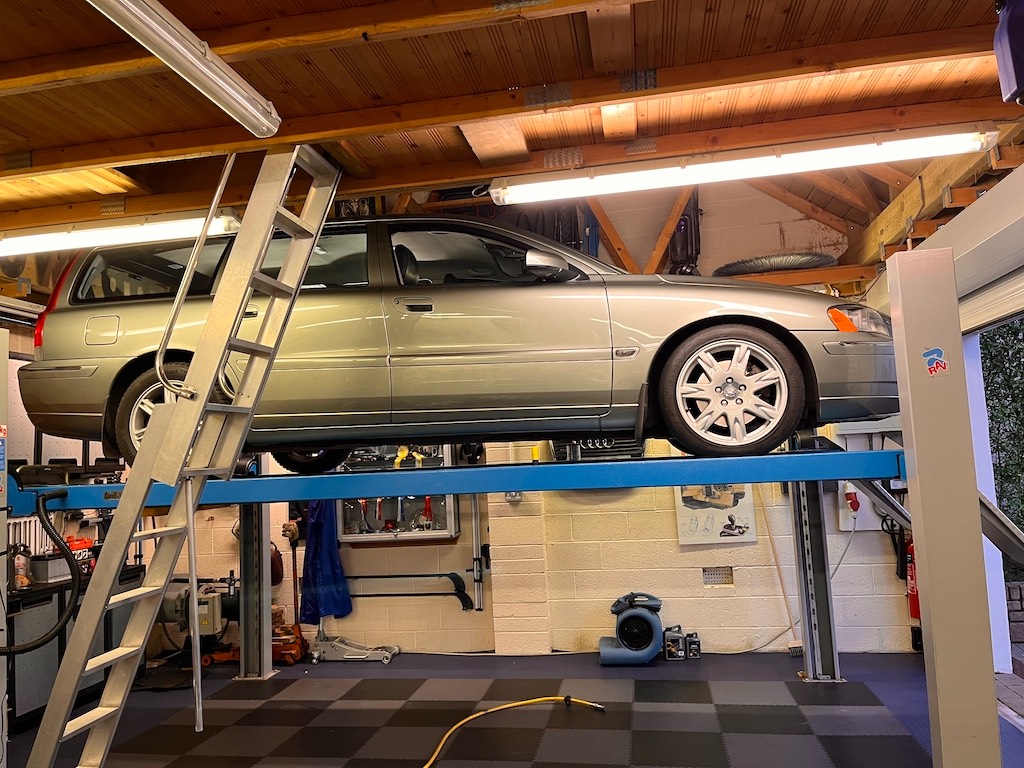

Might as well change onto the summer tyres while the car's on the ramp, front done and will finish off the rear tomorrow before going out for a test drive
