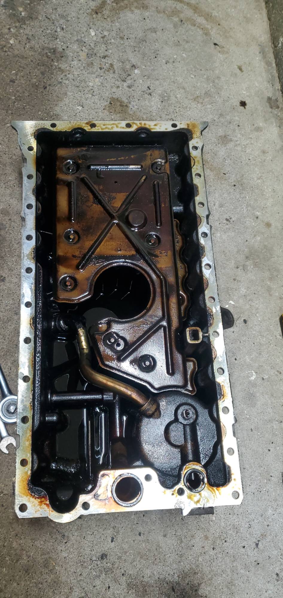

Update. Changed oil and filter 2 days ago, added 5oz sea foam in with the oil. Oil pressure warning came on again 2x today (after about 40 miles driving). I guess pulling the oil pan is next.

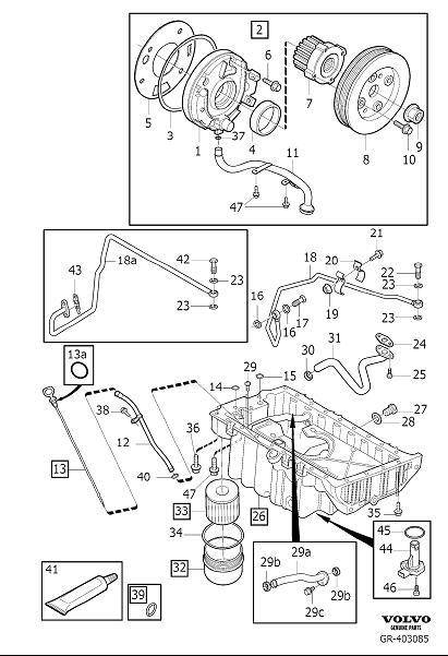

@Krons Thanks! Is the o-ring you're referring to part #37 in the attached diagram?
From https://www.volvopartswebstore.com/show ... Line=11324
- lubrication parts diagram
- 0900c8af86cc75b8_2126_3106_1.jpg (46.22 KiB) Viewed 576 times
- Posts: 35272
- Has thanked: 1497 times
- Been thanked: 3810 times
#14 and#15. Those two orings have to seal to deliver oil up to the head

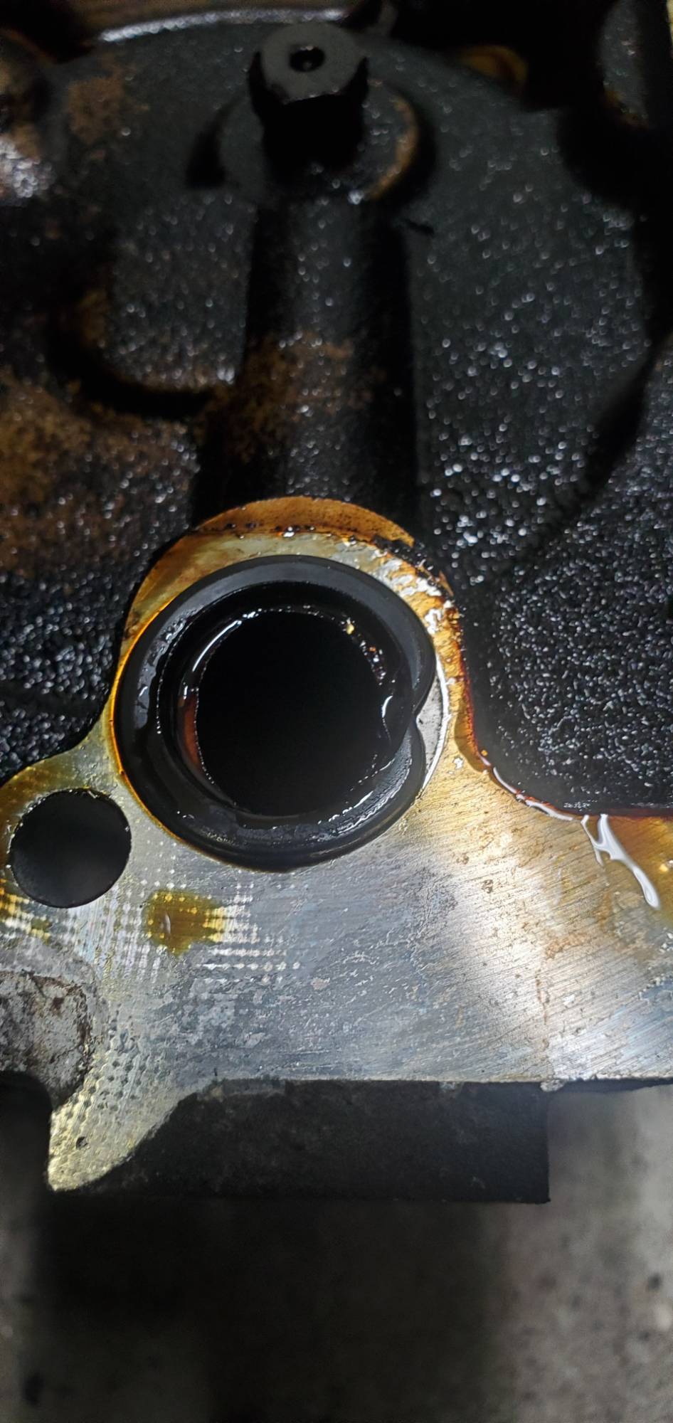

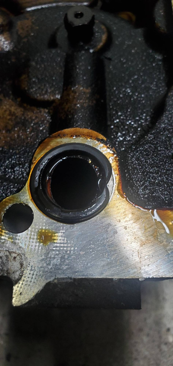

When I pulled the oil pan on my 2007 S60 with over 250,000 miles, I was surprised to find o-ring #14 wasn't installed correctly at the factory:
I had the same problem with low oil pressure on a particularly cold day. No more problem with the o-ring replaced.

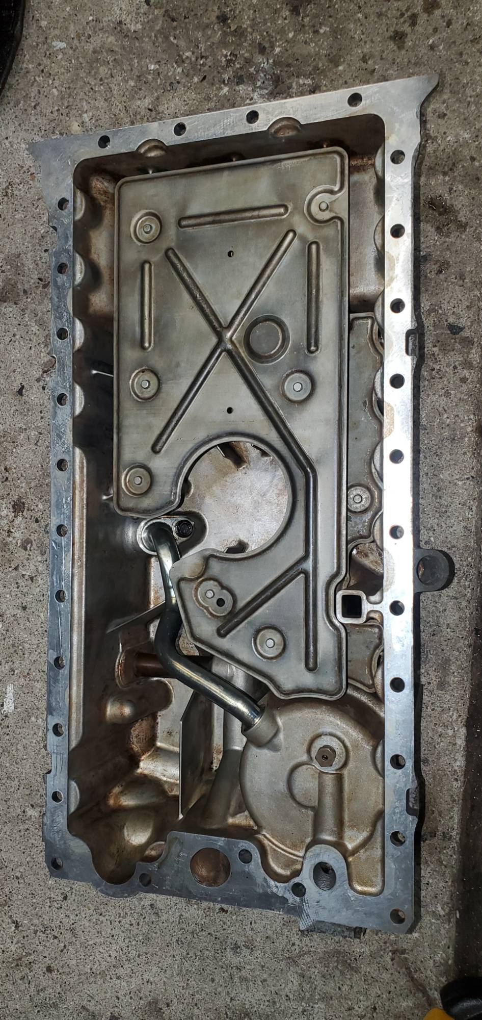

It is also a good time to clean the oil pan and PCV drain passage if you are cleaning the oil pickup and replacing the o-rings. This is the seal kit: https://www.fcpeuro.com/products/volvo- ... -reinz-kit
After ultrasonic cleaning:
