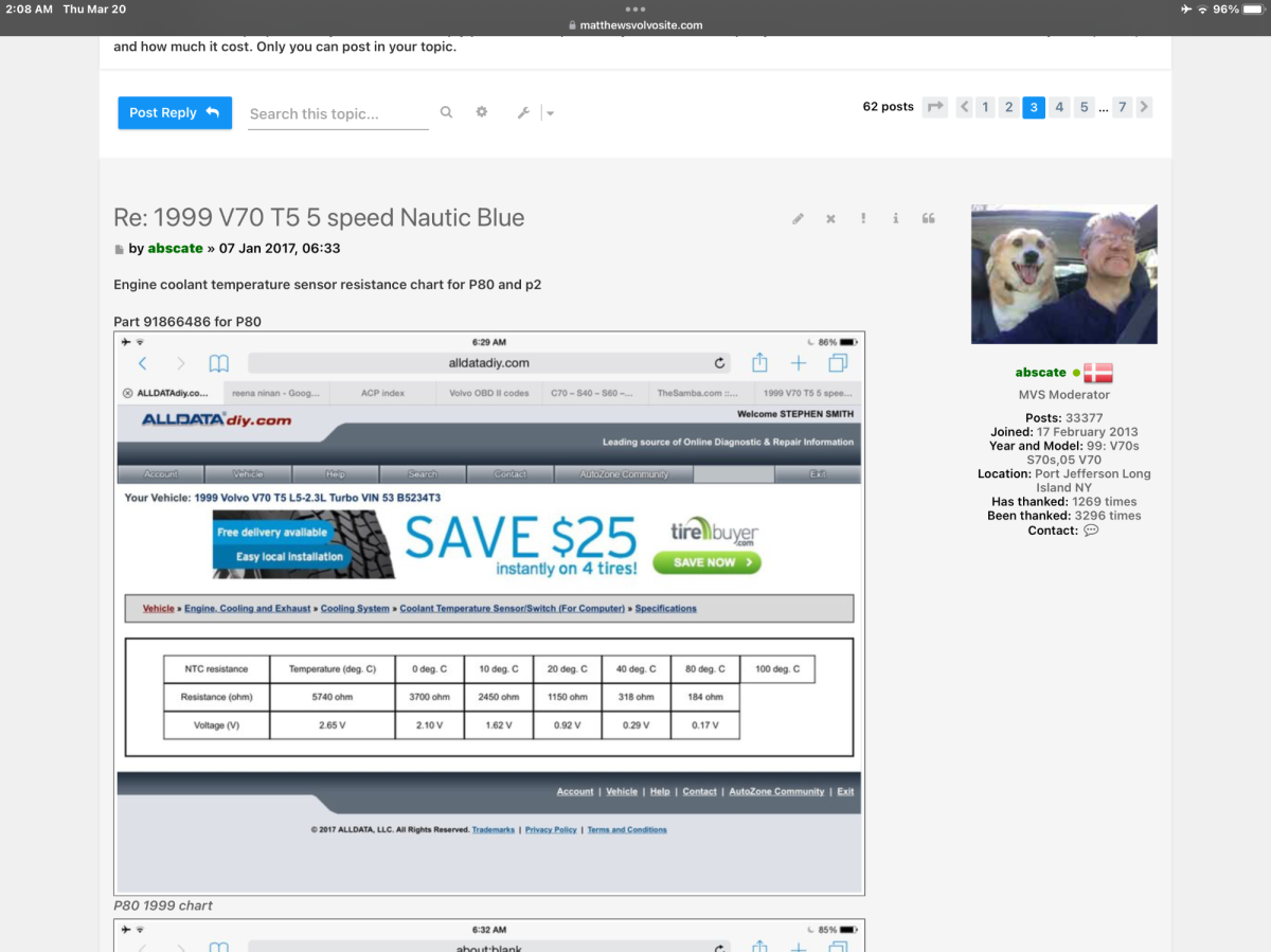

If the temperature gauge is varying it is most likely the coolant temp sensor (ECT) that is faulty. The sensor fails and also the connector near it also can corrode and become flaky. The coolant temp sensor also controls the engine cooling fan.

Resistance specs for the temperature sensor on the 1999-2000 models are here…
Note that the intern who typed it in didn’t understand thst excel sheet columns have to line up. So the resistance data is shifted one block to left .
His performance write up…
