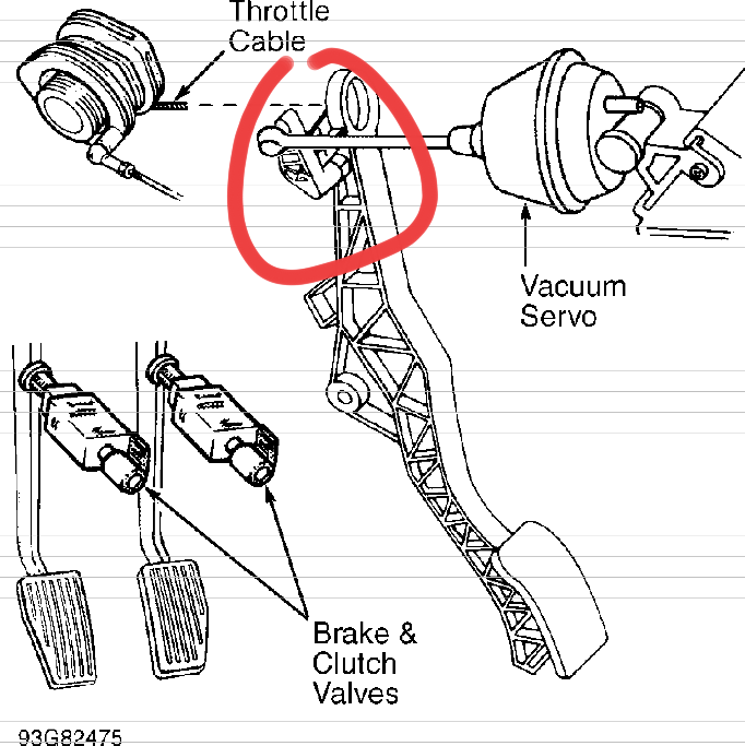

It seems I lost a plastic piece that connects the gas pedal with the vacuum servo. I wanted to fix the cruise control system for a while and just recently found a new vacuum pump but now this. Does anyone have any idea where I can find such thing?
Thanks in advance
This is missing
This is missing

Junkyard.
I replaced mine last year because it broke when i engaged cruise control on highway.
It seems that i installed it wrong when i was removing dash for ac evaporator & heater core replacement.
