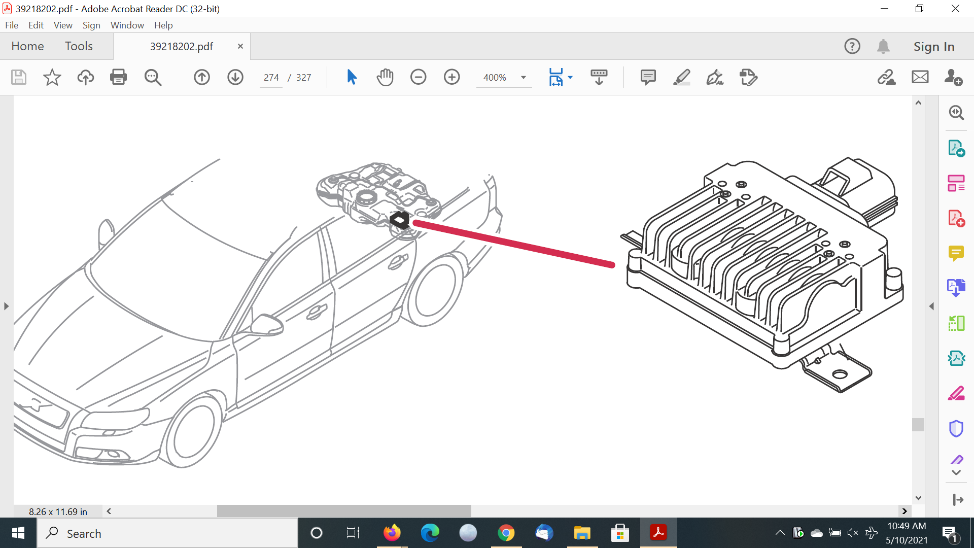

teebee wrote: 04 May 2021, 03:54 Hi, I'm Cyrille 46 years old, from France. My volvo is S60 of 2012 is broken down for several weeks :cry: , I'm looking for the PEM. I disassembled a lot of things believing that it was in the back. It was just told that it was in the front, towards the front right seat, but where exactly? Under the seat or behind the glove box?
On the P2 S60 PEM is under the second row seating ( Right side ). The Fuel tank is under the second row seat of a P2.
It is not clear where it is on the P3 S60. Either inside under the second row seating ( Left side ) or outside above the left front corner of the fuel tank. Might be inside near the C pillar.
