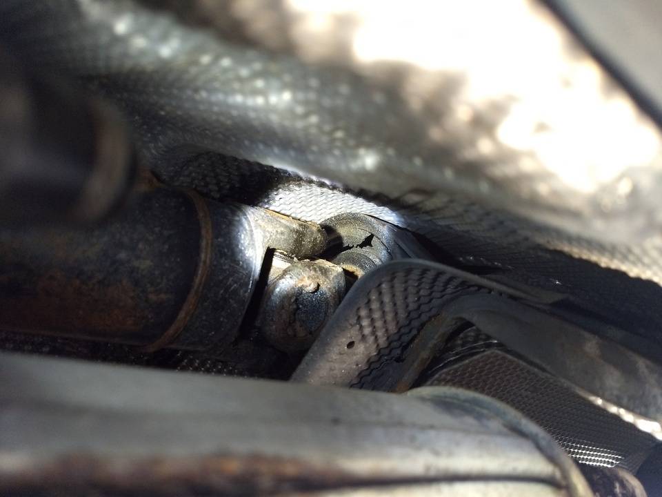

Warm, dry day, after week of cold and rain, and before week of cold and rain. Sneaked under to check it is really the driveshaft that clicks under the console. It is... U-joint spew grease, vibration destroyed the rubber. Or vice versa. Anyways, I think I'll bite a bullet and get this Dorman driveshaft: https://www.dormanproducts.com/p-77824-936-876.aspx Quality maybe lower than OE (but who knows), but at least it is fully serviceable.

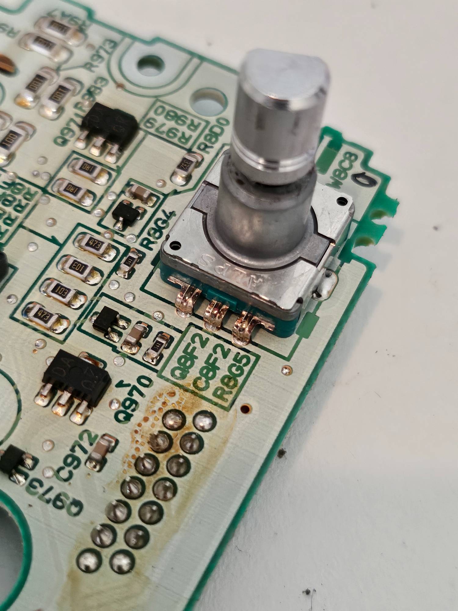

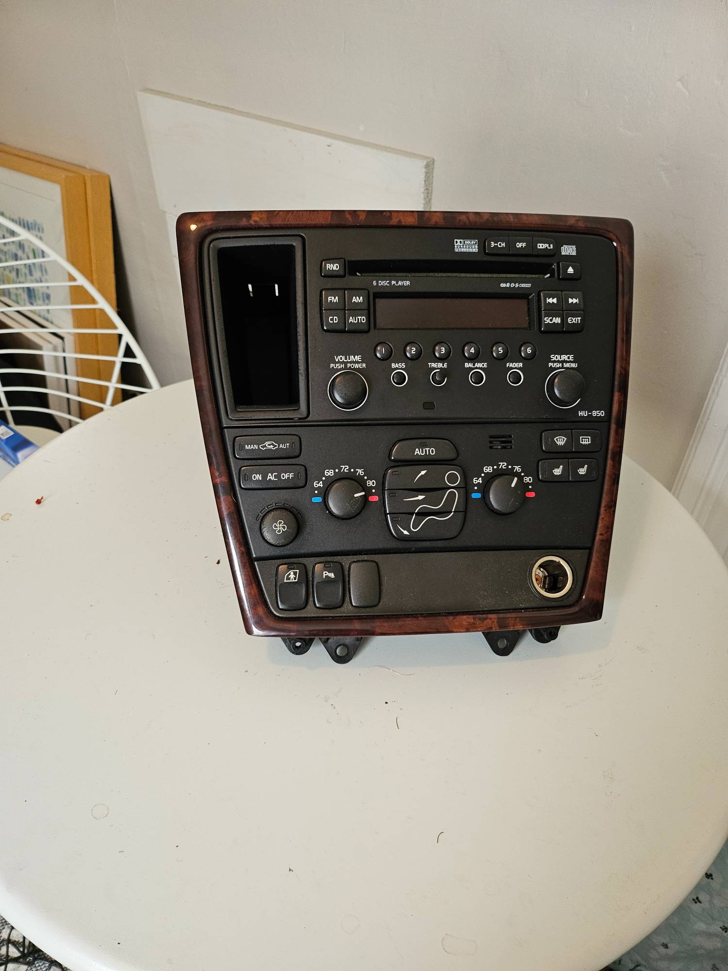

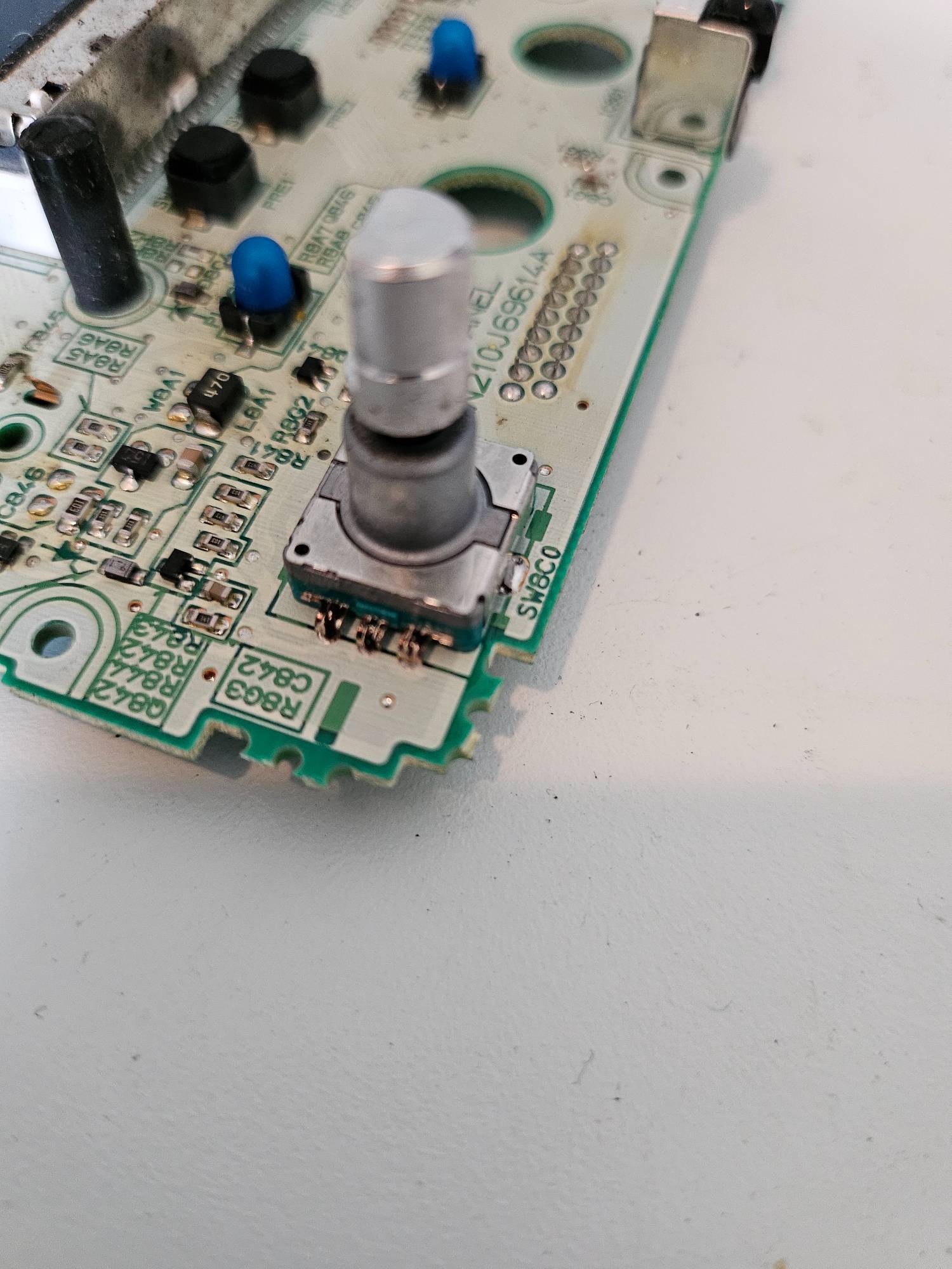

yesterday i took apart my radio + ccm to fix two intermittent knobs: volume, and fan speed. volume never worked and fan speed tended to skip a tick or go backward a tick (relative to intended direction). job like this makes me very glad i have VIDA to clear the SRS warning that comes up, since the CANBUS line for the airbag runs thru the radio and ccm (very weird design decision- disables airbags and remote/central locking when removed).
i felt like i was at my job doing this solder work! i'm a part-time repair tech at a local retro games store, i work on old Nintendos mostly.
pics of the knobs before any intervention: example of bad joints (first; volume) and good joints (second; tune/source).
just applied some liquid flux (honestly closer to gelatin or a jam than liquid) and added a small amount of solder until the joints were mostly silver on the surface. the volume knob worked great after this, and the fan speed knob was much closer to perfect. i think to improve this, i would have tried to remove the gunk on the joints- seems to be from factory no-clean flux or something? it didnt act/look like oxidization so i wasn't sure. it stayed there as i applied fresh solder and made it harder to make it "look clean."

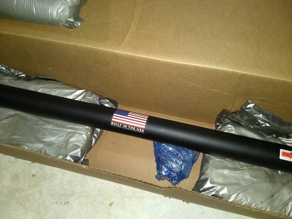

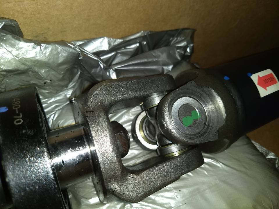

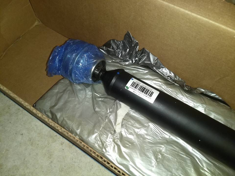

It's here. Visual quality is very high. Fully serviceable, U-joint is bigger. Driveshaft itself is bigger and heavier, too, which would perhaps affect car's snappiness and collar sleeve's life span.vtl wrote: ↑28 Mar 2025, 19:12 Warm, dry day, after week of cold and rain, and before week of cold and rain. Sneaked under to check it is really the driveshaft that clicks under the console. It is... U-joint spew grease, vibration destroyed the rubber. Or vice versa. Anyways, I think I'll bite a bullet and get this Dorman driveshaft: https://www.dormanproducts.com/p-77824-936-876.aspx Quality maybe lower than OE (but who knows), but at least it is fully serviceable.
Unfortunately, I'm under weather and can't install it yet.
