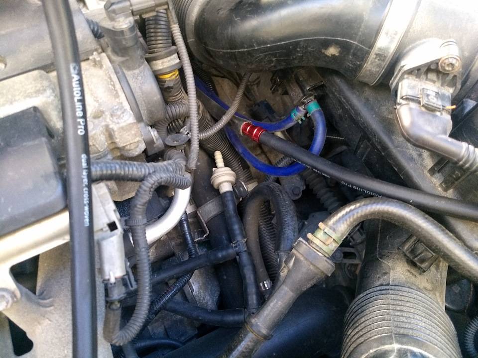

Ordered smoke tester, should be here tomorrow afternoon.
Questions for all:
- Any thoughts on best place/port to inject "smoke"?
- Also, how concerned should I be about fouling the MAF sensor by blowing "smoke" into the turbo inlet pipe?
- Possible that my tightening the O2 sensor actually cracked the exhaust manifold loose or something and that's where the air is coming from?
The thing that keeps me confused is that the little things don't match here.
- Stepping on the throttle didn't cause the running to smooth out, it led to misfire codes
- Also, when stepping on the throttle, the short-term fuel trim stayed pegged to max
I would expect that for any non-obvious vacuum leak, adding throttle would smooth it out, and also cause short terms to fall at least a little, yet here we are and I've had eyes and hands all over all that stuff and can't see where the leak might be.
Any other brainstorms while I wait for smoke tester?
