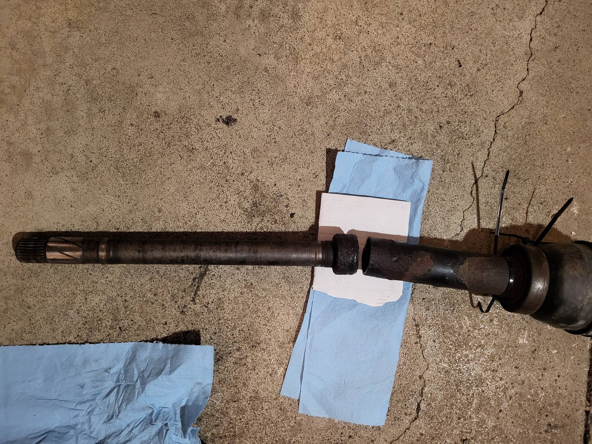

When your CV axle is made from 100% pure unobtainium, this is the last thing you want to see. Yes, this is the dreaded front right axle from an '04 V70R M66 AWD.
The only axle I could find (period) that might work is the Trakmotive VO-8041, despite unclear fitment information. I'm going to give that a try, unless someone chimes in and says I definitely should not.
The good news is that the transmission and angle gear are still in great shape (had to drop 'em to check). And the "while we're at it" list included new front subframe bushings, prop shaft front CV (torn boot), angle gear collar and seal kit, engine & transmission torque mounts all around, lower ball joints, and fluid replacements.

Is that axle a tube vs solid on the R font weight reduction? Iโve never seen an axle snap like that.
Is that awd m66 ftom Canada or is it a conversion? We didnโt get awd m66 in the States TTBOMK
Yeah, the shaft is (was) a tube between the angle gear and the inner CV joint.

Just wanted to confirm that the VO-8041 is a perfect fit for a passenger side M66 AWD axle, I just put one in last weekend. The inner joint is a different style but the length and position of the support bearing are the same as the old stock one.spinard wrote: 12 Apr 2025, 17:47 The only axle I could find (period) that might work is the Trakmotive VO-8041, despite unclear fitment information. I'm going to give that a try, unless someone chimes in and says I definitely should not.
