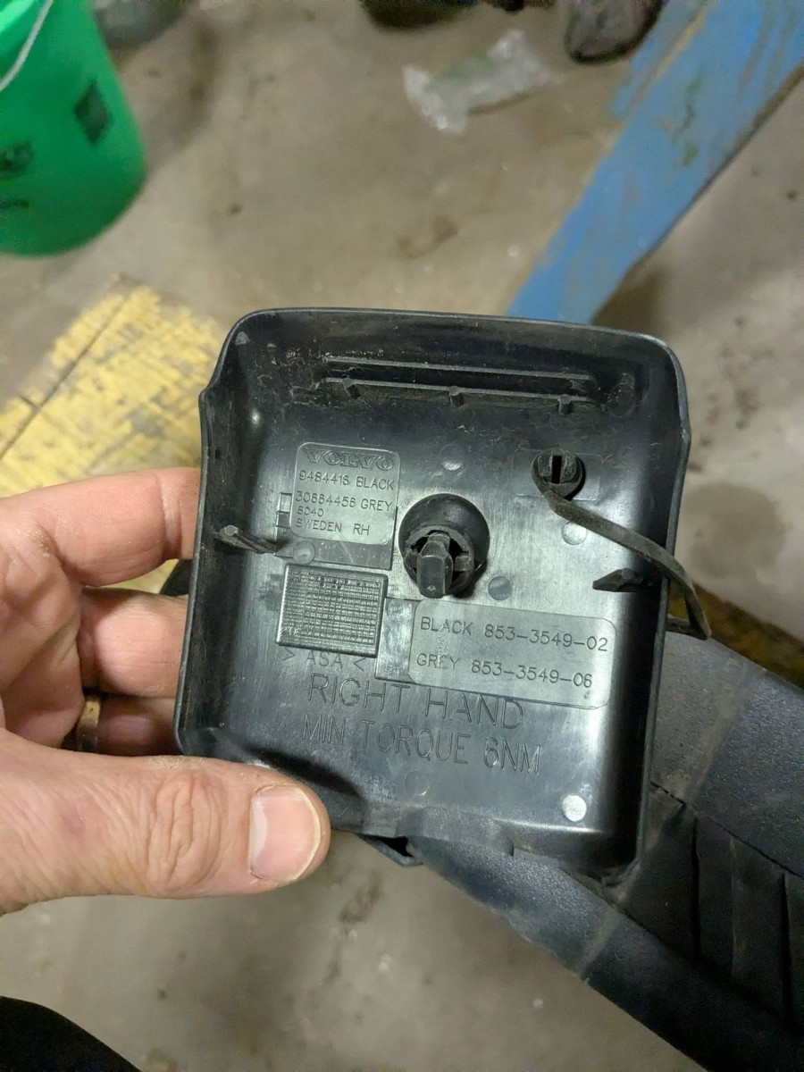

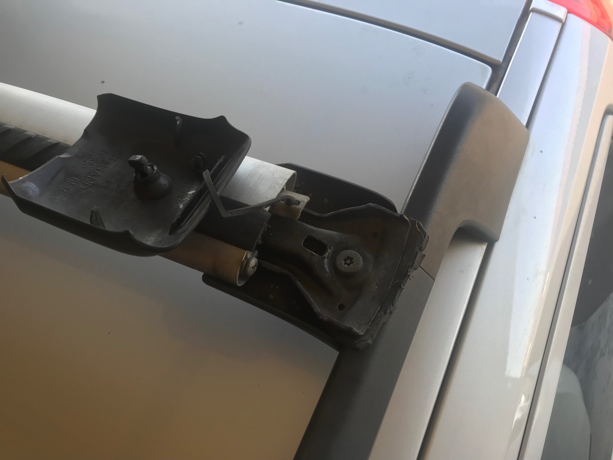

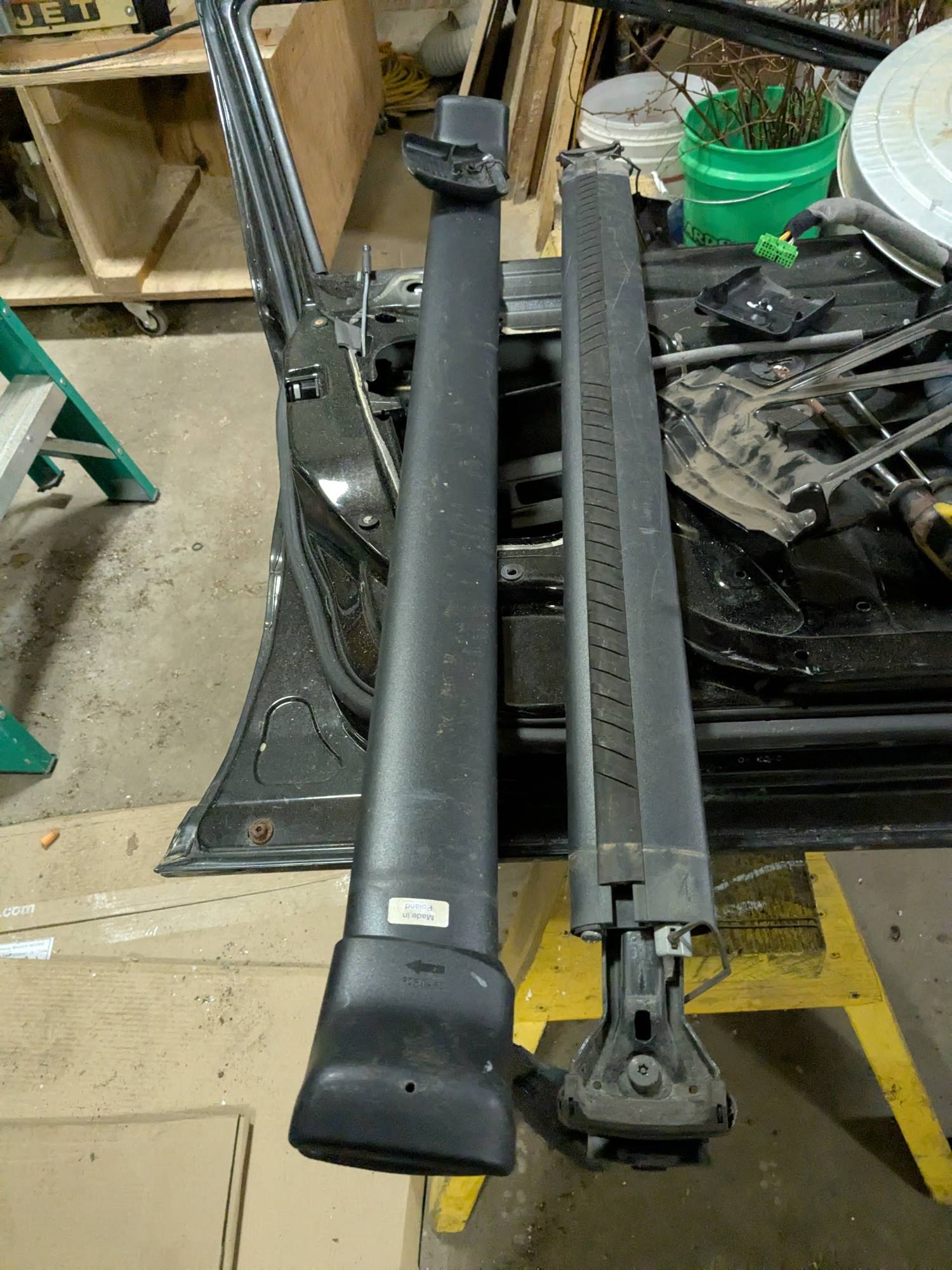

I picked up a pair of roof rack "load bars" at the Junkyard today from a 2002 xc70 Ocean Race wagon. The obvious part numbers are:
9484416
30664456
853-3549-02
853-3549-06

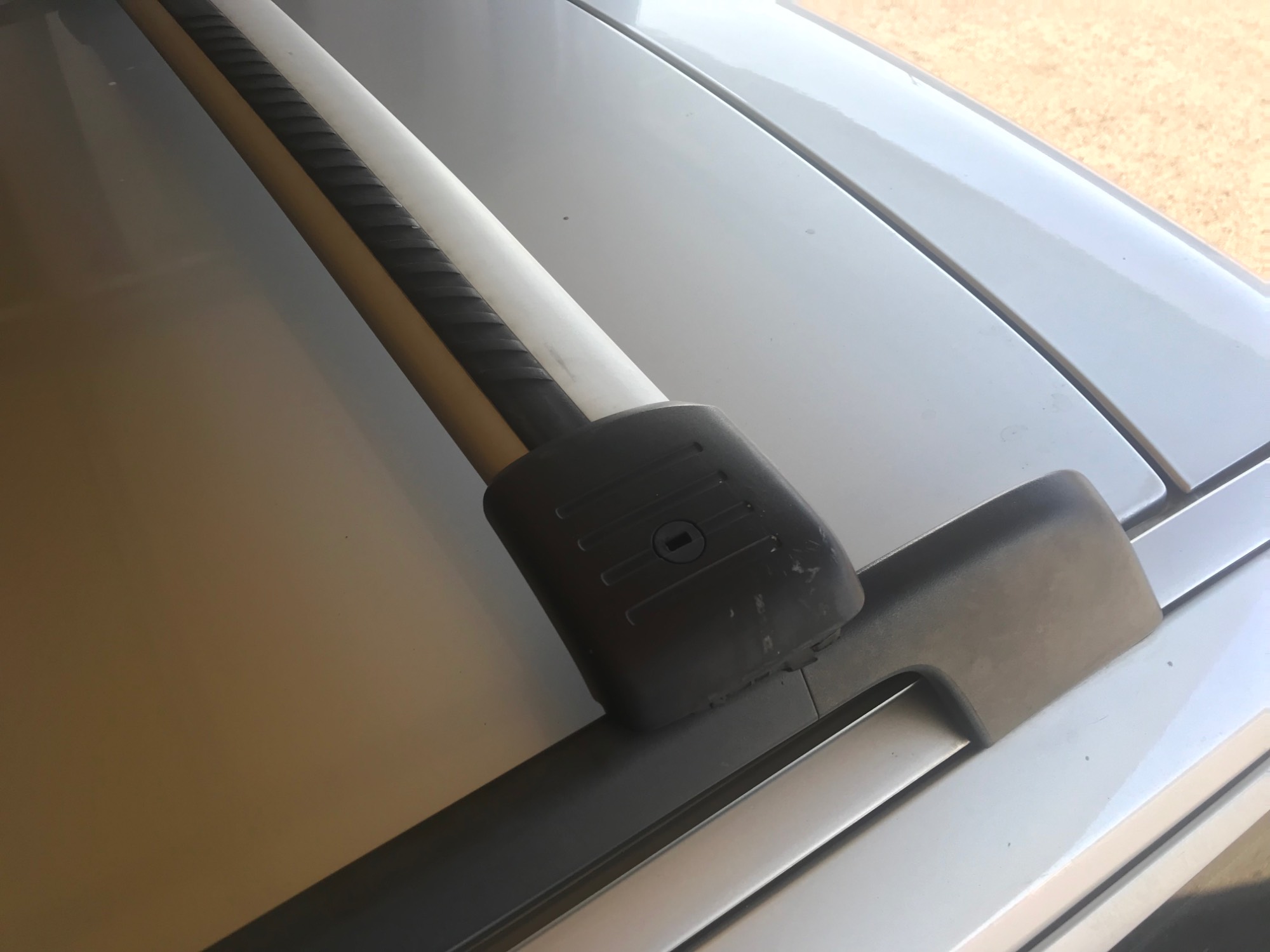

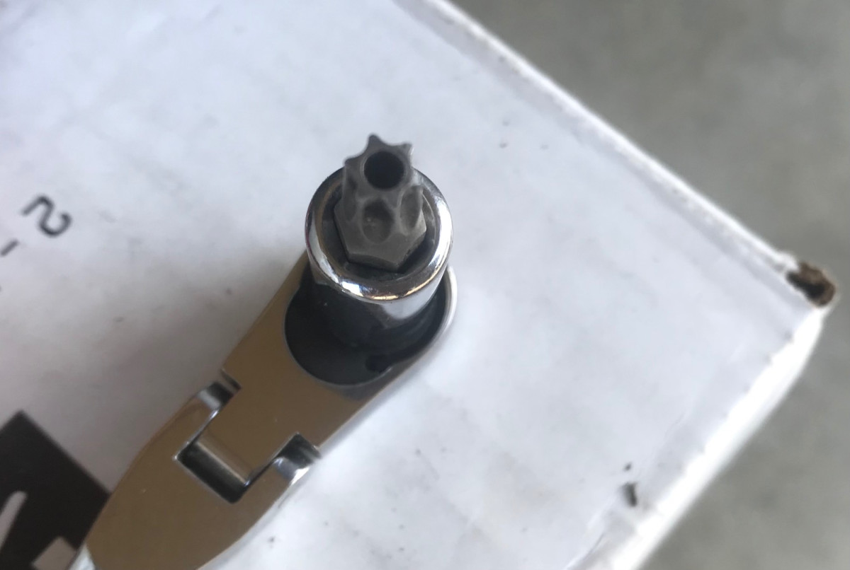

Long shot, does anybody know where I can get pdf or similar install instructions for these bars? I can tell that they need to be torqued to 6Nm, but beyond that I'm wondering about placement and any other "gotcha" pieces of information. There's no obvious Thule or Yakima branding on the inside of any parts. No lock cylinder either, although the T30 security bit with the pin/hole at the center was impediment enough.
Pro-tip. When you're trying to get the plastic cover off, turn the slotted fake keyhole 1/4 turn (90deg), not 1/2 turn.
Resolved: install is discussed in the manual. Pictures below. 6Nm is about 50in-lbs. Bars can go anywhere, but slide things farther back for less wind noise.
Resolved: Install instructions for Volvo "load bar" roof rack Topic is solved

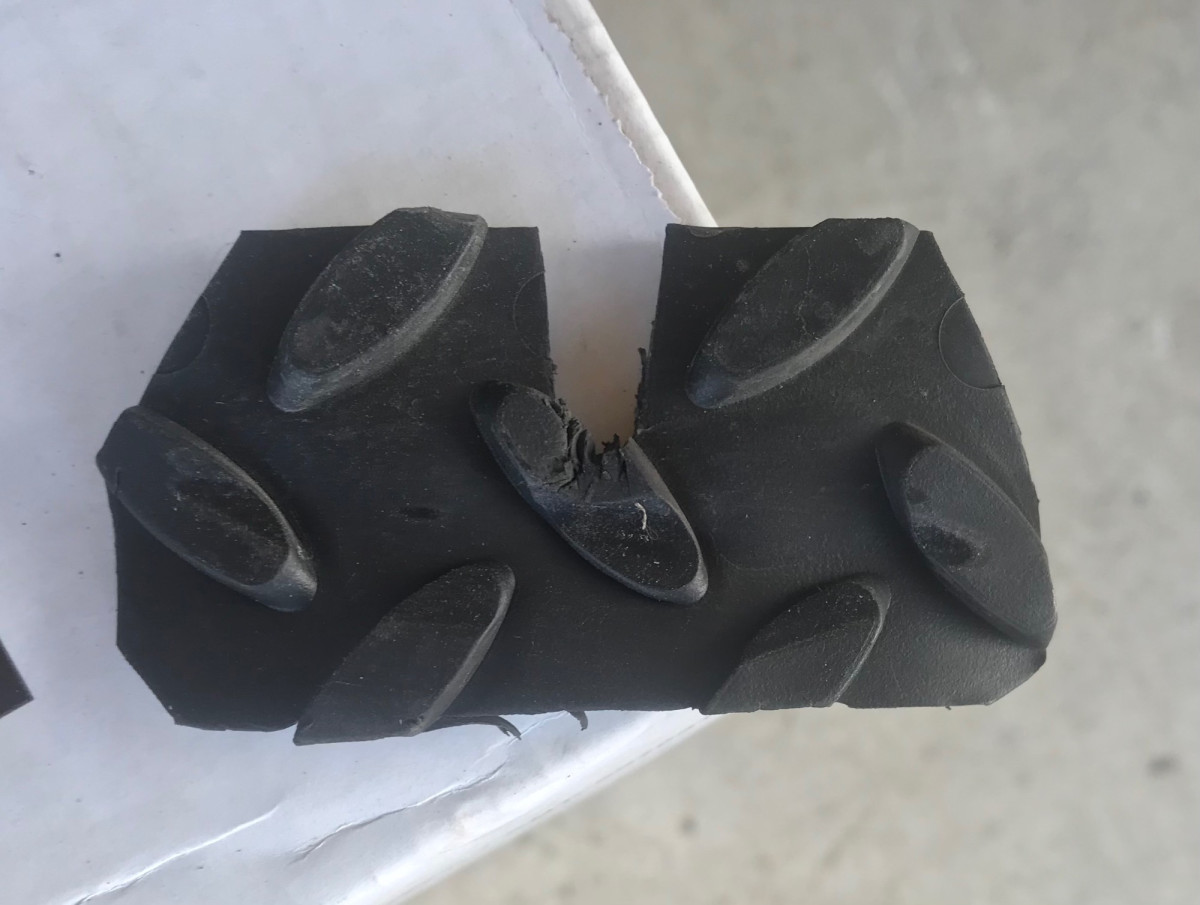

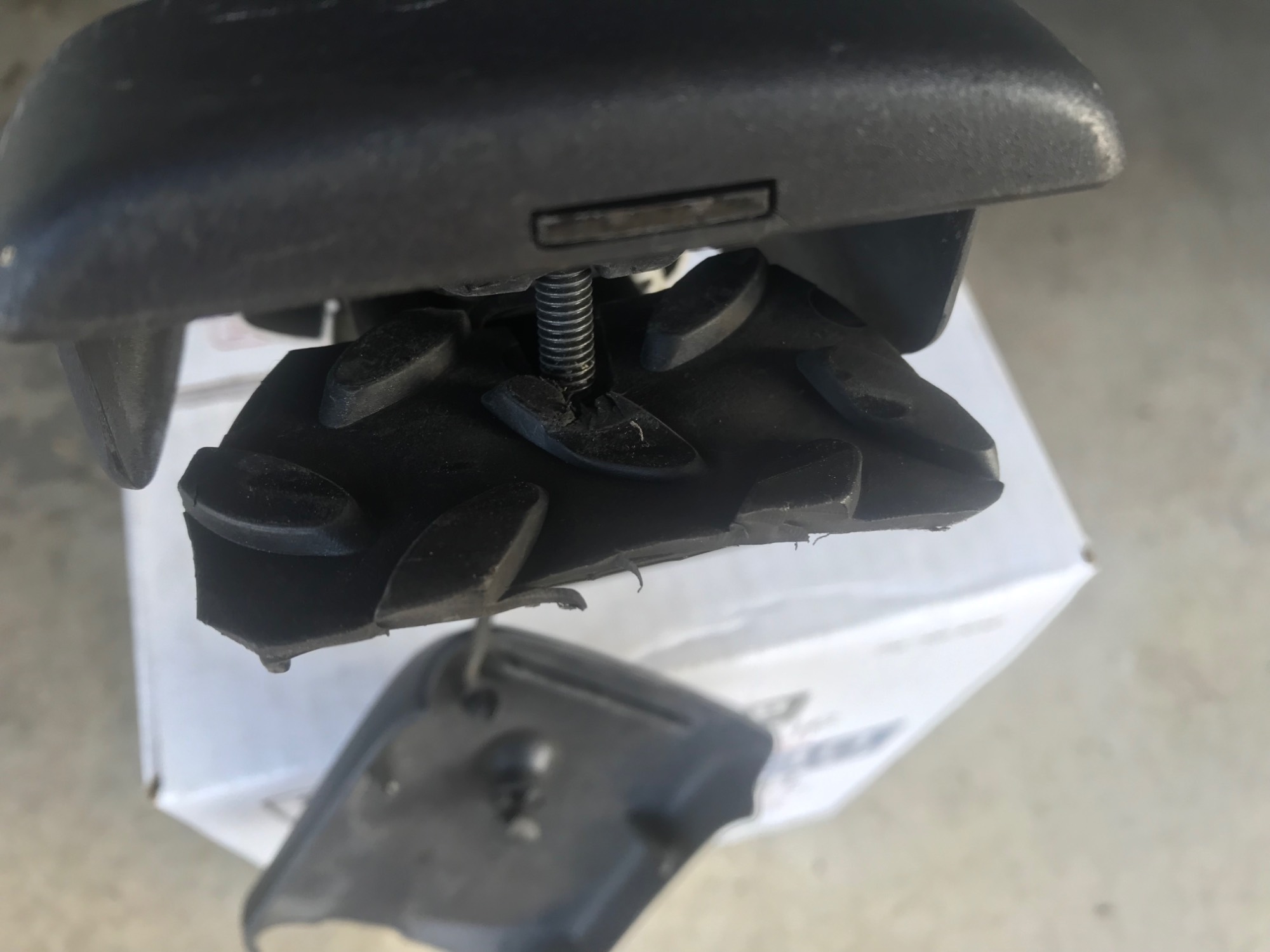

Hello,I have the same kind of roof rack but silver color from junkyard back in 2021 the rubber at upper clamp were rotten and falling apart,luckily I had some of rubber safety mat got it from HFT ,so I cut it to the shape of the upper clamp and it works great til now no problem, and to tighten the clamps I use the T30 Torx bit with security hole til the rack stop moving then stop ,a month later retighten the screws again.Hope it help..
