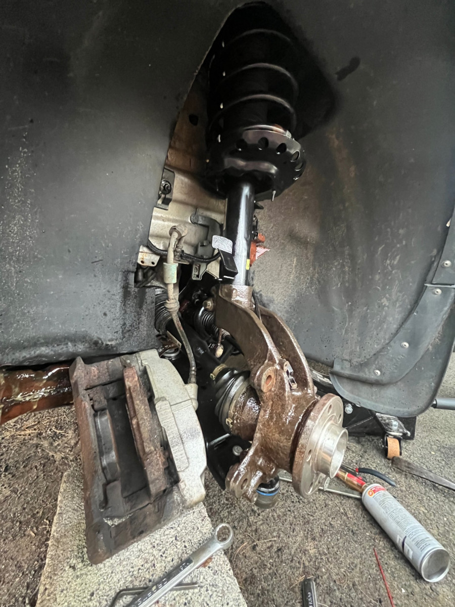

After 190k miles , the front suspension on my 2011 xc70 started making noises related to bumps in the road.
I used the very clearly documented procedure below to replace the struts
viewtopic.php?p=590388&hilit=xc70+strut+2011#p590388

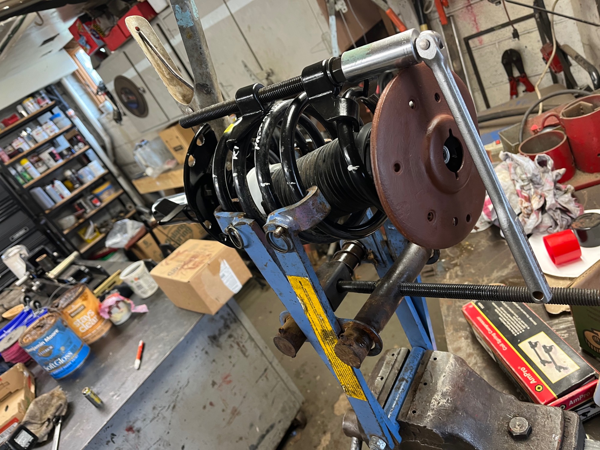

On disassembly, I inspected all the parts and perhaps foolishly only replaced to obviously bad parts:
-struts
- control arms
- rubber spring seat
- sway bar links
- sway bar bushings
I didn't replace these parts because visually and structurally they appeared in good condition:
- bump stops
- bellows
- strut mounts
- strut bearing
Sadly , after I got done there were similar but different knocking noises from the front suspension.

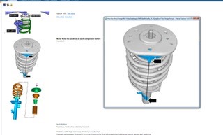

A helpful person on the Swedishbricks site sent me the Volvo document that explains the required alignment when replacing the struts on a P3 Volvo:
I removed the strut, did the required alignment , reinstalled and the tapping noise was gone !

Strut bearing would be my bet. Great photo on alignment procedure. Fcp euro has a detailed video on similar job but on xc60 in case you need reference. Sorry for your time. Hope it will reward you with another 190k of noise free miles.

My mechanic pointed out that the underside of the car seemed particularly rusty. While I had things apart , I did the electrolysis rust removal thing

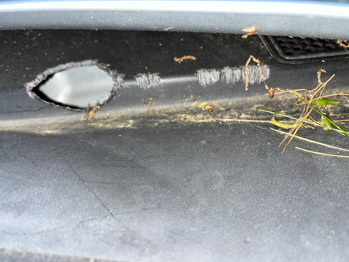

and got rid of the heavy scale of rust from the knuckle etc. But everything did seem unusually rusty underneath. I finally figured out the root cause: 3 years prior, a squirrel chewed a 3” hole in the plastic cowl under the windshield wipers. This hole channeled much of the rainwater and moisture from the roof and windshield down over the suspension, steering rack, catalytic converter etc etc . As soon as I realized the situation, I sealed up the hole. Even the stainless steel covering around the catalytic converter had some rust holes ( patched with woodstoves gasket cement).

Regarding the alignment of the P3 strut:
Thanks for posting it.
Is the blue thing a tool? The drawing is a bit fuzzy.
I suppose there's no link you could provide.
