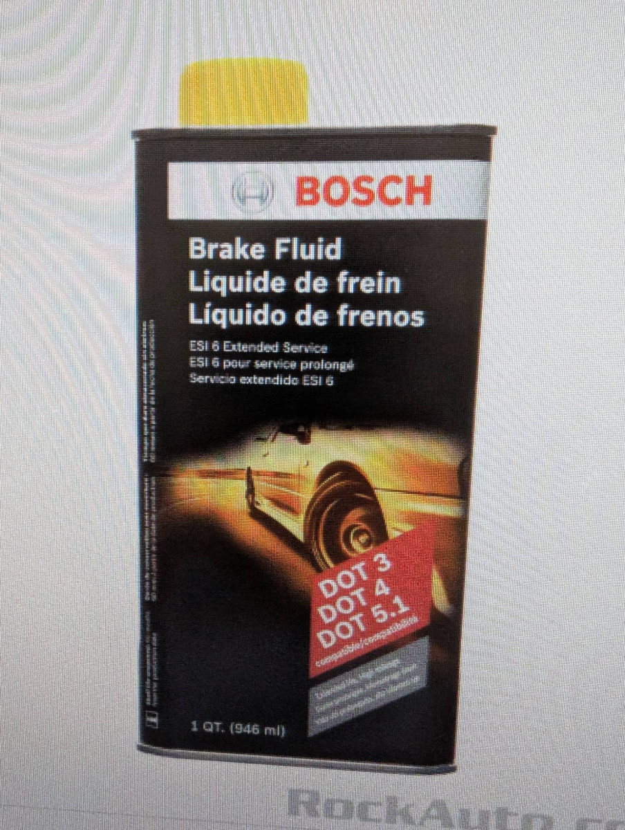

Now there is a newer fluid which in turn supersedes all of those and is compatible that Bosch supplies:
Bosch brake fluid
Bosch brake fluid
Strange thing is this is cheaper than Dot 5.1 from Rock Auto than I can buy Dot 5.1 locally!

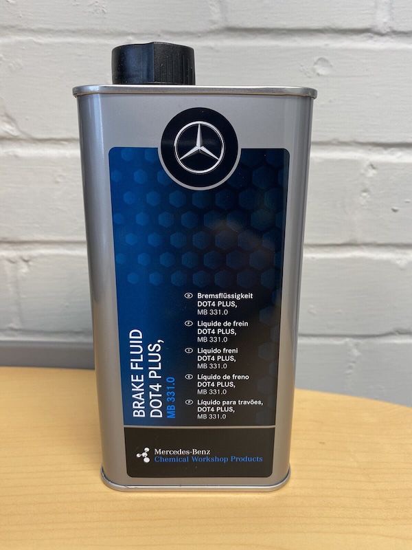

Dot4+ seems to be difficult to find now but after a lot of searching my local Mercedes Benz dealer stocks it by the pallet load...
The MB part# for anyone struggling to find DOT4+ is A000989560509 which supersedes part# A000989560511

Much appreciate your wise inputs guys! I think I'll try the new Bosch product as being a good Scot, price helps at $14/liter. 6 liters from Rock auto with shipping to Calgary is $105 CDN which is affordable!
