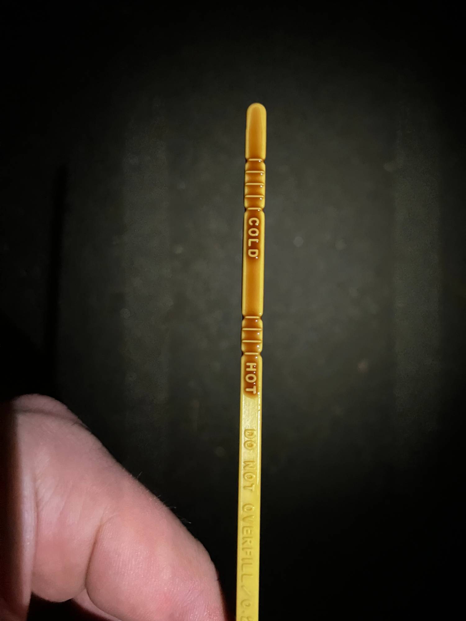

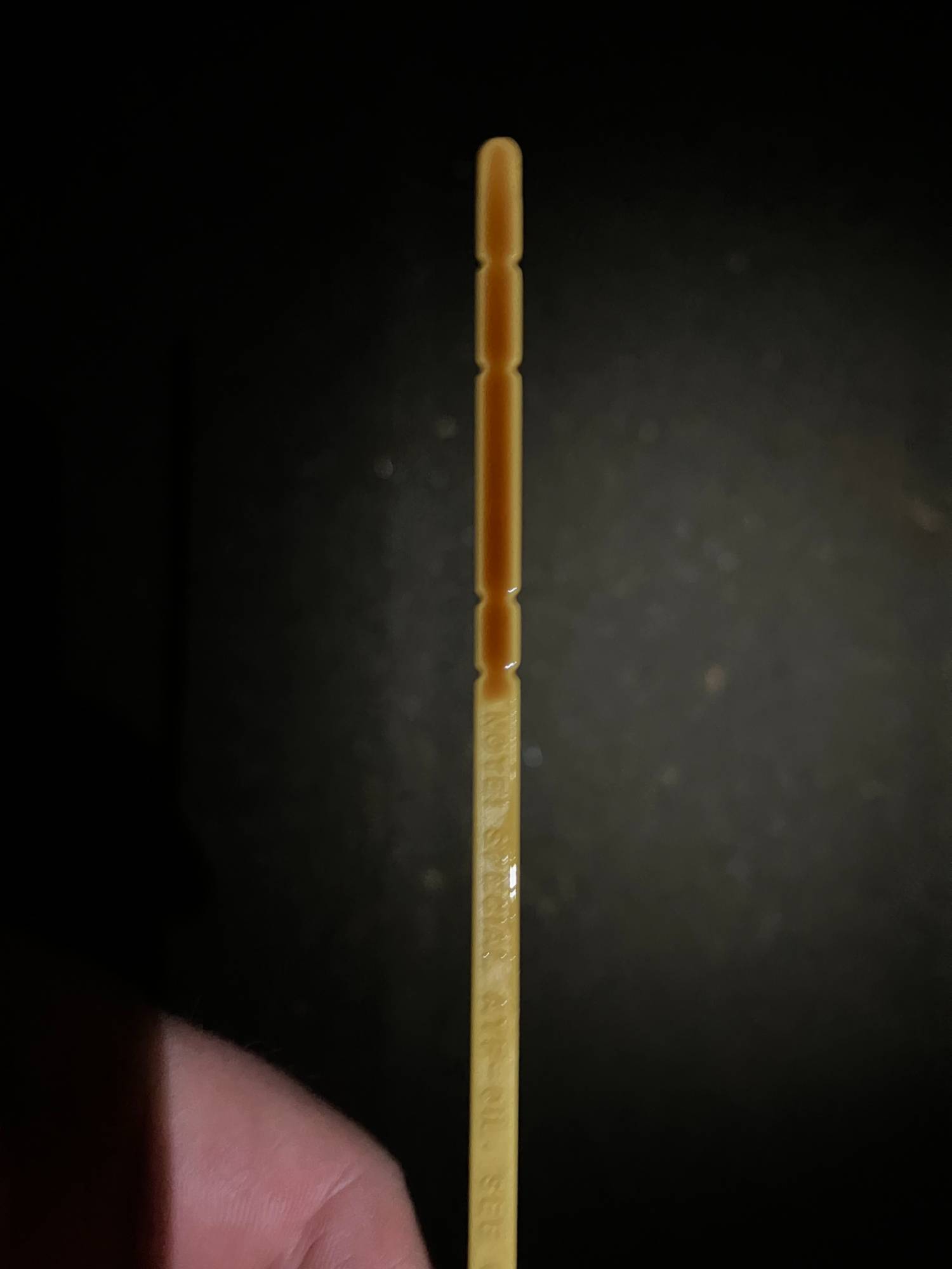

Little update here, lifted the front ever so slightly and checked oil level again because of my sagging suspension with negligible change. So I decided to drain some yesterday night and ended up removing about 1.5 cups of oil. Photos below are the resulting level after removing the fluid. Still a little high as you can see but much better. Now there is a clear decisive line too so no question where the cutoff is.
The only problem I'm having now is the level on the dipstick is different depending on the side you look at. More than likely this is due to the dipstick being submerged into the fluid at an angle. Therefor I believe the actual level is somewhere in between the levels on each side of the dipstick. Likely only half a cup more needs to be removed but I'll just wait until I do a full drain and fill to get the perfect level.

Checking both sides of the dipstick is important and I consider the lowest reading on the one side the more accurate read level because there's usually one side of the dipstick rubbing against the dipstick tube and smearing the fluid on that side. Looks like you're very close to a correct level now.cham wrote: 20 Apr 2025, 11:29 Little update here, lifted the front ever so slightly and checked oil level again because of my sagging suspension with negligible change. So I decided to drain some yesterday night and ended up removing about 1.5 cups of oil. Photos below are the resulting level after removing the fluid. Still a little high as you can see but much better. Now there is a clear decisive line too so no question where the cutoff is.
