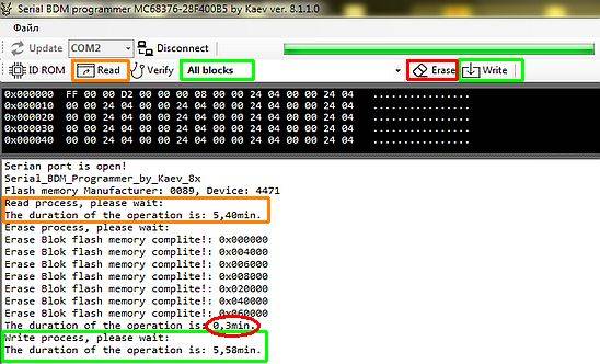

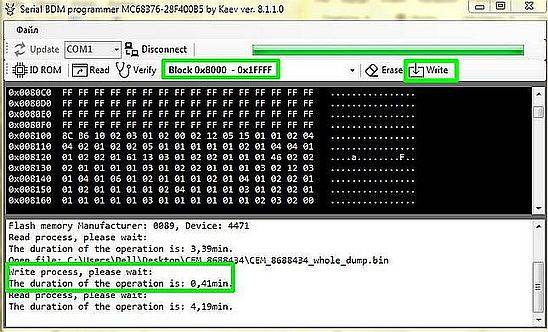

After many, many attempts, finally connection was established and I can confirm that
SerialBDM programmer works ! This program brought one of the dead CEM back to life after a failed writting
My observations:
1- You can erase / write specific blocks in flash memory as it shows below.
2- The whole CEM flash memory contents reading takes about 4 minutes, You can't read specific memory block
3- If Your flash memory dump has been obtained using T5Luke's program, then You have to flip bytes order in whole dump file
with 16 bit rule e.g. F2 32 E5 24 --> 32 F2 24 E5
4- Arduino needs to be powered with 5V ( to A4 pin) not necessarily from the CEM board. You can use extended 5V power supply
and apply a common ground (to GND pin)
Thanks to the author for sharing this tool for free...

5- SerialBDM programmer works with Arduino Uno as well
6- Whole CEM flash memory dump writing takes about 6 minutes
7- Most important - for the SerialBDM programmer to work properly you need to open the Arduino IDE,
upload the sketch to the Arduino memory and close the Arduino IDE, otherwise the programmer will not work.
