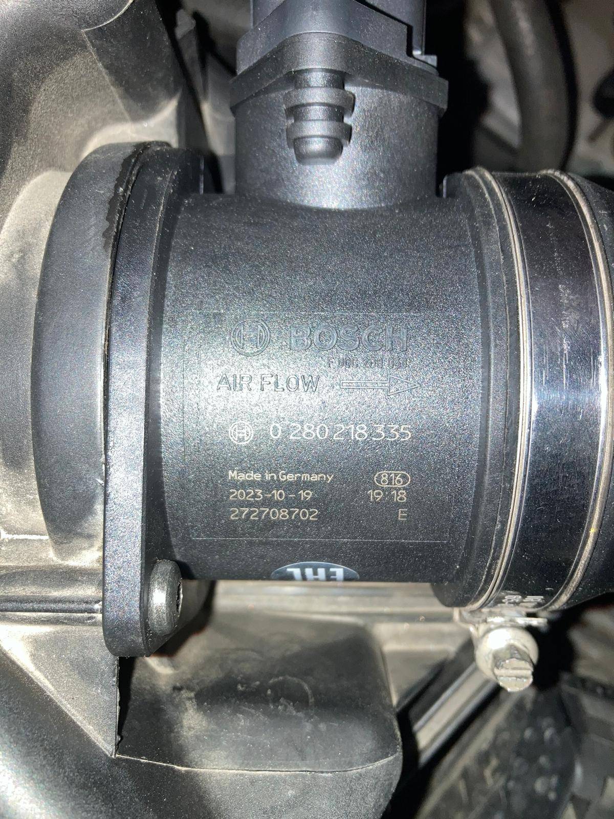

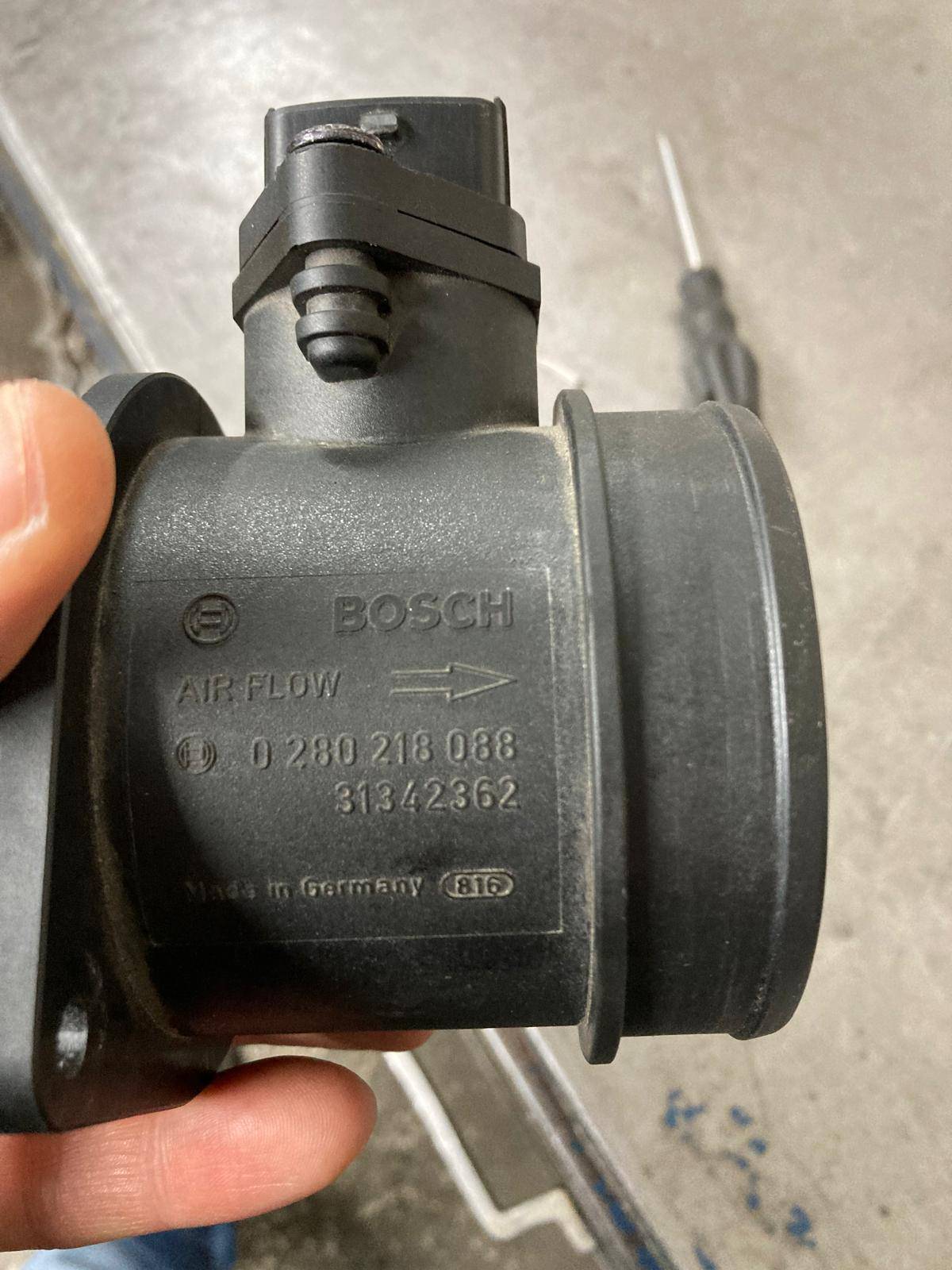

The last changed part in the vehicle;
Air flow meter (MAF sensor)
was changed in April last year.
Her complaint is; there was excessive idle fluctuation, it was very unstable. It was not stable and it was getting very high and it felt like it was going to stall. I connected the scanner tool and it gave a fault code. It was the maf sensor. I replaced it with a new one and it stopped and the vehicle returned to normal.
You can see the photo of the old and new parts below.

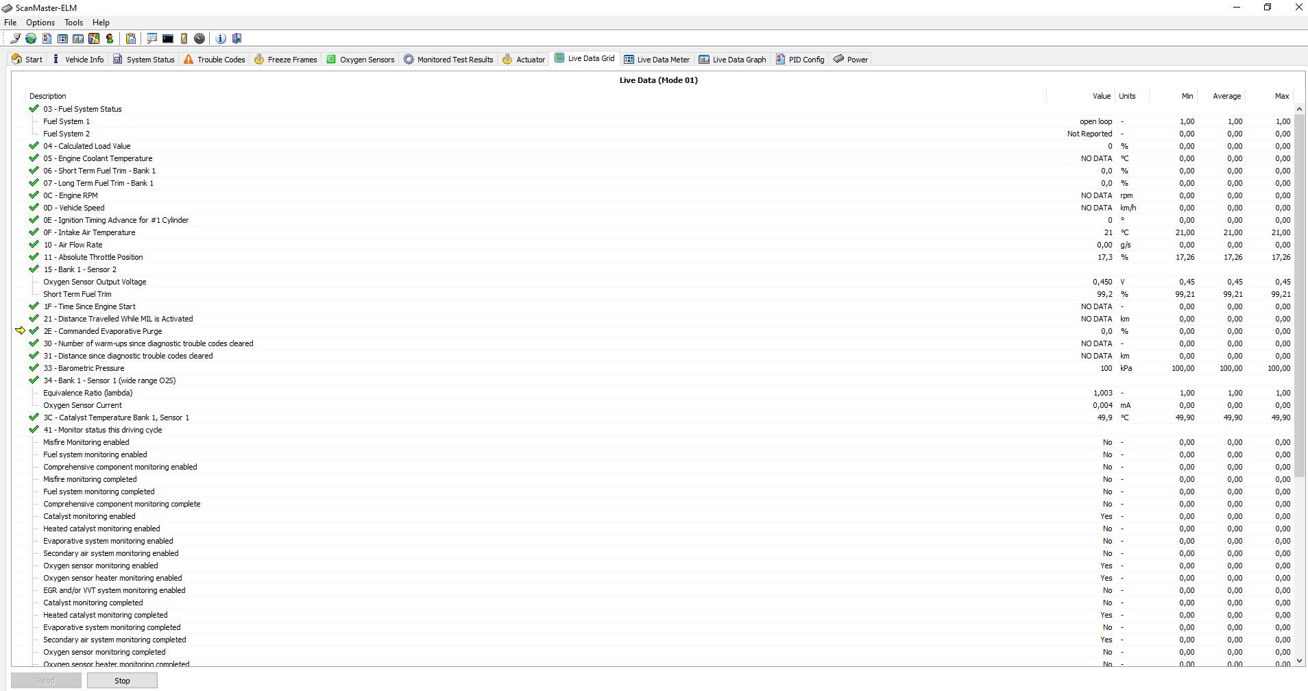

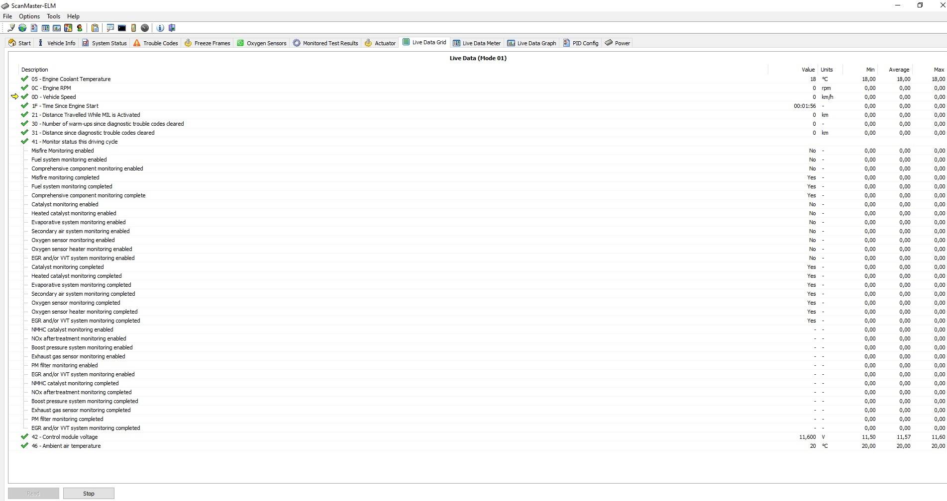

Scanner tool;
Yes I have a scanner tool. When the vehicle first started like this I connected it and it didn't give any fault codes.
It only gave a fault saying (ENGINE LOW PERFORMANCE) when trying to start it.
Low battery;
It gave many fault codes because of this. It gave warnings and errors such as ABS - brake system - anti-skid disabled.
I deleted these with the scanner tool. After checking the camshaft sensors and crankshaft position sensor, only the (Low Engine Performance) message appeared in our starting attempts. Other than that, no error or code appeared.
In the attached photos, I connected the vehicle to the scanner tool. I am sharing the information with you. I am grateful for your help.

Despite being concerning that tachometer is not
working i would try to see the engine rpms with your scan tool. Connect tool, find rpm value and try to start the engine. Hope you will see 200-350 value.
What was the pressure that you scanner tool showed? This sensor is known to fail and cause no start issues. But it would be best to diagnose rather than throwing parts.
https://www.fcpeuro.com/products/volvo- ... 0261230110
If all that is not working, you have 2 path. 1-buy vida/dice clone and with factory data meticulously check all inputs and try to fix it that way. Path 2- if able to afford mechanic who has scope it would be great. Good 2-4 channel scope will make all the difference when attached to pro mechanic.
I would try to do the 20cc oil into the cylinders and try to start it that way.
So the timming marks were checked and all correct?
