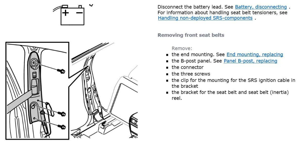

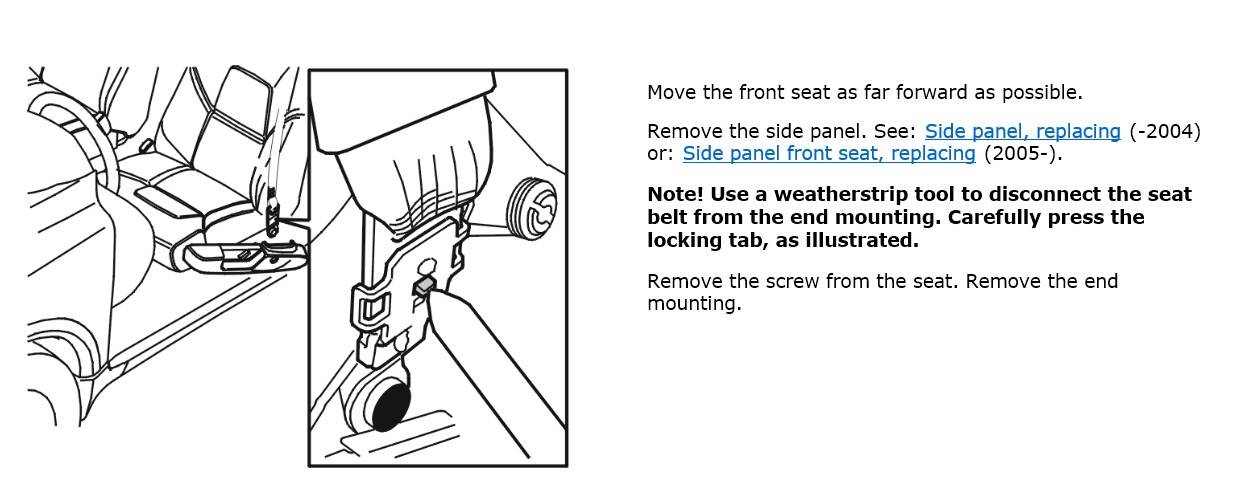

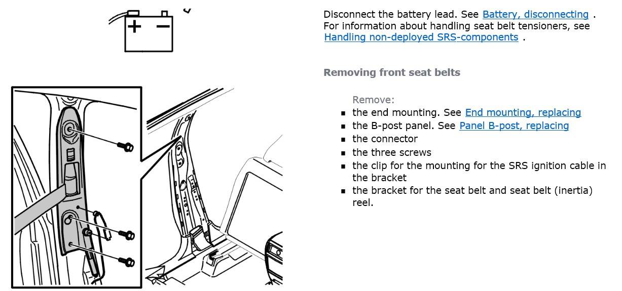

Seat Side-
Body Side-
Cover comes off with a Torx T15, if it's original you'll need to cut a tie-wrap on the seat. These break all the time, progressive flex crack as your butt slides onto and off the seat. Can see here for PNs if you need a replacement- https://www.volvocarslisleparts.com/a/V ... 37686.html
See the battery disconnect warning before messing with the belt on the vehicle side.
If this does not work for you, let me know.
