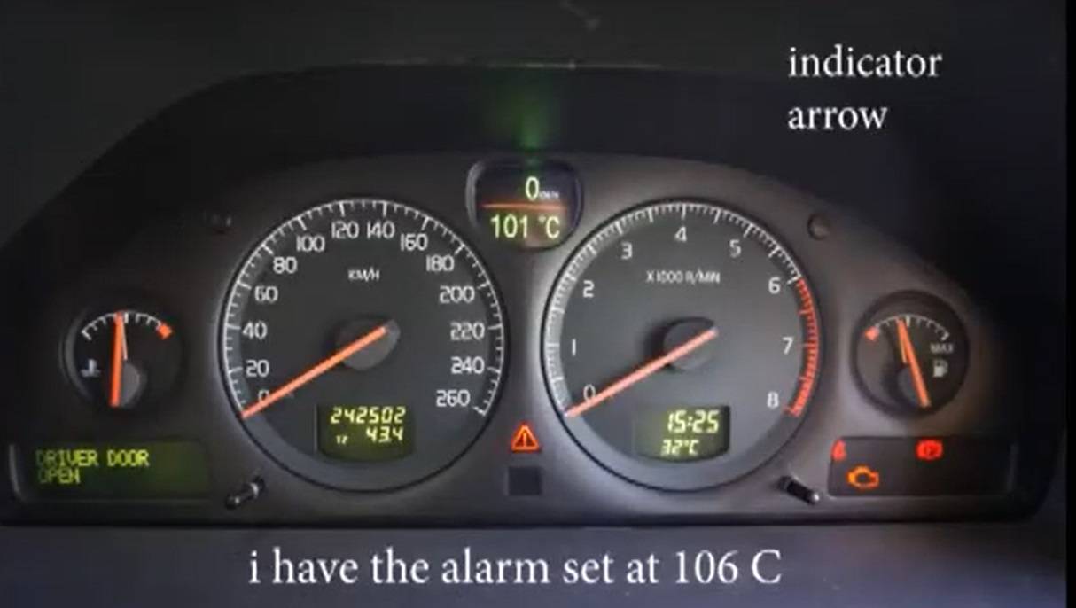

I did the heater core bypass a few summers ago. I will be restoring it to original when i get the chance. I can see if i can take pictures of it tomorrow oh and my car is stick. The amount of coolant going to the heater core is very little.
As for the engine fan, even on hot days mine hardly activates, ive had to check it in VIDA to confirm its still working.
I modified my cluster a few years ago with this OBD2 temp/speed TFT display that reads of the cars computer. the temp while driving sits around 90c but stop for any length of time and it goes up . i have the alarm set at 106c and have not had it activate even on 35c days
xc70 cluster mod
