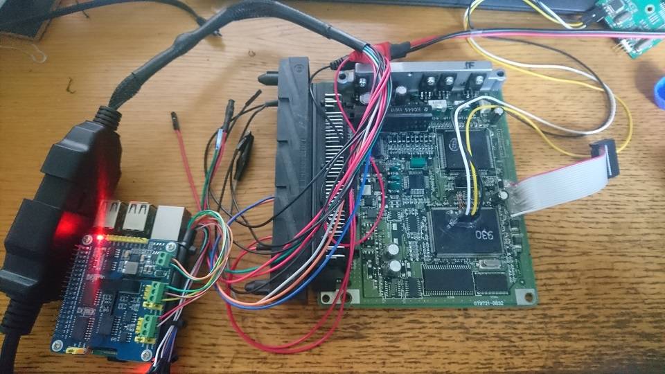

Then I started to think of what can be done. Wanted to be able to run some kind of debugger. JTag is not possible to use on this cpu, sh7055, so that was not a way to go. I noticed that Lauterbach had a rommonitor together with their eeprom simulator (i have one) but I was not in mood to replace the flash with an adapter. I then found out that they also had possibility to run over serial port. Some requirements is that it is needed to download the rom monitor code to target and get it running. There we had the dikidera tool.
Was able to get it down, but there was a lot of places where toggling the external watchdog pin is needed. Is there a solution that not require the toggling? That I don't know but I noticed that the pin have someting called Pulse on it. Found out that can be used to toggle the pin from hw timer. Was quite easy to do, only some registers needed to be set.

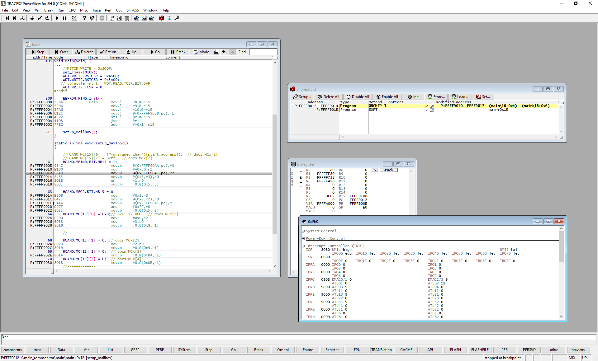

Next step was to get the rom monitor running with this. I have it up and running so far that I can load in code into ram from the Trace32 and run it, single step, set breakpoints, look at variables etc.
It is also possible to execute code that is in flash. Only drawback is that I can only set one breakpoint. The limit is that User Break Controller inside the cpu only have one.
I have still not added the rommonitor to the flash image. It is possible to do. It is also needed to change some of the vectors in the interrupt vector table so rom monitor code can take control of cpu when it is running. Just now I create a new in ram and point on that.
Noticed now that I don't have any source in that picture, just assembler. There is no problem to have source debugging if you have a debug file. If building small parts of own code you have and can do source level debugging on that parts.
Only one serial port is needed, rx, tx and ground. In picture I have also added a connector to the AUD port.
Do anyone know if any of the 4 serial ports is accessible on in the big connector? Just now I have soldered them directly on the cpu pins.

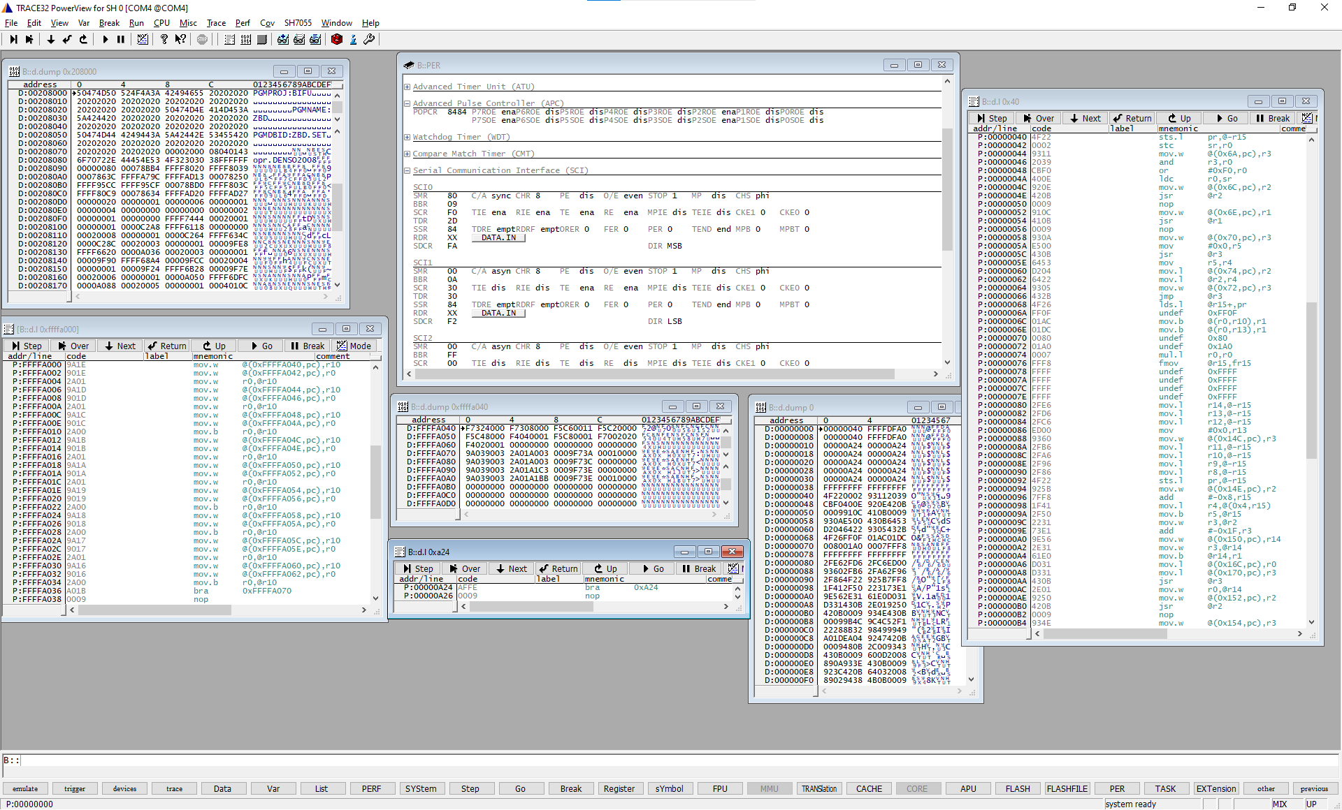

You are correct that the UBC can handle masks. Lauterbach have support for it as well. If you set a range breakpoint it calculates the mask/address needed to cover the range you specified and configure UBC.
If then execution hits the mask range, but not within breakpoint range it just starts execution again. It will be a "short" time when user code is not executing but mostly when running with a debugger that doesn't matter.
See this example. I have setup a range from 9010--9017. In the code window we see a small read dotted bar between 900e--9016. That is the mask range that the UBC breakpoint covers.
I also have one more breakpoint, 901E. Now I'm executing from RAM so it can set that as a soft breakpoint (eg change the instruction to brk)
Here I also have a mixed view in source window e.g. show both my source and the asm code that it belongs to.
