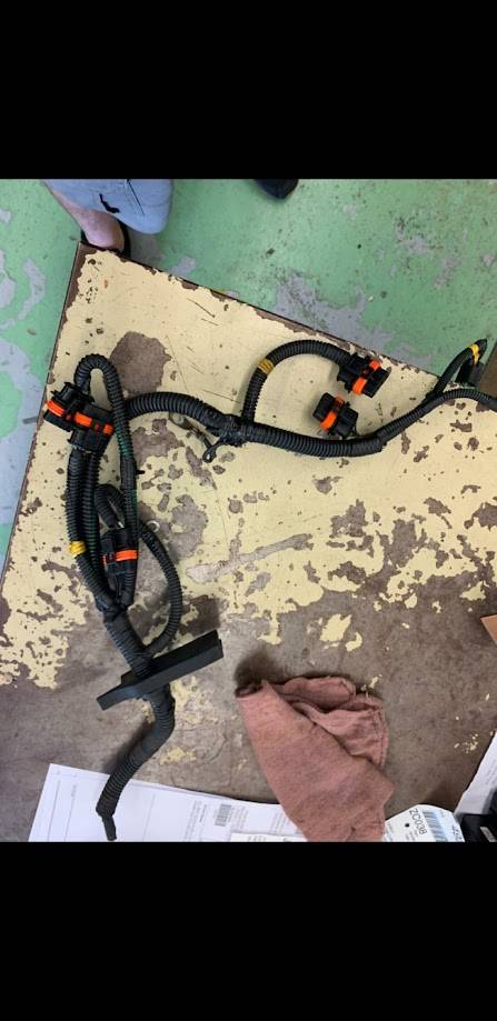

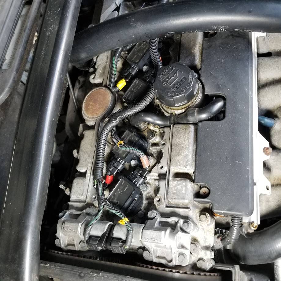

I replaced the IGN coil harness 3 years ago. The heat under that valve cover caused the pigtail connectors and wire loom to get fragile. I had all the pigtails zip tied to the IGN coils before I replaced the harness. Instead of risk it with a new aftermarket harness I got a used harness from ERIE Volvo. No issues since installing it.
With the coils over 15 years old I threw on 5 new Volvo IGN coils I got at FCPEURO. Also traded in the 5 Volvo lifetime warrantied spark plugs.
I've kept the valve cover off since then so the heat can escape.
