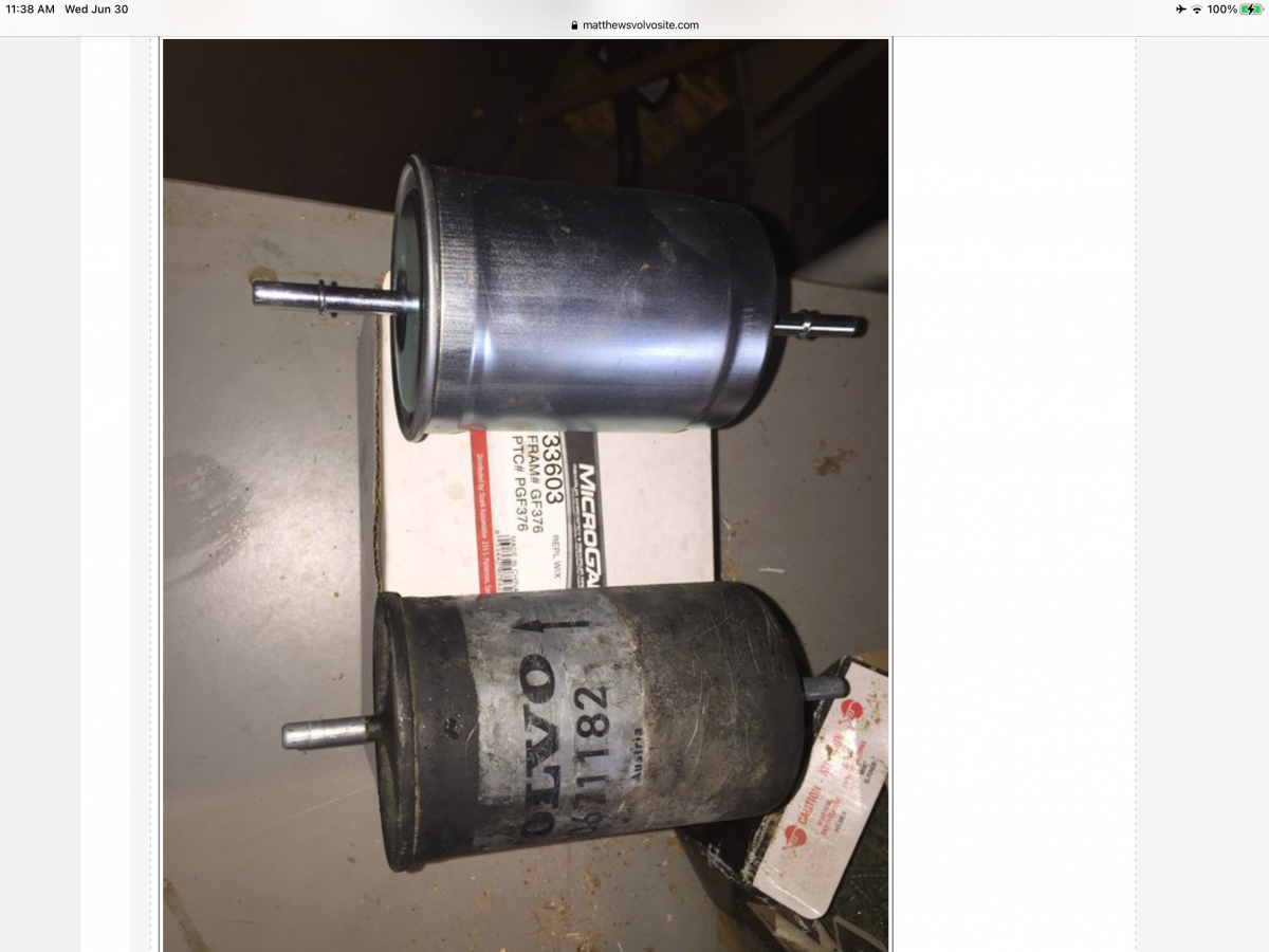

The difference in these two fuel filter snouts is important. The Dorman part will lock onto the flange on the top one but not on the bottom one which is OE
